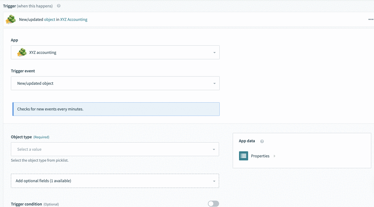

Defining config fields ​
When dealing with object-based triggers, we first need to define something called a configuration fields. Configuration fields are special input fields that you can define whose answers can dynamically generate other input fields. Since triggers don't often need any additional input fields, this configuration field is used to dynamically generate the expected output of this trigger.
ruby
config_fields: [
    optional: false,
    label: 'Object type',
    control_type: 'select',
    pick_list: 'object_list_new_updated_trigger',
    hint: 'Select the object type from picklist.'
Config fieldsSelecting invoice causes invoice related data-pills to appear

Over here we define title and subtitles to give users an idea of the action out of all the different actions in your connector. Remember to keep your title concise whilst using subtitles to provide a bit more information.
For descriptions, we allow you to use a lambda function (as shown in the example above) to dynamically change the description of the action when a user makes a selection in the config_field. The same can be done for help text as shown in the example above.

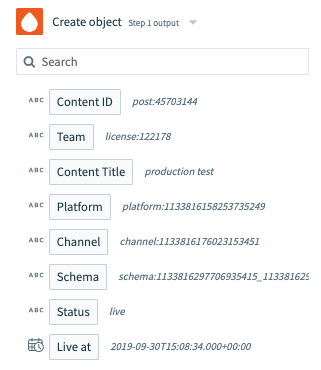

Defining your sample output ​
Sample outputs are a great way to hint to give users context about the data-pills they are mapping in downstream actions. When labels might still leave room for confusion, sample outputs bridge the gap in understanding by allowing you to pull data in real time from the user's own application. In the example below, we construct a payload artificially before using a search object method to retrieve the first record found in the user's own instance of XYZ accounting.
Sample output ​
ruby
sample_output: lambda do |connection, input|
  payload = {
    "limit" => 1
  call("search_#{input['object']}_execute", payload)
end
The output of this block is then passed to the output fields block and rendered to the right of every data-pill which is matched. This could significantly reduce the amount of time it takes for users whilst troubleshooting.
Good example of dynamic descriptionsSample output renders in grey text next to each data-pill
