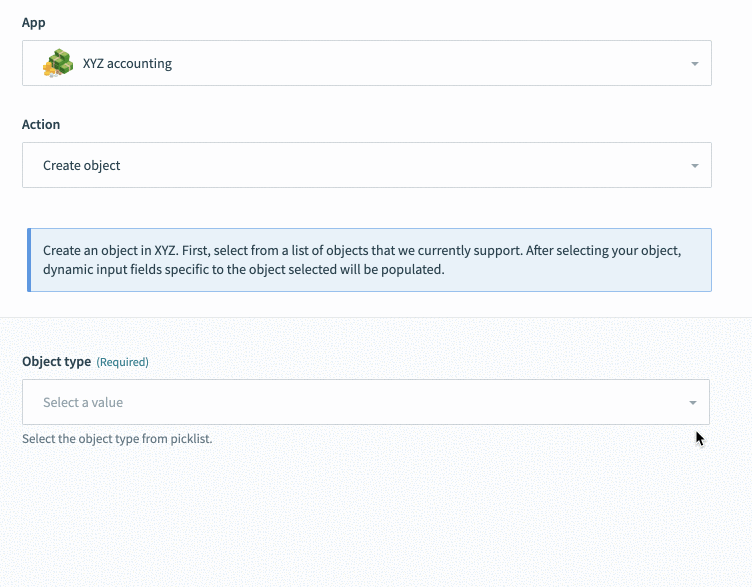

Here we also introduce a picklist which we can easily add additional objects as we introduce support for them.
DYNAMIC INPUT FIELDS
You can also use configuration fields to dynamically generate input fields based on the user's selections. Refer to the Defining input fields section for scenarios where the selected object requires additional information before accurate input fields can be displayed.

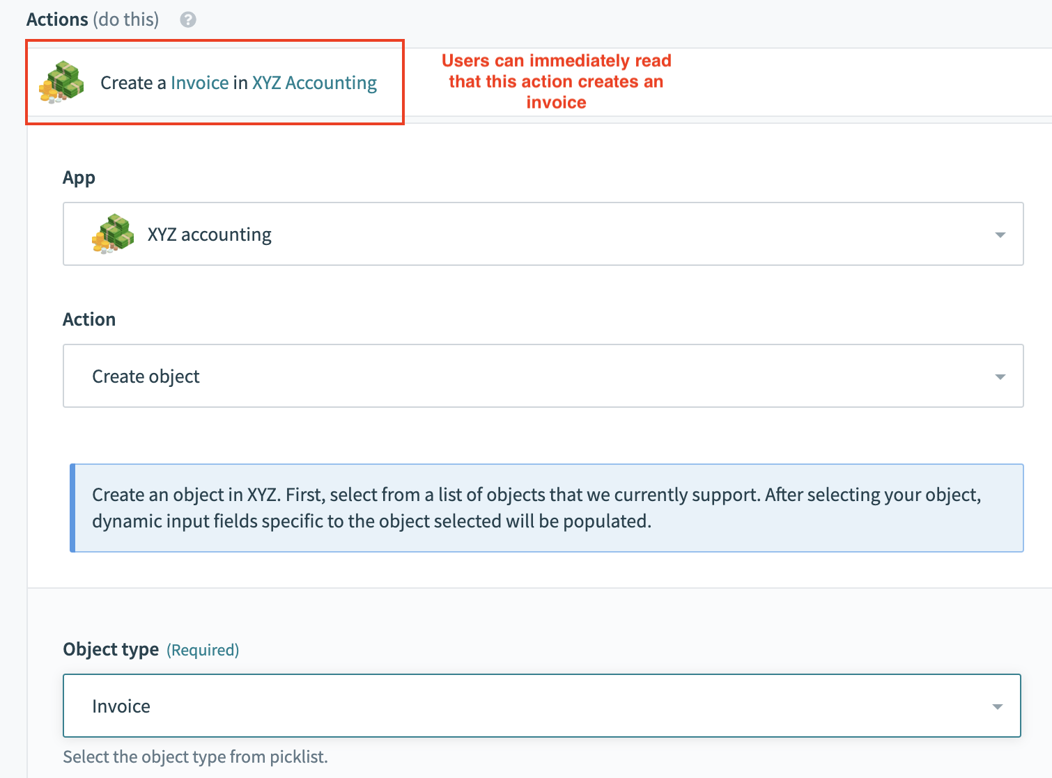

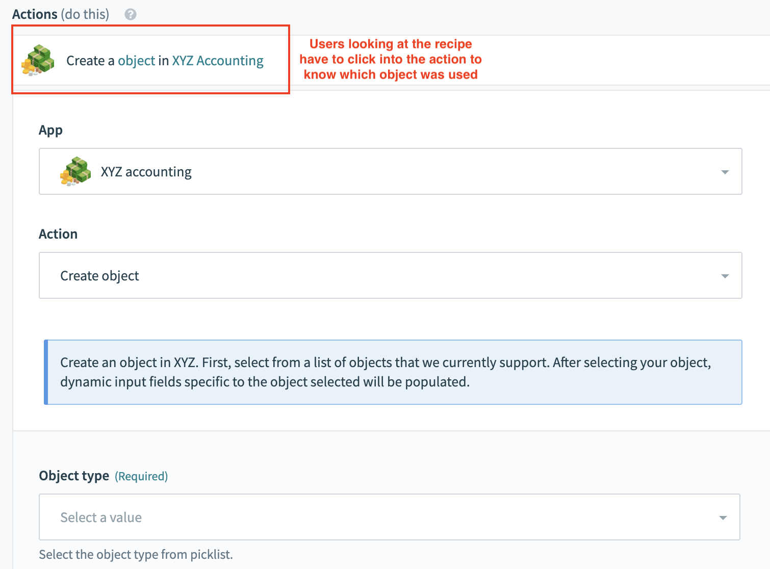

Over here we define title and subtitles to give users an idea of the action out of all the different actions in your connector. Remember to keep your title concise whilst using subtitles to provide a bit more information.
For descriptions, we allow you to use a lambda function (as shown in the example above) to dynamically change the description of the action when a user makes a selection in the config_field. The same can be done for help text as shown in the example above.
Bad example of dynamic descriptionsBad example with no dynamic description
Good example of dynamic descriptionsGood example with dynamic description
