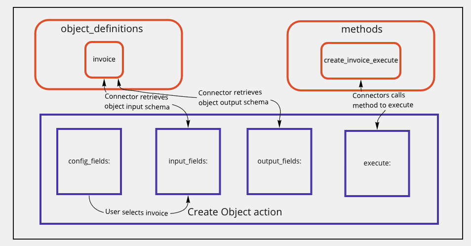

Before going into specifics, here is a high-level overview of connector code could be organized.
Mindmap of connector code
Our main objective is to allow users of the connector to allow them to first select from a series of actions or triggers like:
  1. New/updated object
  2. New object
  3. Create object
  4. Update object
  5. Search objects
  6. Delete object
This would be followed by the user selecting the object in the action or trigger configuration. After the user selects the object, the connector should fetch and display the input and output fields relevant to the object selected. This is by calling the appropriate object_definition based on the user's input to your config_fields. The user's input to your config_field can be found in the arguments passed to the input_fields lambda function.
For the execute block, we advise using a single method dedicated for each verb-object pair. This helps to ensure that any pre-processing of input data and post-processing of response data specific to that verb-object action can have a dedicated section in your code. Any general data formatting such as after_error_response or after_response methods can be contained directly in the execute block.
Ultimately, this helps to separate the responsibilities of each verb action and the objects it can support, allowing you to add support for new objects quickly or verb actions for existing objects.
