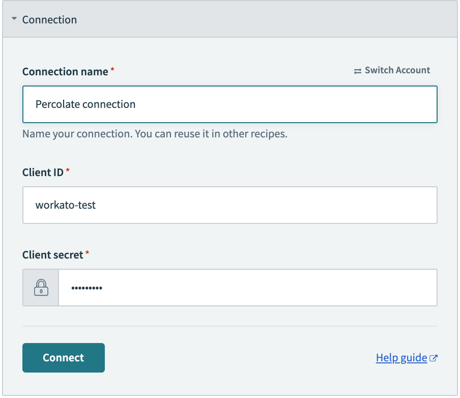

Step 1 - Defining Connection fields ​
This component tells Workato what fields to show to a user trying to establish a connection. In the case of Client Credentials Authentication, you would need the Client ID and Client Secret that the user has generated in Percolate.
Information neededDescription
Client IDThis is the public ID of the OAuth app that should be tied to Workato. This might mean signing Workato up as a verified application in the application
Client secretThis is the matching private key that the API will verify along with the Client ID. This might mean signing Workato up as a verified application in the application. Don't share your client secret with others
This is done in the fields key, which accepts an array of hashes. Each hash in this array corresponds to a separate input field.
ruby
    fields: [
        optional: false,
        control_type: 'password',
        optional: false,
Configured Percolate connection fields
TIP
When defining fields, you need to at least provide the name key. Additional attributes like optional, hint and control_type allow you to customize other aspects of these fields. For sensitive information like Client Secrets, remember to use the control_type as password.
Refer to Connection fields for more information on defining input fields in Workato.
