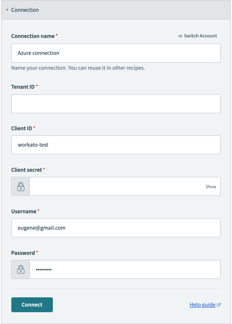

Step 1 - Defining Connection fields ​
This component tells Workato what fields to show to a user trying to establish a connection. In the case of resource owner password credentials, you would need the Client ID and Client Secret that the user has generated in Azure. You will also need to provide the Username and Password of the user account that you will be using to authorize the connection.
Information neededDescription
Client IDThis is the public ID of the OAuth app that should be tied to Workato. This might mean signing Workato up as a verified application in the application
Client secretThis is the matching private key that the API will verify along with the Client ID. This might mean signing Workato up as a verified application in the application. Don't share your client secret with others
UsernameThis is the username of the user account that is giving permission to authenticate the client.
PasswordThis is the password of the user account that is giving permission to authenticate the client.
This is done in the fields key, which accepts an array of hashes. Each hash in this array corresponds to a separate input field.

Configured Azure connection fields
