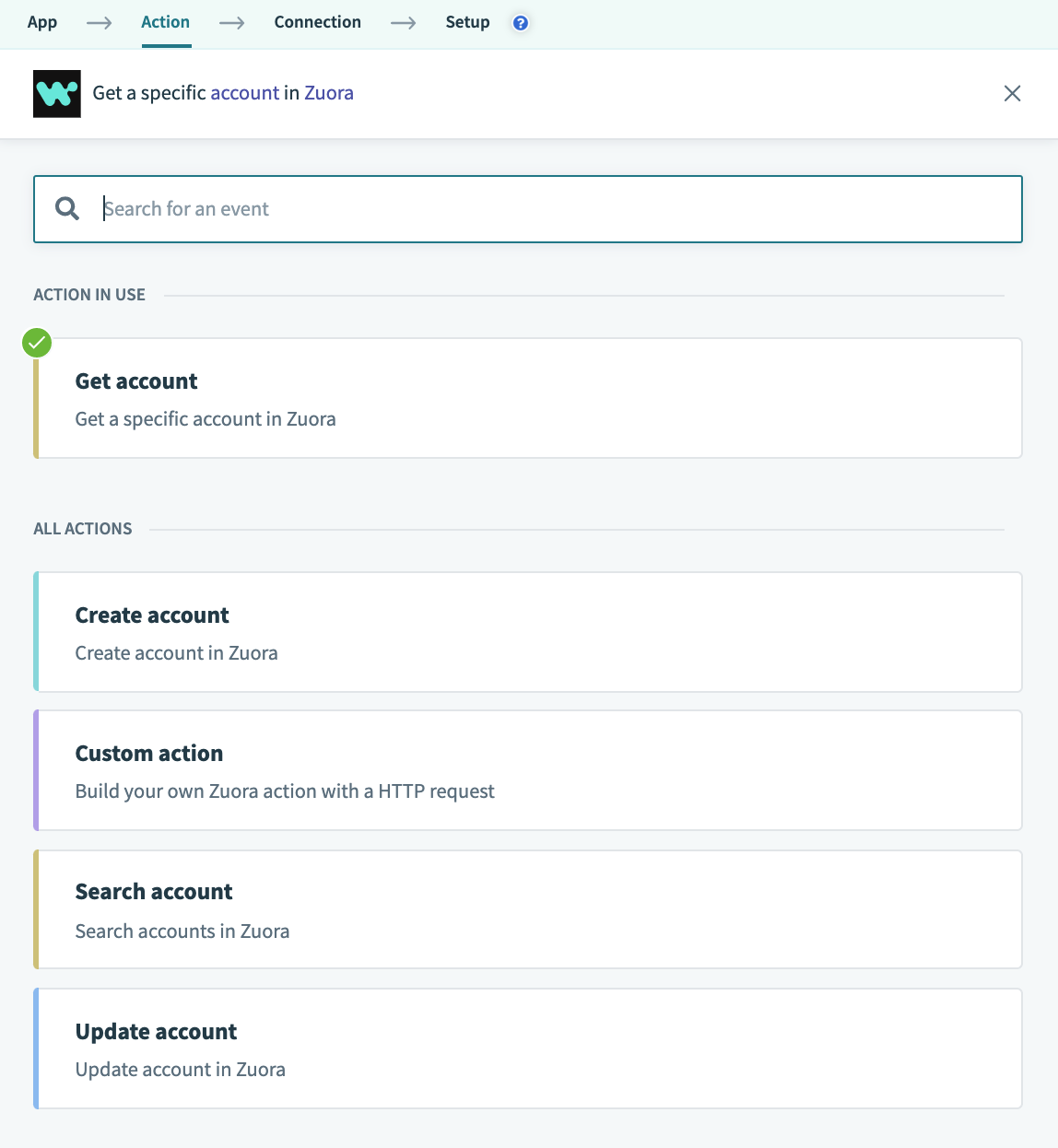

Selecting the get account actionSelecting the get account action
Step 1 - Action title, subtitle, description, and help
The first step to making a good action is to properly communicate what the actions does, how it does it and to provide additional help to users. To do so, Workato allows you to define the title, description, and provide hints for an action. Quite simply, the title is the title of an action and the subtitle provides further details of the action. The description of the action then contains specifications and explanation on what the action accomplishes and in the context of the application it connects to. Finally, the help segment provides users any additional information required to make the action work.

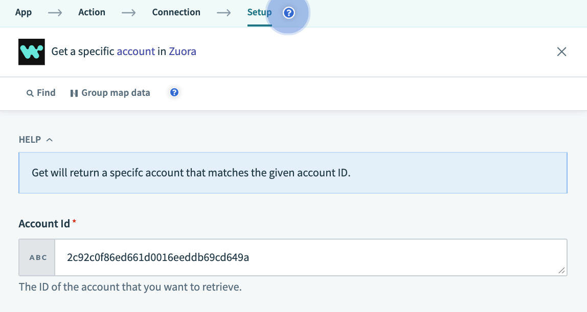

Get account input fieldsGet account input fields
This component tells Workato what fields to show to a user trying to retrieve an object. In the case of retrieving an account in Zuora for example, the user has to input the ID of the account to be retrieved.

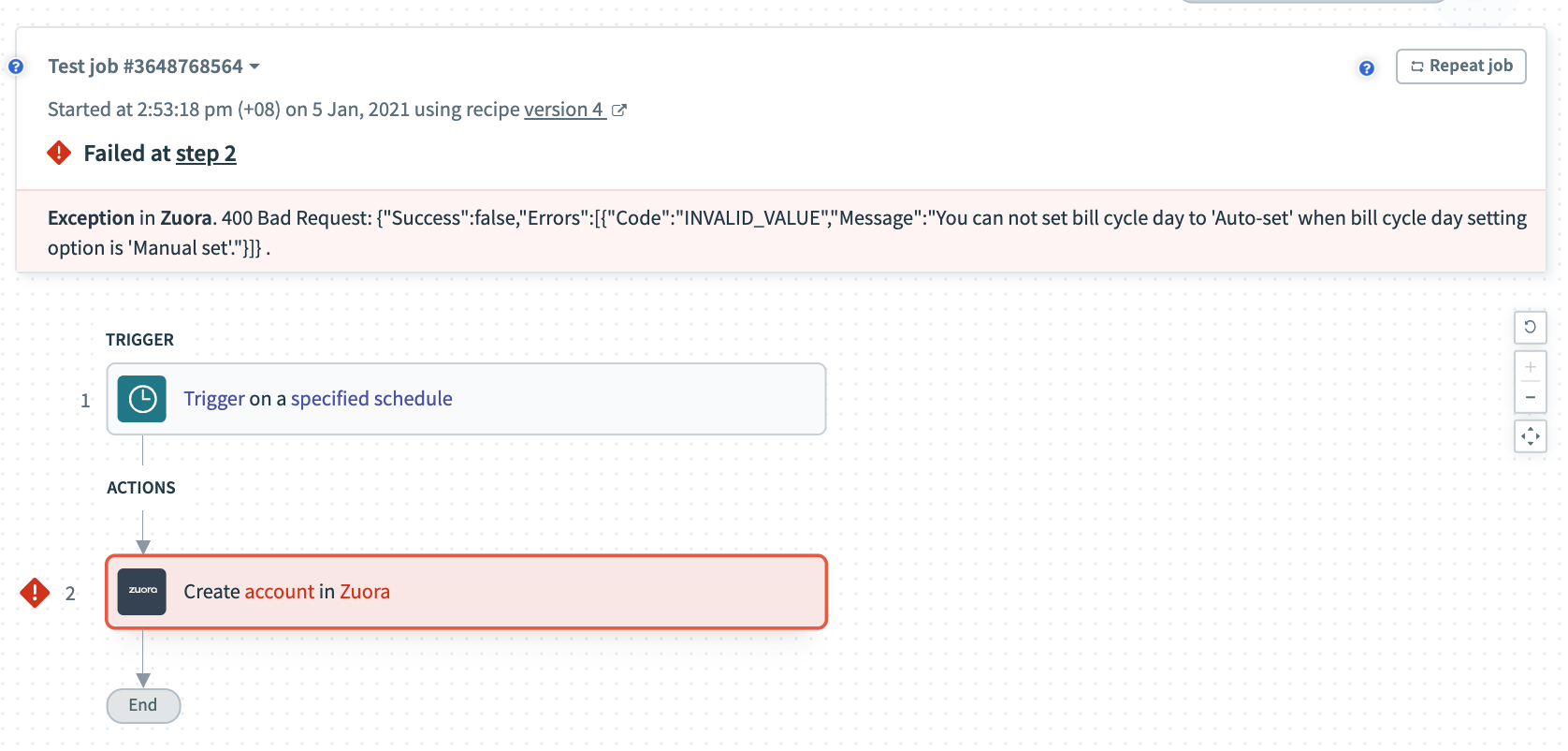

Get account errorError example
To know more about the execute key, take a look at our SDK reference

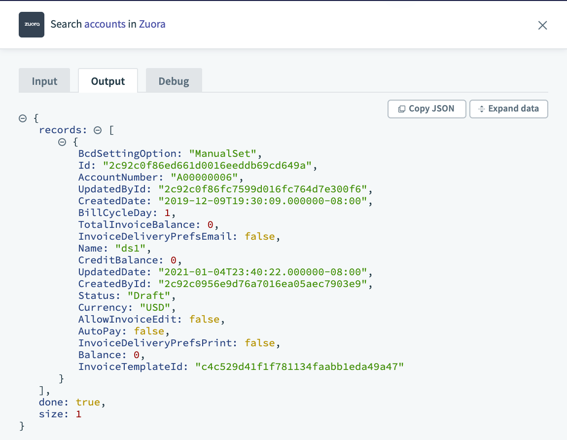

Get account output fieldsGet account output fields
To know more about the output fields key, take a look at our SDK reference
