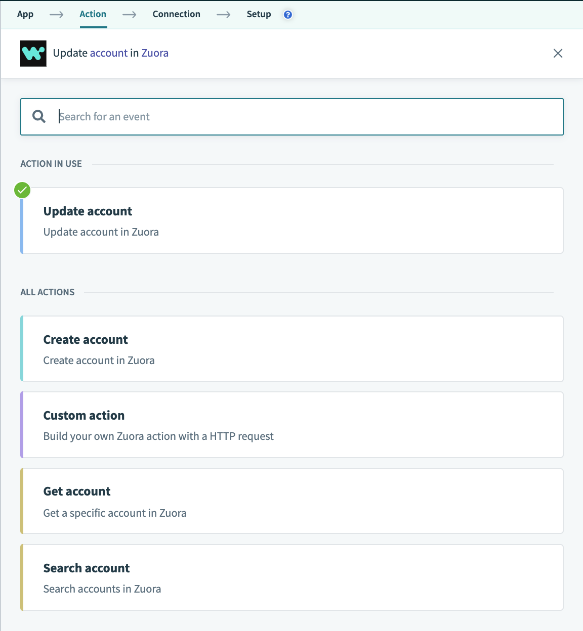

Selecting the update account actionSelecting the update account action

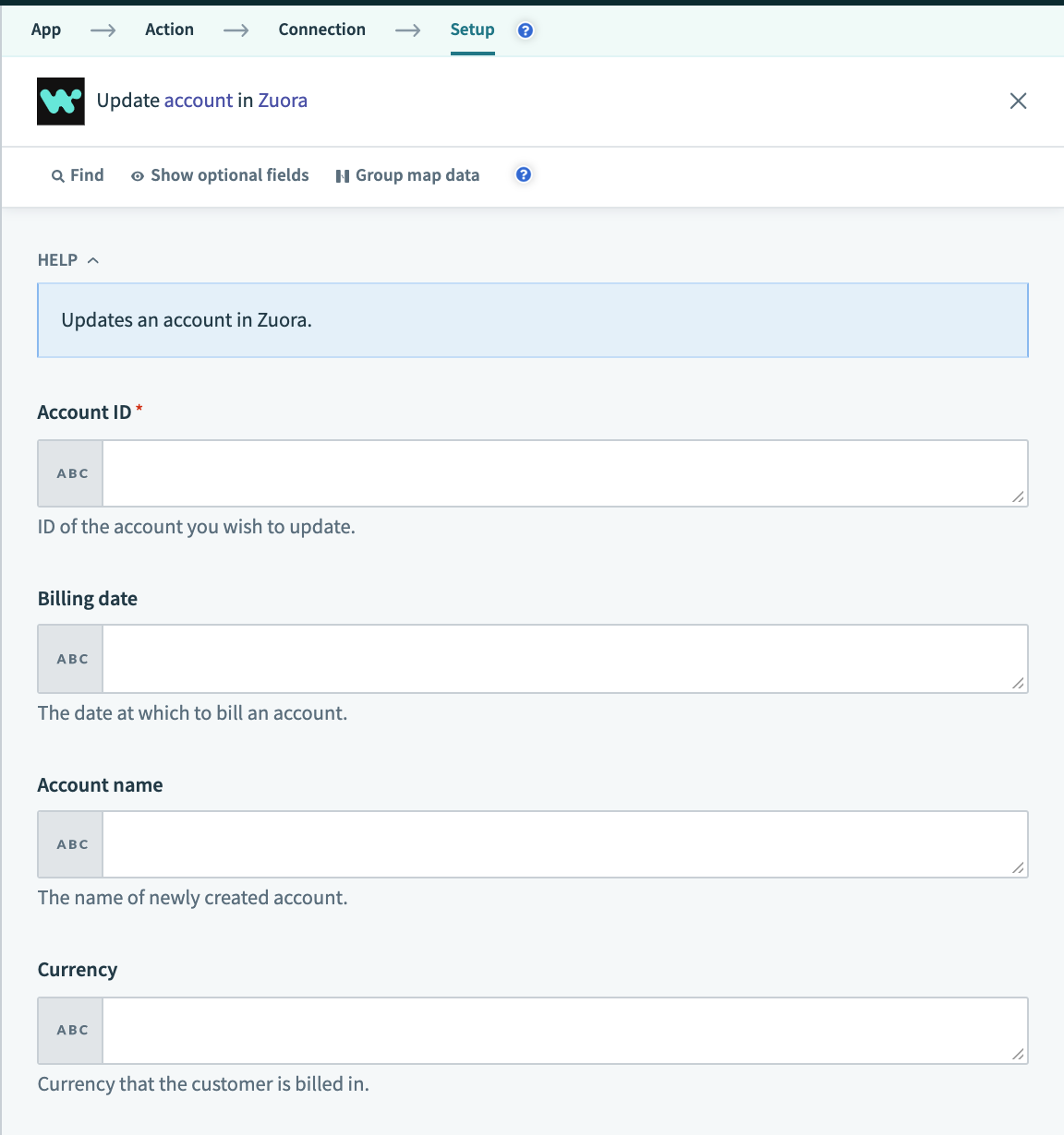

Update account input fieldsUpdate account input fields
This component tells Workato what fields to show to a user trying to update an object. In the case of updating an account in Zuora for example, the user has to input the id, BillingDate, AccountName and Currency of the existing account to be updated.

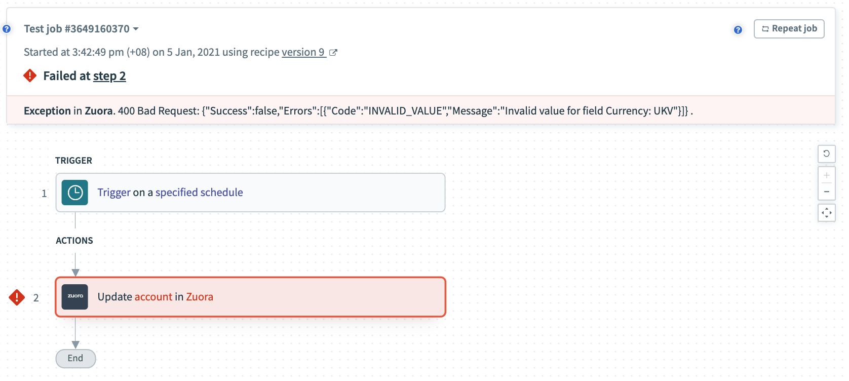

The execute key tells Workato the endpoint to send the request to and using which HTTP request method. In this example, we send our request to https://rest.zuora.com/v1/object/account using the PUT method. We also append the after_error_response method to the request to catch any errors and to display them to users to aid in the debugging during recipe building.

Update account errorError example

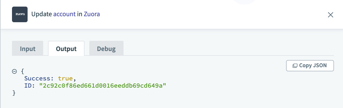

Update account output fieldsUpdate account output fields
To know more about the output fields key, take a look at our SDK reference
