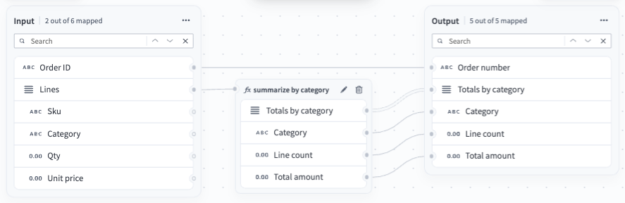

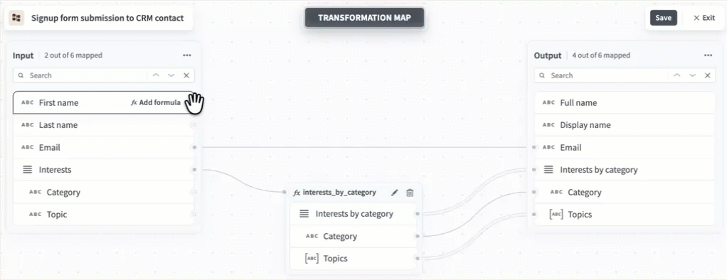

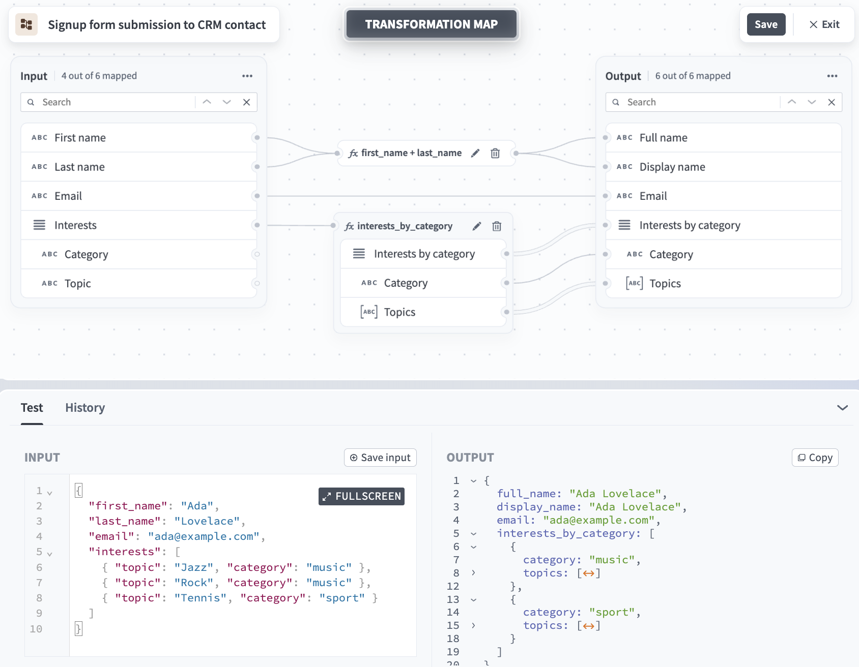

Transformation maps are project assets that centralize the logic for shaping and mapping data between systems, work otherwise split across recipe steps, formula mode, and custom code. You can test the mapping end-to-end directly in the editor before you save it, and reuse the same logic across multiple recipes.
Use Workato Expression Language (WEL) formula nodes to transform data, or map an input directly to an output to pass the data unchanged.
