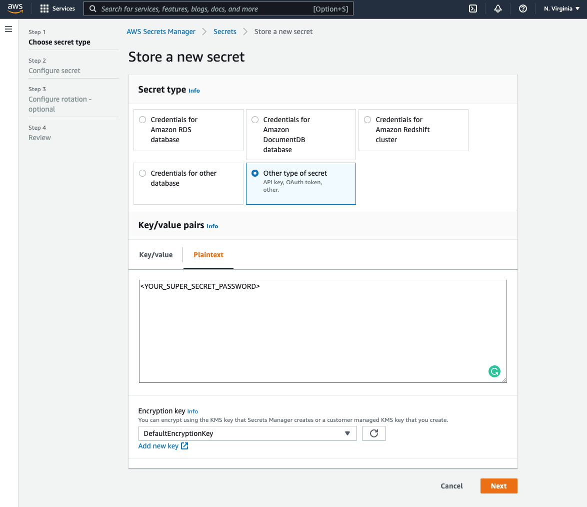

On the Step 1 - Choose secret type page:
In the Secret type section, click Other type of secret.
In the Key/value pairs section, click the Plaintext option.
In the Plaintext field, enter the password. OPA will retrieve this value and pass it as-is.
Your configuration should look like the following:
Configured Secret Type page in AWS Secrets Manager
Click Next.

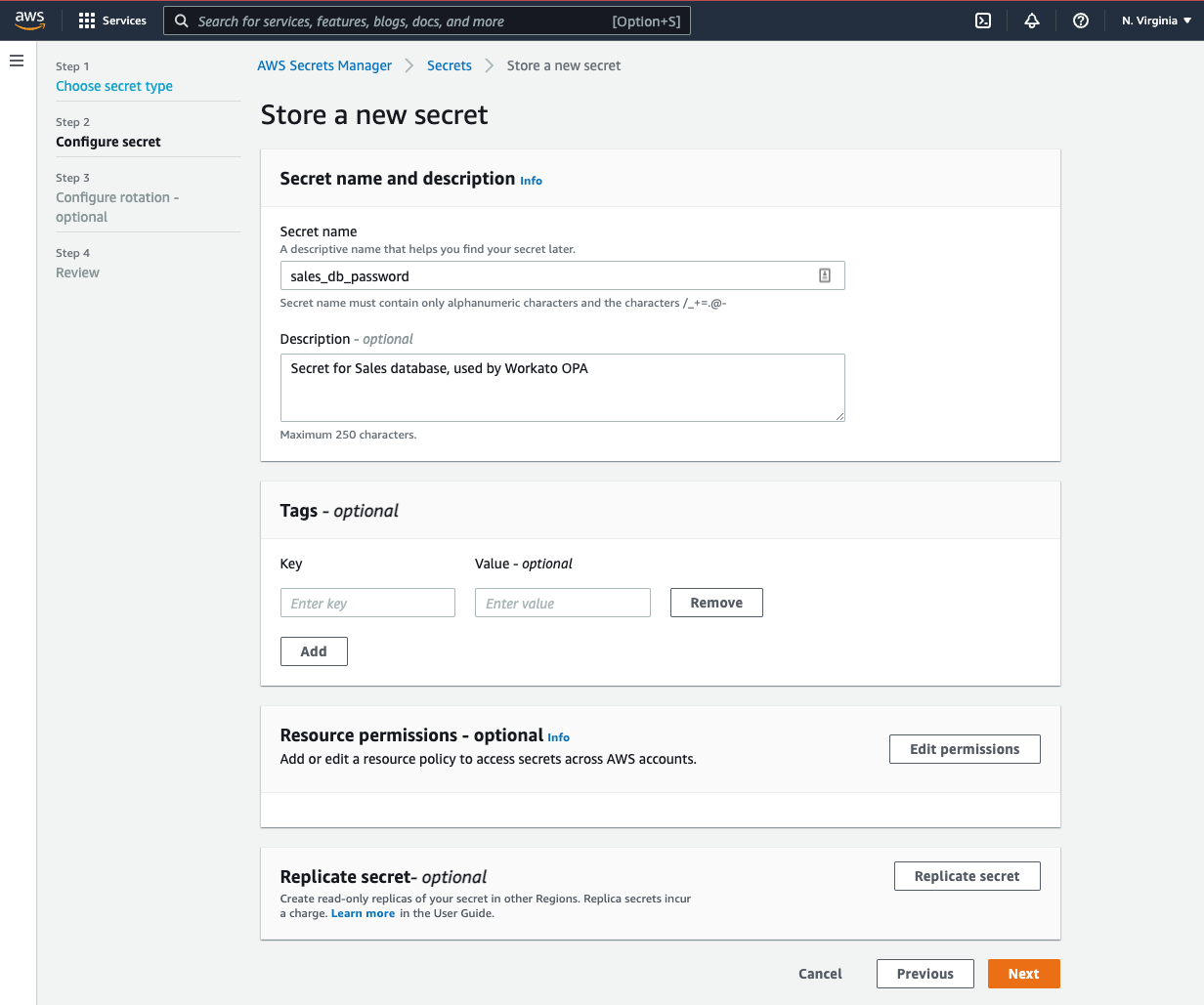

On the Step 2 - Configure secret page:
Fill in the following fields:
- Secret name: Enter a name for the secret. You'll add this value to your OPA config file in the next section, which will allow OPA to retrieve the correct password.
- Description (optional): Enter a brief description of the secret.
Configure Secret page in AWS Secrets Manager
When finished, click Next.

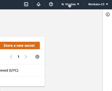

For region, enter the region your AWS instance is in:
secrets:
provider: aws
region: us-east-1You can find this info in your AWS console by clicking the region menu at the top of the page, located next to the user menu:
In this example, the region is us-east-1.
