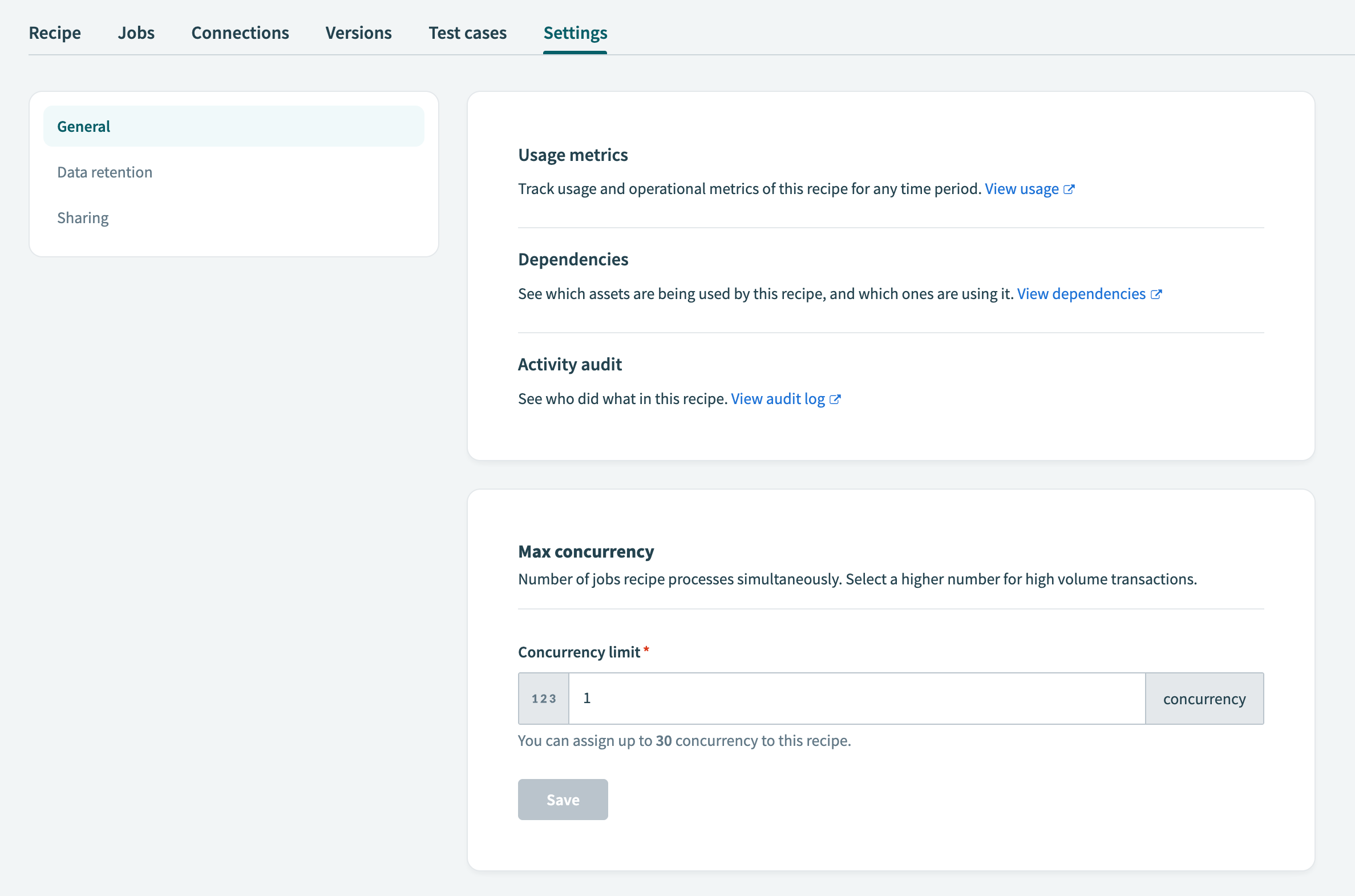

# General
This section of the settings page enables you to determine recipe concurrency, keep track of recipes that monitor this particular recipe, and access resources to manage your recipes.
# Concurrency
The concurrency of a recipe determines the number of jobs that Workato can process simultaneously. Select a higher number for use cases that require high volume transactions.
The default recipe concurrency is 1, and the maximum recipe concurrency is 30
