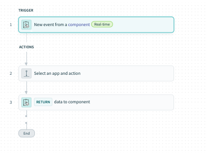

Workato generates a recipe pre-configured with the New component event (real-time) trigger and the Return data to component action:
Recipe outlineRecipe outline

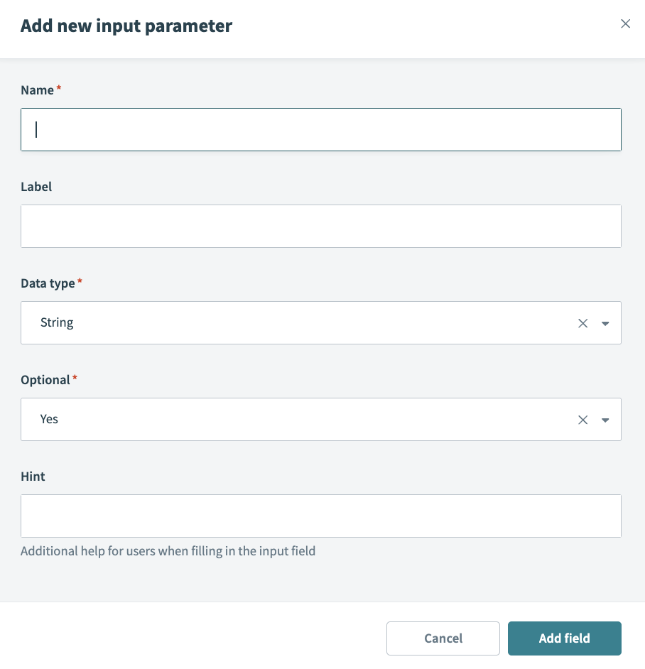

Go to Input parameters and click Add input parameters.
Define the page data to use in your recipe. You must provide the Name, Label, Data type, and Optional status for each input parameter.
Configure input parametersConfigure input parameters

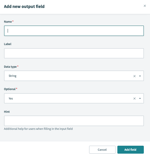

Go to Output schema and click Add field.
Define the recipe output you plan to return to your page. You must provide the Name, Label, Data type, and Optional status for each output parameter.
Configure output schemaConfigure the output schema

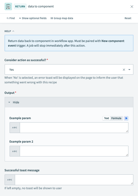

Select the Return data to component action.
Use the Consider this action as successful? drop-down to define whether the action completed successfully.
Go to the output section and map in recipe data to the provided output fields. This output matches the output fields defined in the New component event trigger.
Return data to componentReturn data to component

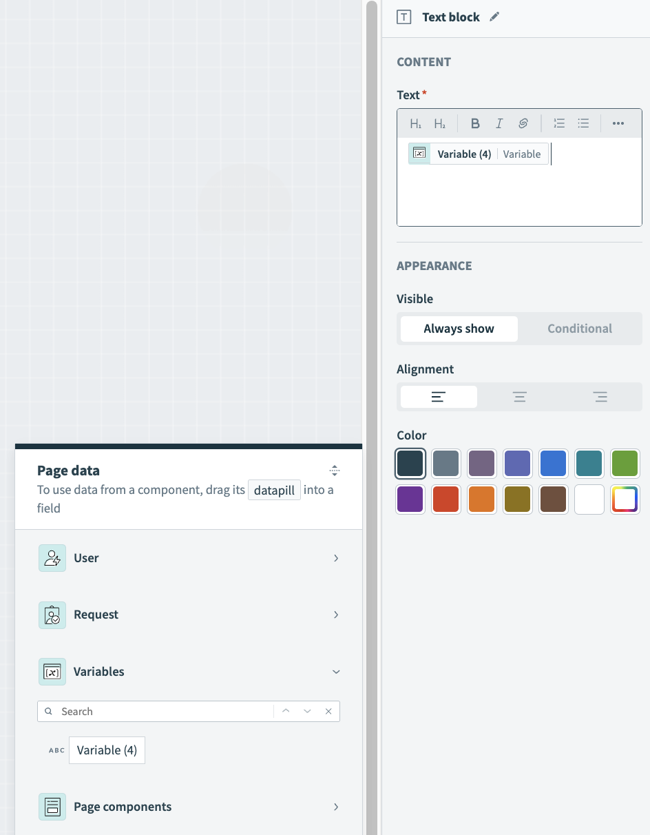

Select a component where you plan to display the variable, such as a text block, and go to the Content panel.
Use the Page data modal to map in a variable.
Map a variableMap a variable

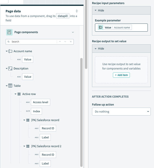

Go to Recipe input parameters.
Use the Page data modal to map in page component data. For example, you can map in user input, such as an Account name to use it to search for account data in an external system.
Recipe input parametersDefine recipe input parameters

Go to Recipe output to set value and click + Add item.
Use the Recipe output drop-down menu to select recipe output.
Use the Set value for drop-down menu to select a page component or variable to set the value for. Refer to Populate a variable using recipe output to for more information.
Recipe outputPopulate variable values with recipe output
