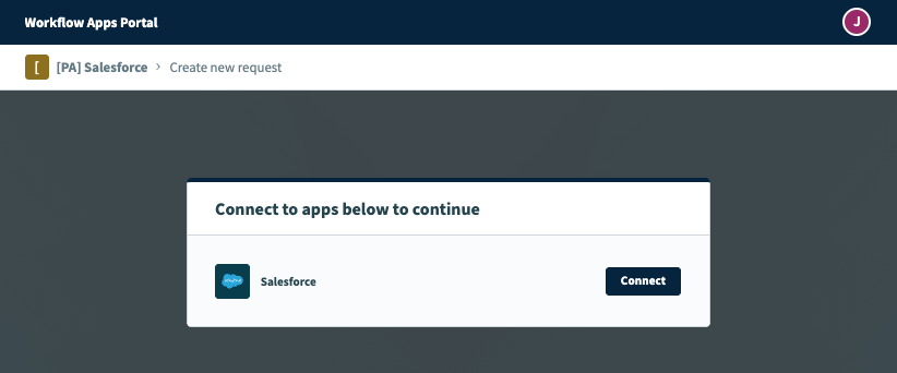

Connection prompt: Workflow apps prompts the user to click Connect if they don't have an established runtime user connection. The Workflow apps recipe executes using this child connection.
No action required: If the user already has an active runtime user connection, Workflow apps recipes execute using the child connection and the pages and components load normally without additional user action.
Connect prompt in the Workflow apps portal
For example, when you open a Workflow apps page that's configured with page components or run recipe actions that depend on a Salesforce connection that requires verified user access, it creates a child connection for the user. This new connection links to the recipe's default Salesforce connection as its parent.

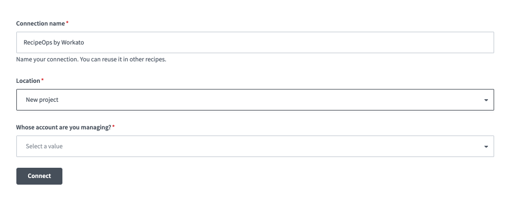

Set up your RecipeOps by Workato connection
Complete the following steps to set up your RecipeOps connection:
Search for and select RecipeOps on the New connection page.
RecipeOps connection setup
Use the Whose account are you managing? drop-down menu to select My account.
CONNECTION PRIVILEGES
RecipeOps connections configured to monitor My account have admin privileges and access to all RecipeOps actions and triggers in your workspace, regardless of the role of the user creating the connection.

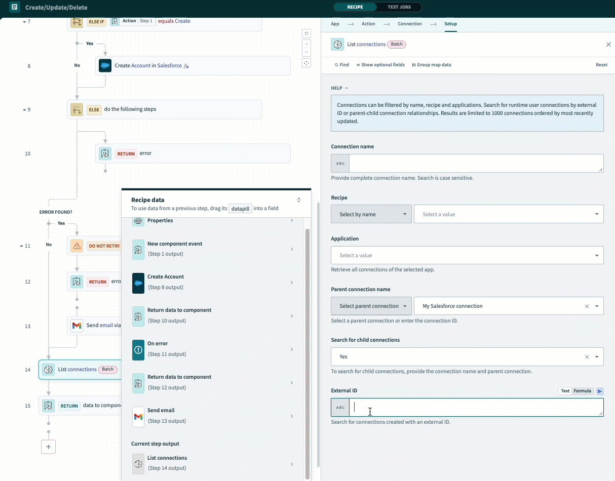

Select List connections (batch) as the action.
Configure the List connections (batch) action
Complete the following steps to configure the List connections (batch) action:
Use the Parent connection name drop-down menu to select the parent connection name. Alternatively, you can supply the parent connection ID.
Use the Search for child connections drop-down menu to select Yes.
Map the New component event User IDStep 1 datapill to the External ID field.

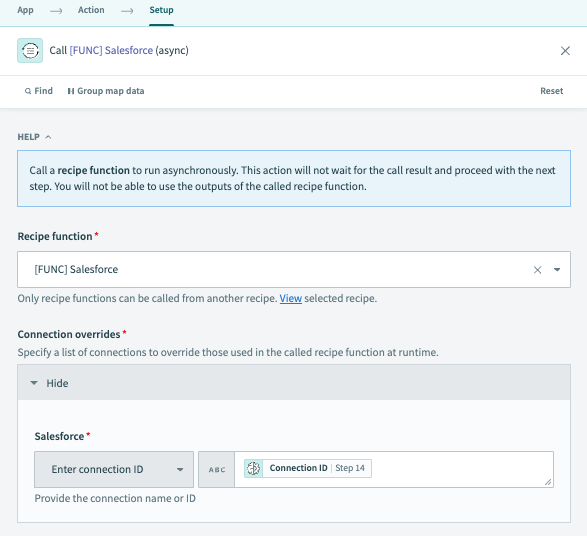

Search for and select Recipe function by Workato as your app.
Select Call a recipe function (asynchronous) or Call a recipe function (synchronous) as your action.
Set up your Call a recipe function action
Complete the following steps to set up your Call a recipe function action:
Use the Recipe function drop-down to select the recipe function you plan to call.
Go to Connection overrides and map in the List connections Connection IDStep 14 datapill.
Map in the List connections Connection IDStep 14 datapill

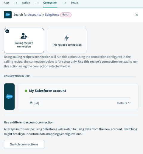

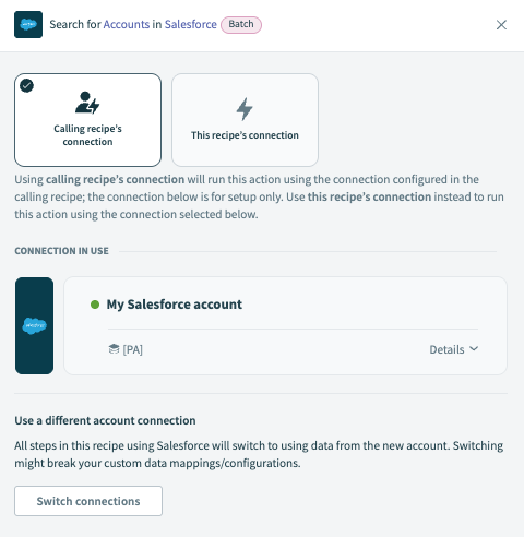

Open the recipe function that your recipe calls.
Select the Action in an app that you plan to use with verified user access.
Go to the Connection tab and ensure the app is configured to use the Calling recipe's connection.
Ensure the app connection uses the Calling recipe's connection
