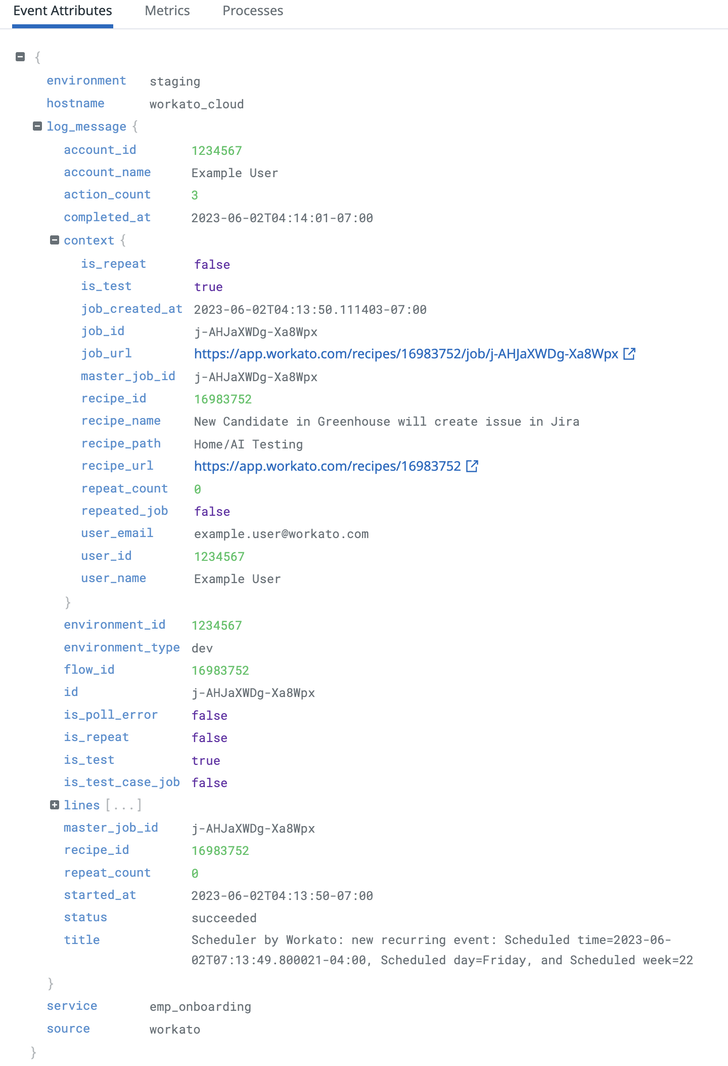

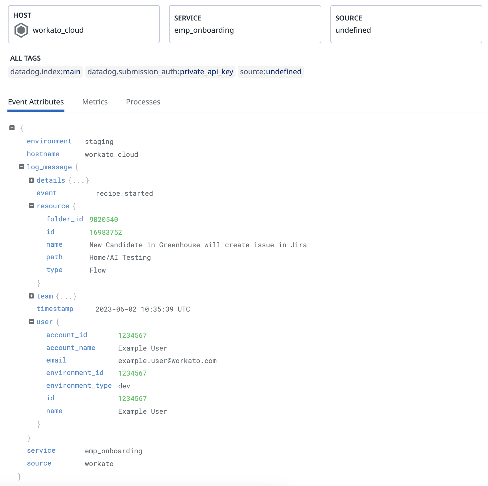

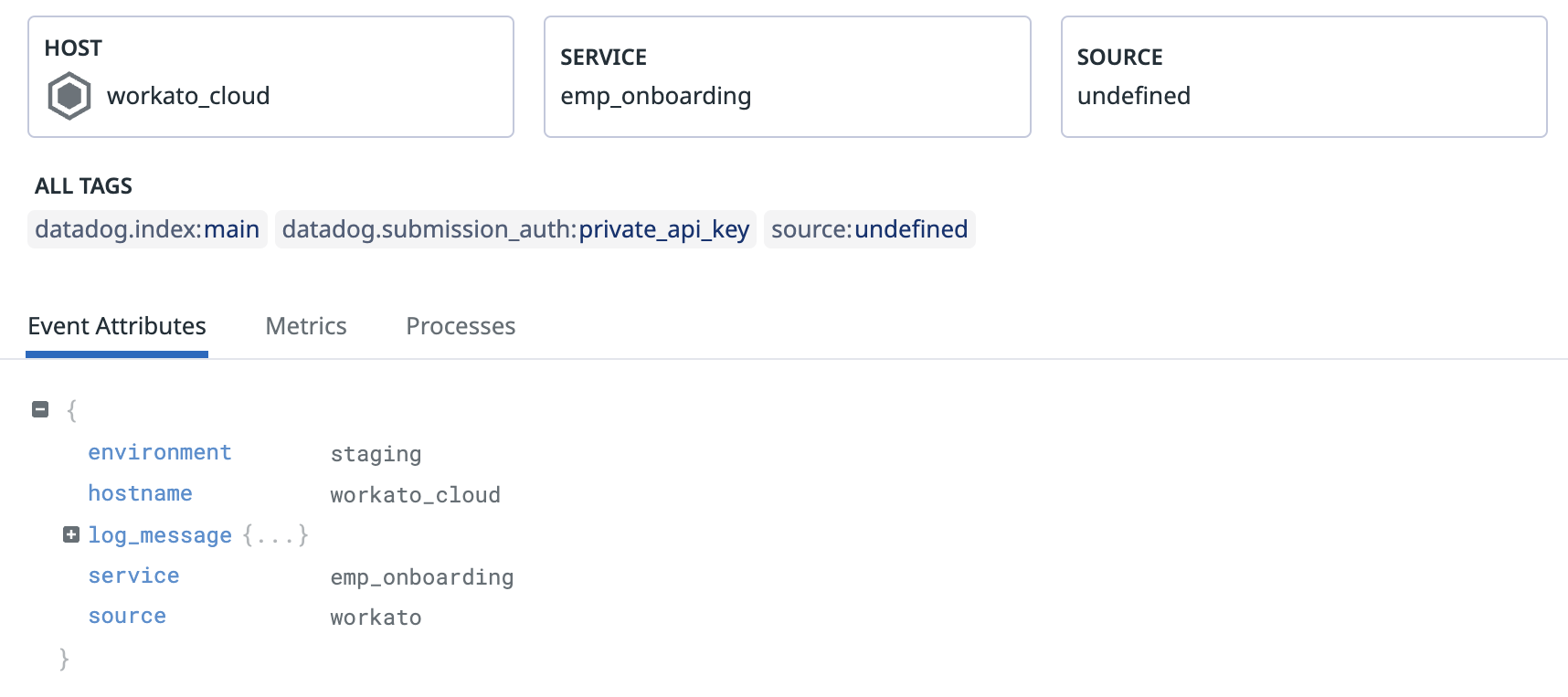

The following images show what the log message looks like in the Datadog log explorer.
Custom audit log message fields
Custom recipe started activity audit log message
Custom job history audit log message
