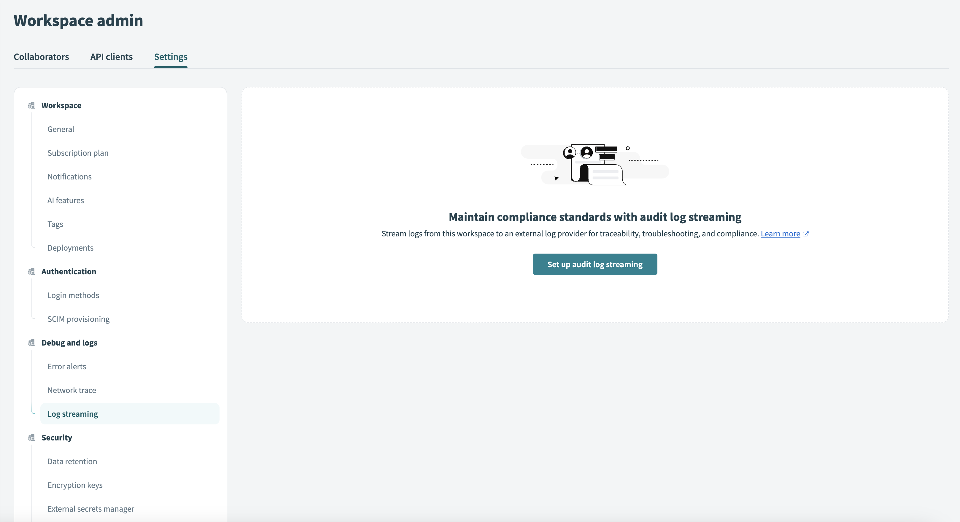

Set up audit log streaming ​
Go to Workspace admin > Settings > Log streaming and select Set up audit log streaming:
Enable audit log streaming
Select the audit log destination.
Configure the streaming connection and options.
Choose the events to include in your audit log stream.
Consult Audit log streaming types for more information about events.
Optional. Customize a log message if required.
Select Save.
