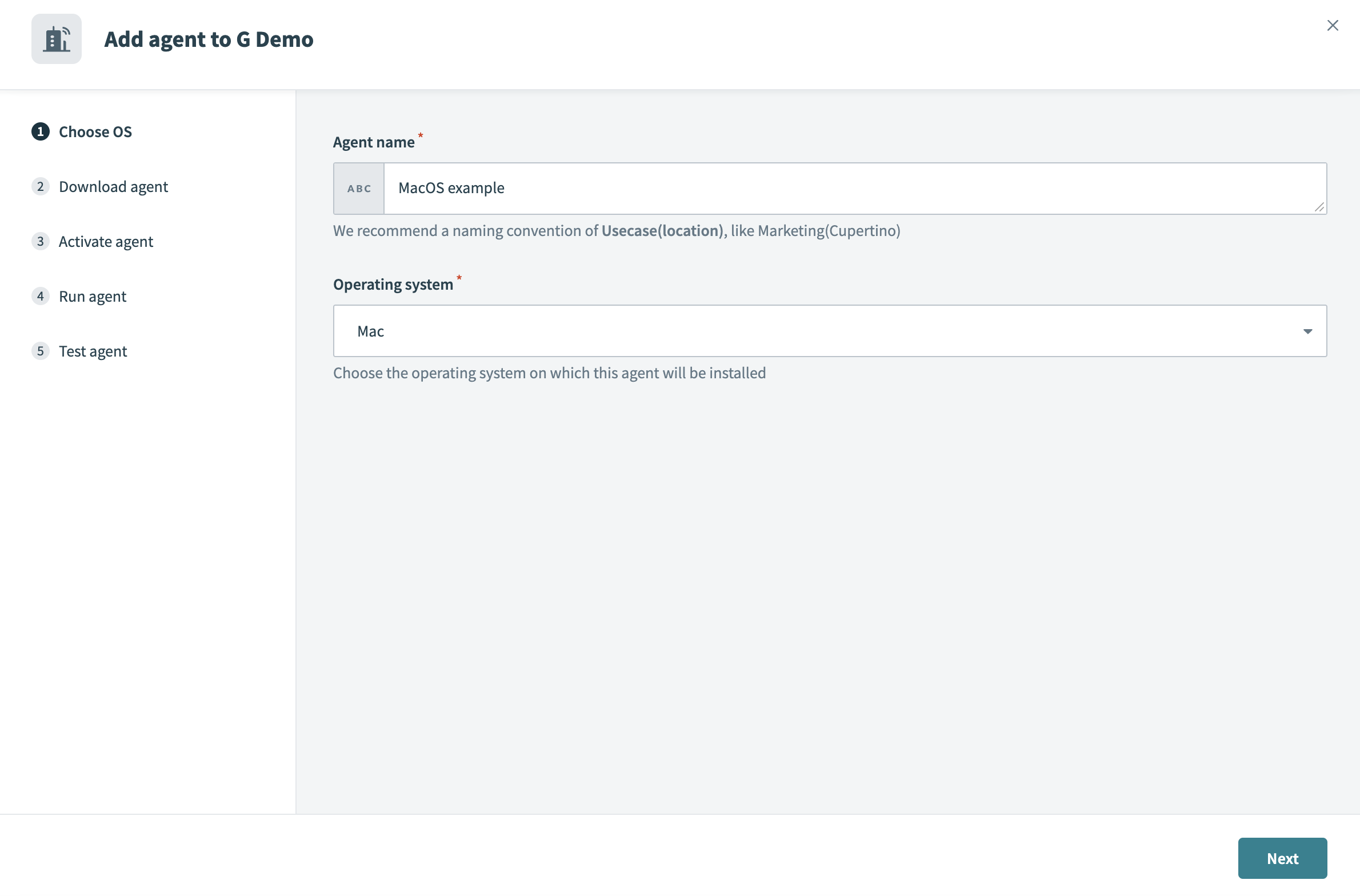

Provide an Agent name, use the Operating system drop-down menu to select Mac, and then click Next.
Select Mac as your operating system

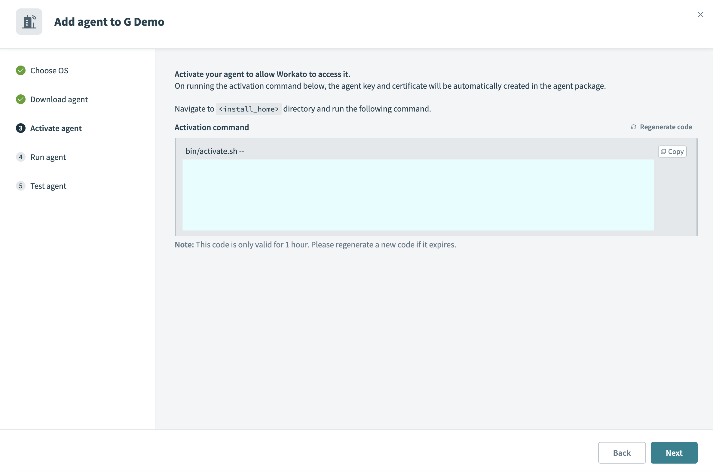

Copy and paste the Activation command from Workato into the terminal and run it. The agent key and certificate are automatically created in the agent package.
AGENT ACTIVATION USING A PROXY
You must add the --proxy-host=<host-ip-address> and --proxy-port=<port number> parameters to the Activation command if you're using a proxy. Refer to the Set up proxy access for your on-prem agent guide for more information.
Run the activate script with the --help parameter to display the list of accepted input properties.
CODE IS VALID FOR ONE HOUR
The code is valid for one hour. Click Regenerate code to generate a new code if it expires.

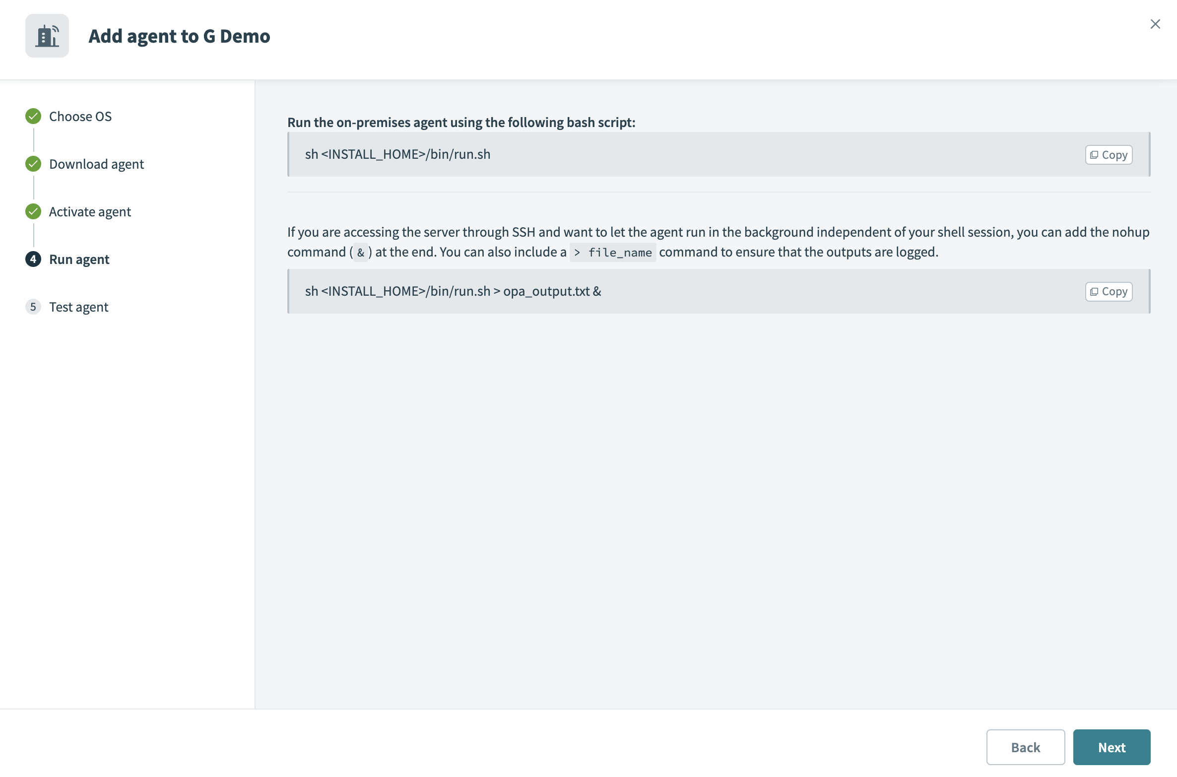

Use the following command to run the on-prem agent, replacing <YOUR_DIRECTORY> with the directory name:
sh <YOUR_DIRECTORY>/bin/run.shSSH SCRIPT CONFIGURATION
You can access the server through SSH to allow the agent to run in the background independent of your shell session if you add the nohup command (&) at the end of the script. You can also include a > file_name command to ensure that the outputs are logged.
sh <YOUR_DIRECTORY>/bin/run.sh > opa_output.txt &
Run the on-prem agent

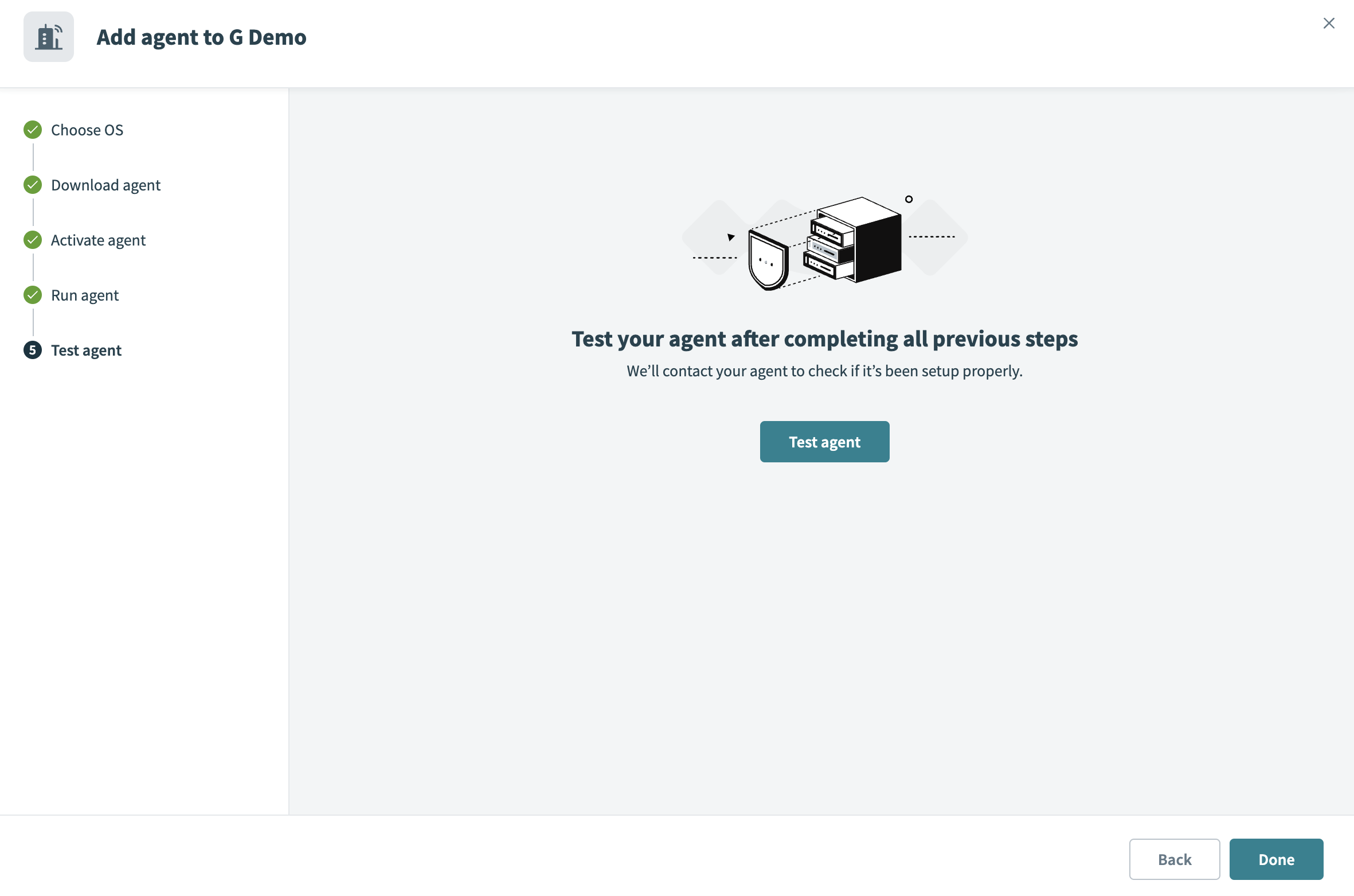

Click Test agent to confirm that your on-prem agent is working as expected.
Test the on-prem agent
Click Done to complete the installation.
