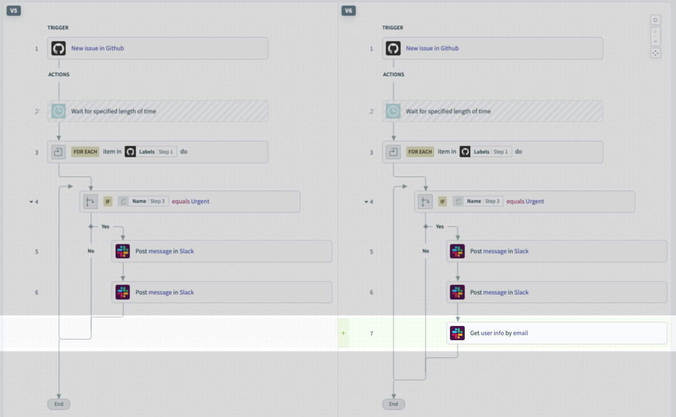

Adding a step
When a new step is added to a skill or recipe version, the step is highlighted in green:

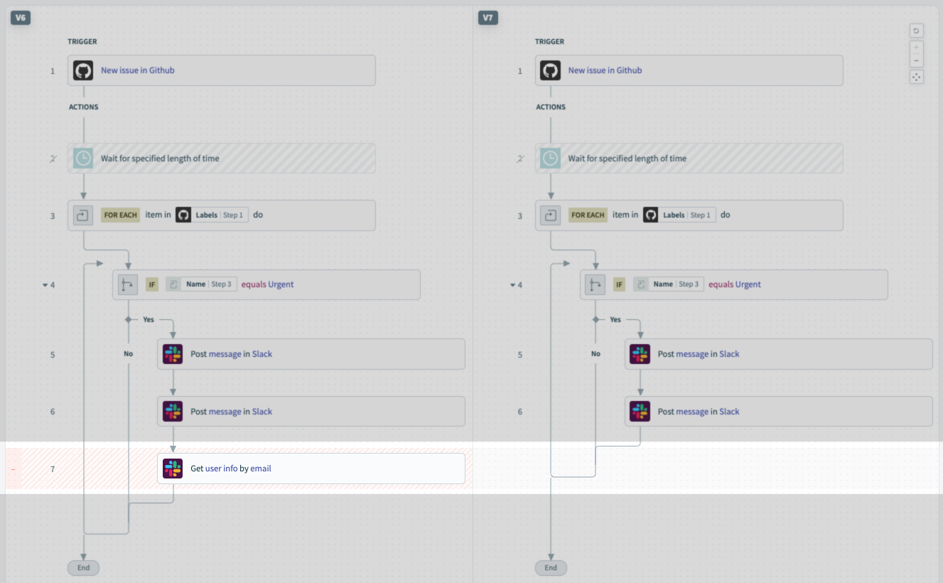

Deleting a step
When a step is deleted from a skill or recipe version, the step is highlighted in red:

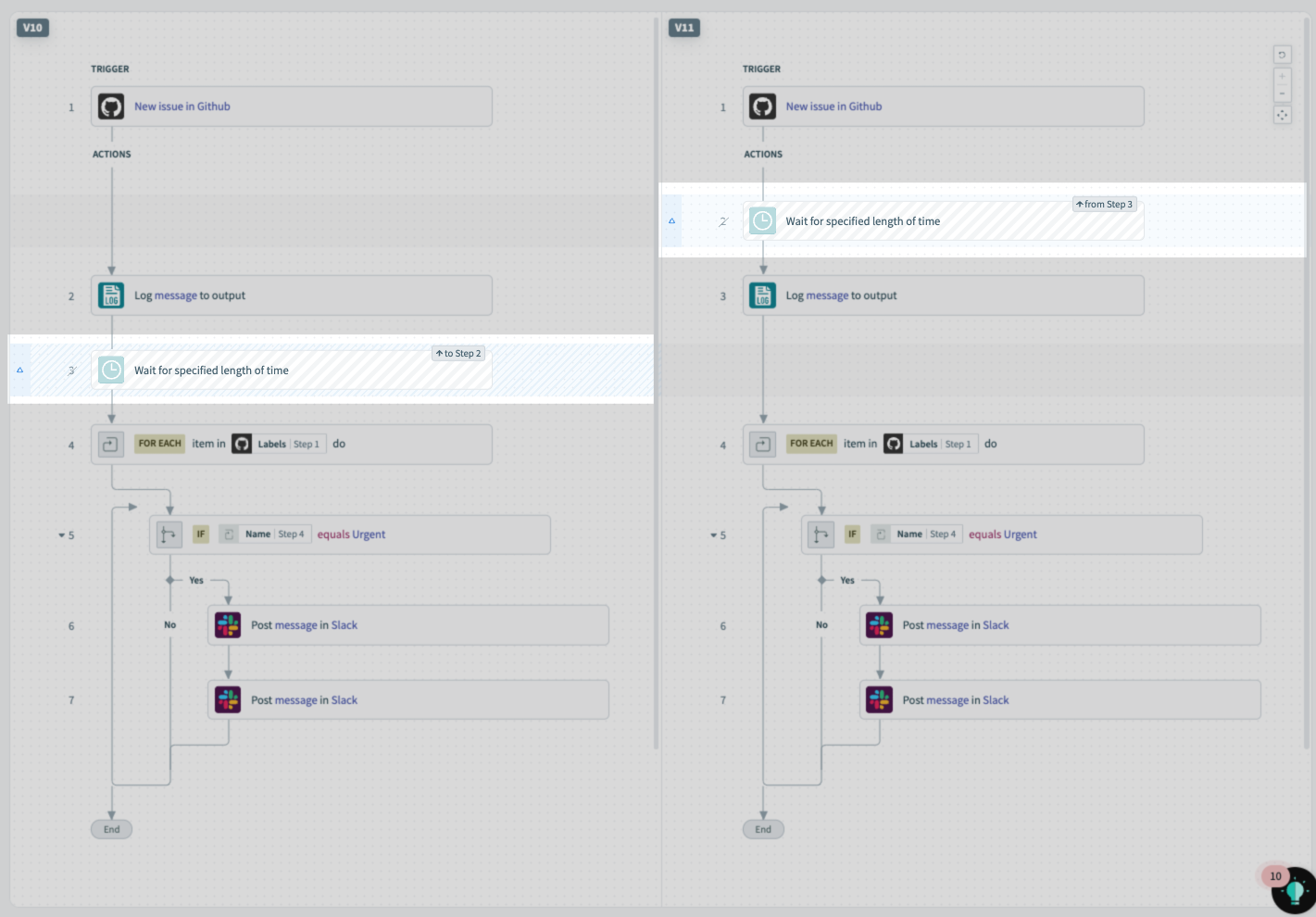

Moving a step
When a step is moved in a skill or recipe version, the step is highlighted in blue and a label describing the movement will display:

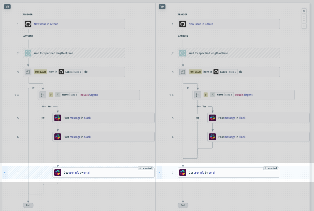

Nesting or unnesting a step
When a step is nested or unnested in a skill or recipe version, the step is highlighted in blue and a Nested or Unnested label will display:

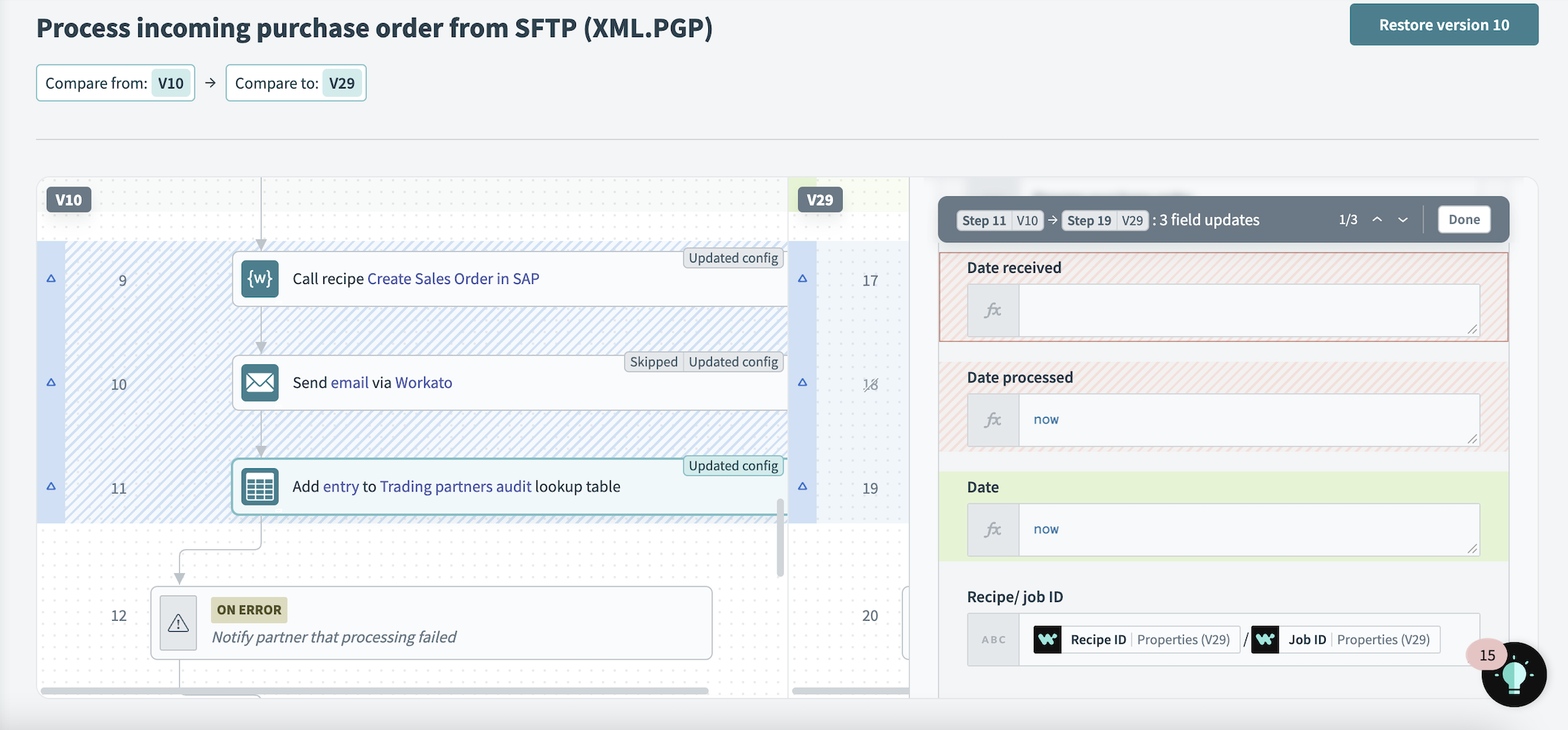

Updating a step's configuration
When a step's configuration is changed, the step is highlighted in blue and an Updated config label displays. Furthermore, within the step configuration, field addition, removal, and updates will be displayed.
Viewing step-level changes
Field updates and datapill changes will display in the diff.
- Field addition (green)
- Field removal (red)
- Field updates (grey) - this includes switching datapills and formulas

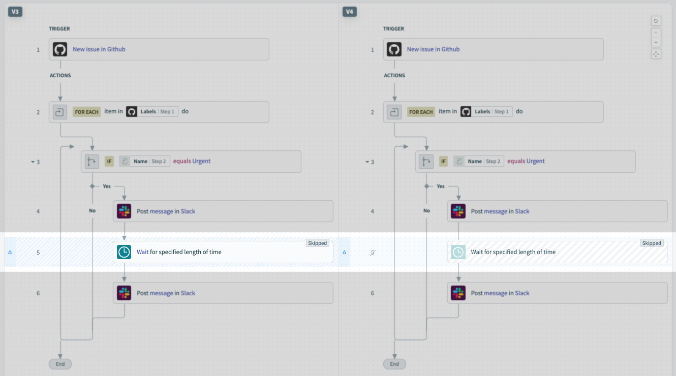

Skipping or unskipping a step
When a step is skipped or unskipped in a skill or recipe version, the step is highlighted in blue and a Skipped or Unskipped label displays:

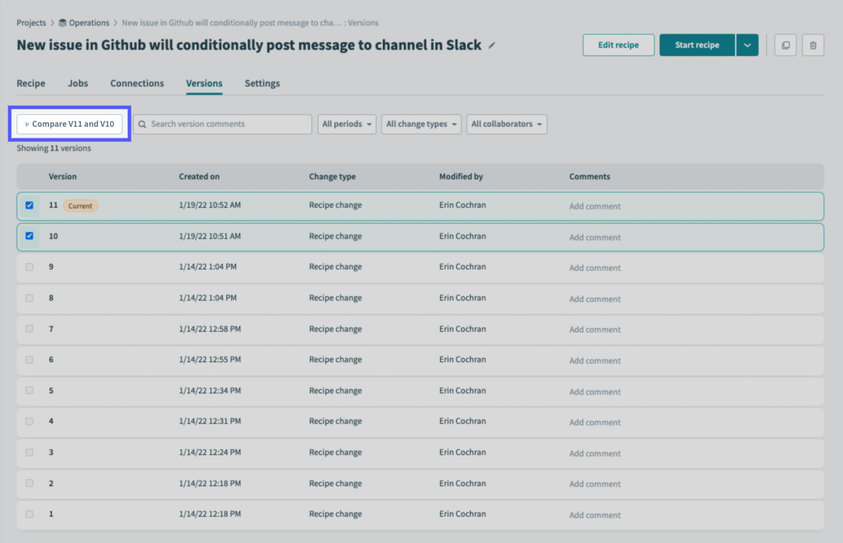

You can access the Recipe Diff feature in the following ways:

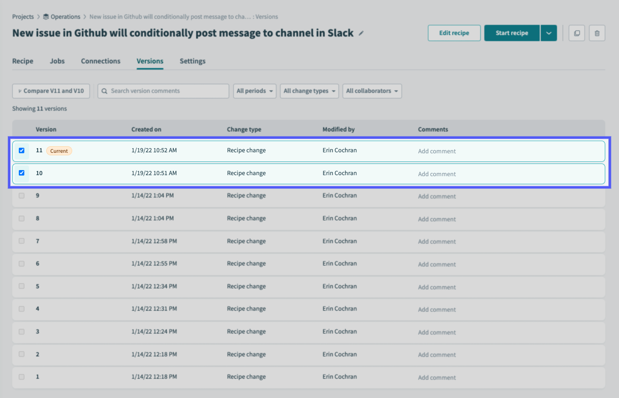

From the Version history page:
Check the checkboxes of the versions you want to compare:
Click the Compare VXX and VXX button:

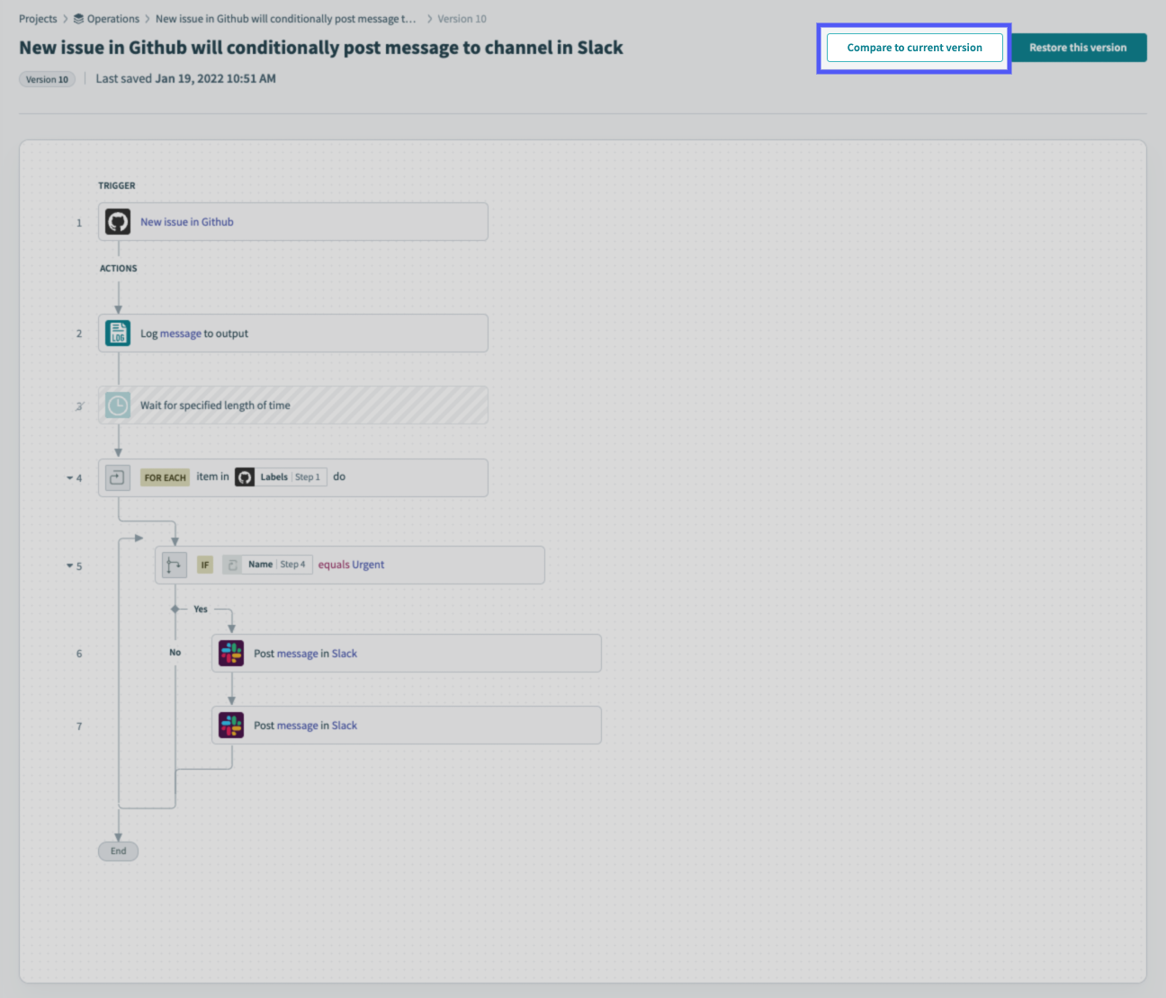

From the Version details page:
Click a skill or recipe version.
On the Version details page, click Compare to current version near the top right corner of the page:
If you're viewing the current version of the skill or recipe, the button will read Compare to the previous version.

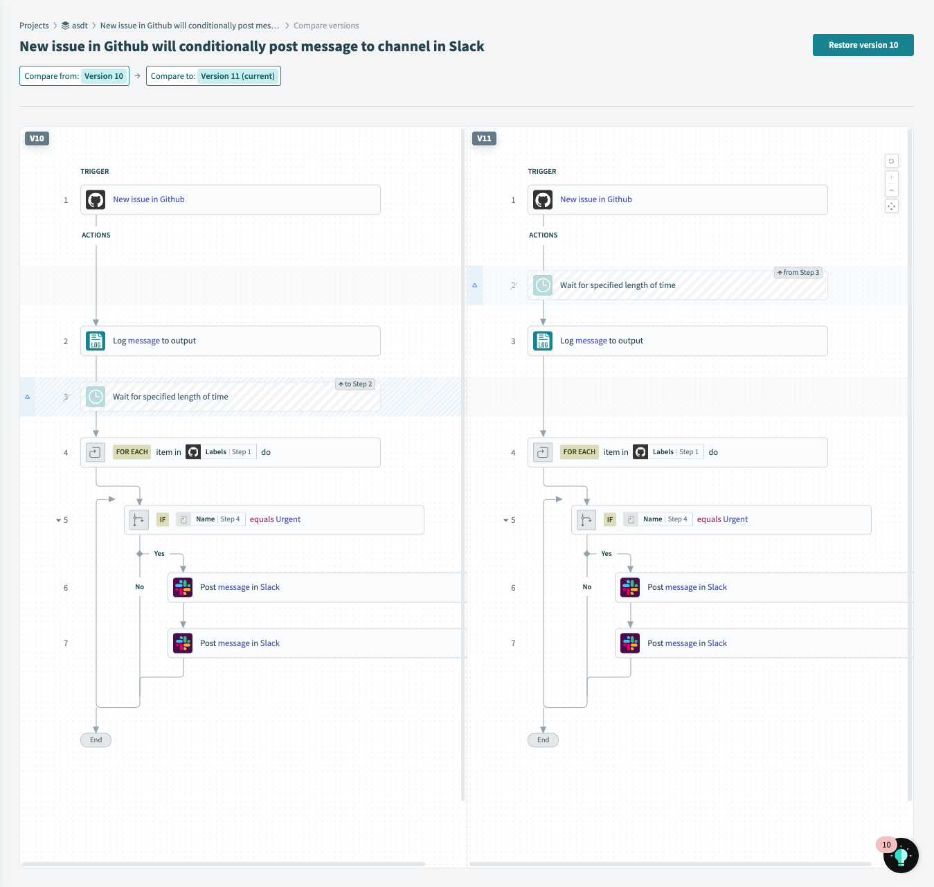

The Recipe Diff page will display:
Changes between the versions will be highlighted depending on their type.
You can also use interactions like Zoom by right-clicking or using keyboard shortcuts:

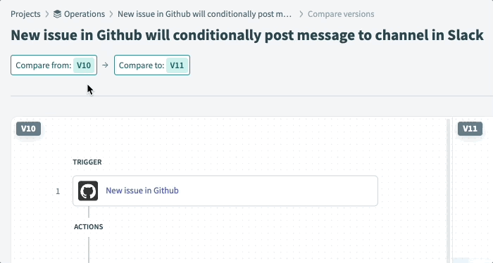

To change the versions you're comparing, use the Compare from and Compare to menus:
The comparison views will automatically update with the selected version(s).
