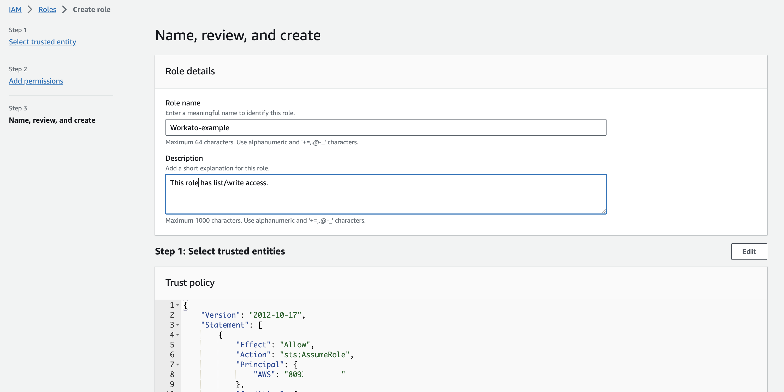

Select appropriate permissions for Workato to run automated workflows in your account.
Provide a Role name and Description for the IAM role.
  • Workato recommends that role name avoids using a non-guessable resource-id in the ARN and does not include the external ID.
Optional. At the Select trusted entities step, click Edit to add or edit policies for trusted entities.
Optional. At the Add permissions step, click Edit to add or edit permissions.
Optional. If you are using object tags, select an appropriate tag for this IAM role.
Review and createReview and create role
Click Create role.
