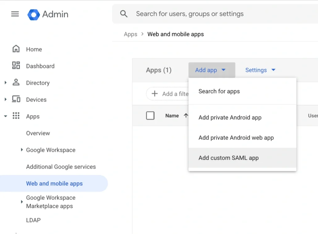

Go to Apps > Web and mobile apps.
Click Add App > Add custom SAML app.
