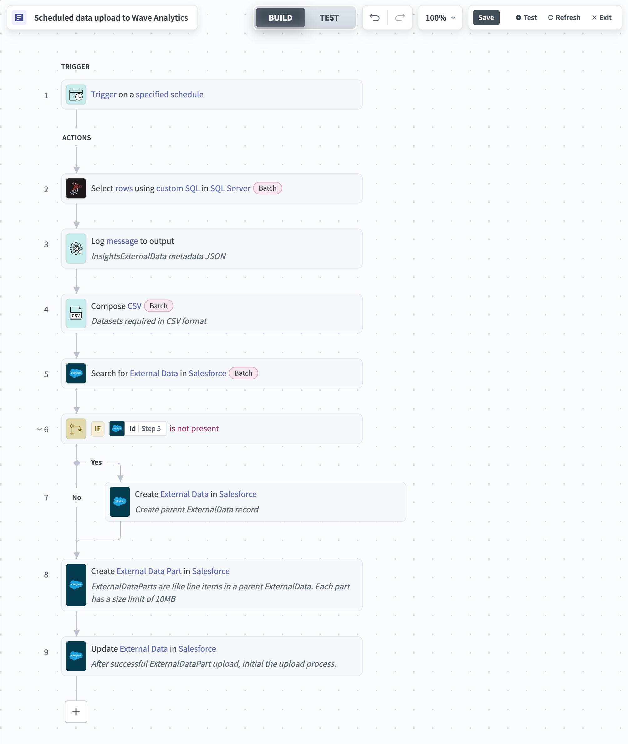

Example recipe
Let's put everything together into the following recipe.
Analytics Cloud recipe. Example recipe
This recipe performs a daily upload from SQL Server database to a dataset in Analytics Cloud. The recipe can be broken down to the various steps mentioned before.
- Retrieving data from external data source
- Defining a metadata JSON
- Preparing data from external data source into CSV format
- Create an External Data record
- Upload Insights External Data Parts
- Initial upload process by updating
Requested Actionfield to "Process" in External Data record.
