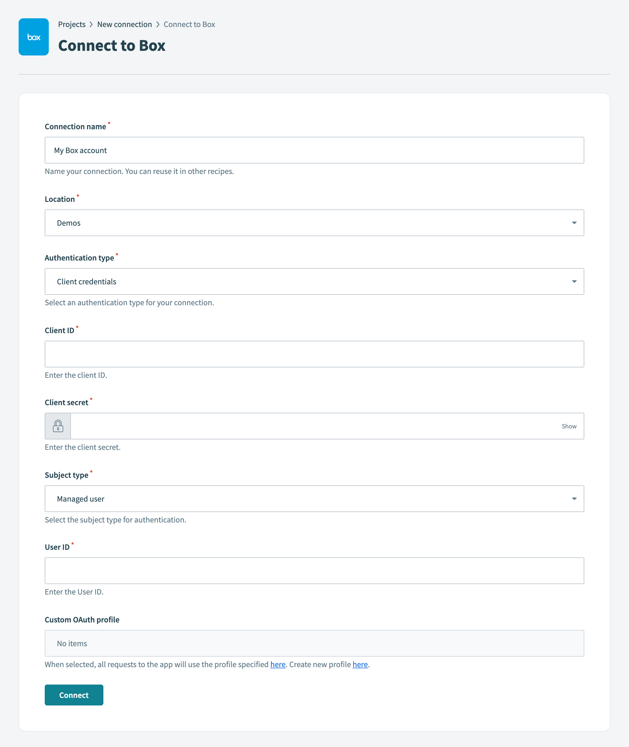

Sign in to Workato and create a new Box connection.
Provide a name that identifies which Box instance Workato is connected to in the Connection name field.
Connect to BoxConnect to Box using client credentials authentication
Use the Location drop-down menu to select the project or folder where you plan to store your connection.
Use the Authentication type drop-down menu to select Client credentials.
Enter the client ID from the Get required values step in the Client ID field.
Enter the client secret from the Get required values step in the Client secret field.
Use the Subject type drop-down menu to select your subject type. Available options include Managed user and Service account.
  • Managed user: Enter the user ID from the Get required values step in the User ID field.
  • Service account: Enter the enterprise ID from the Get required values step in the Enterprise ID field.
12
Optional. Specify the custom OAuth profile you plan to use for this connection in the Custom OAuth profile field.

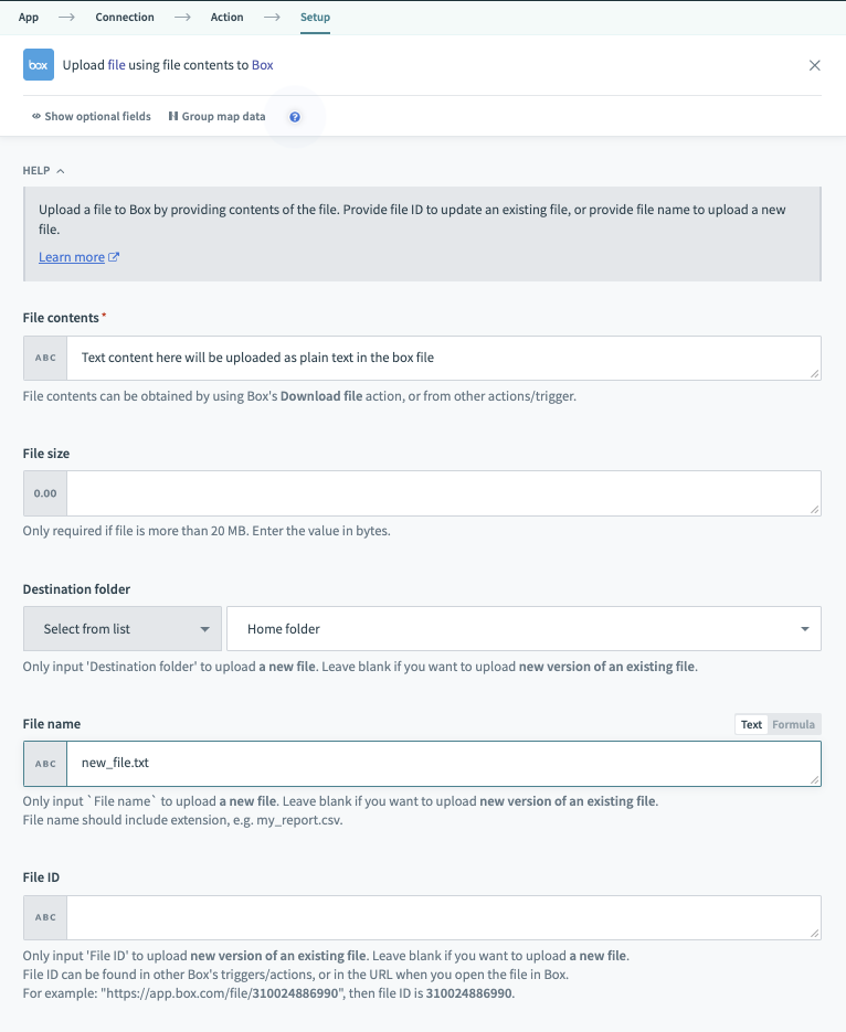

Upload file content
You can upload plain text file content using this action.
Enter the text for your file in the File Content field.
Select the folder you plan to upload in Box.
Enter a name for the file, including the extension.
Box Attachment 1Upload file content

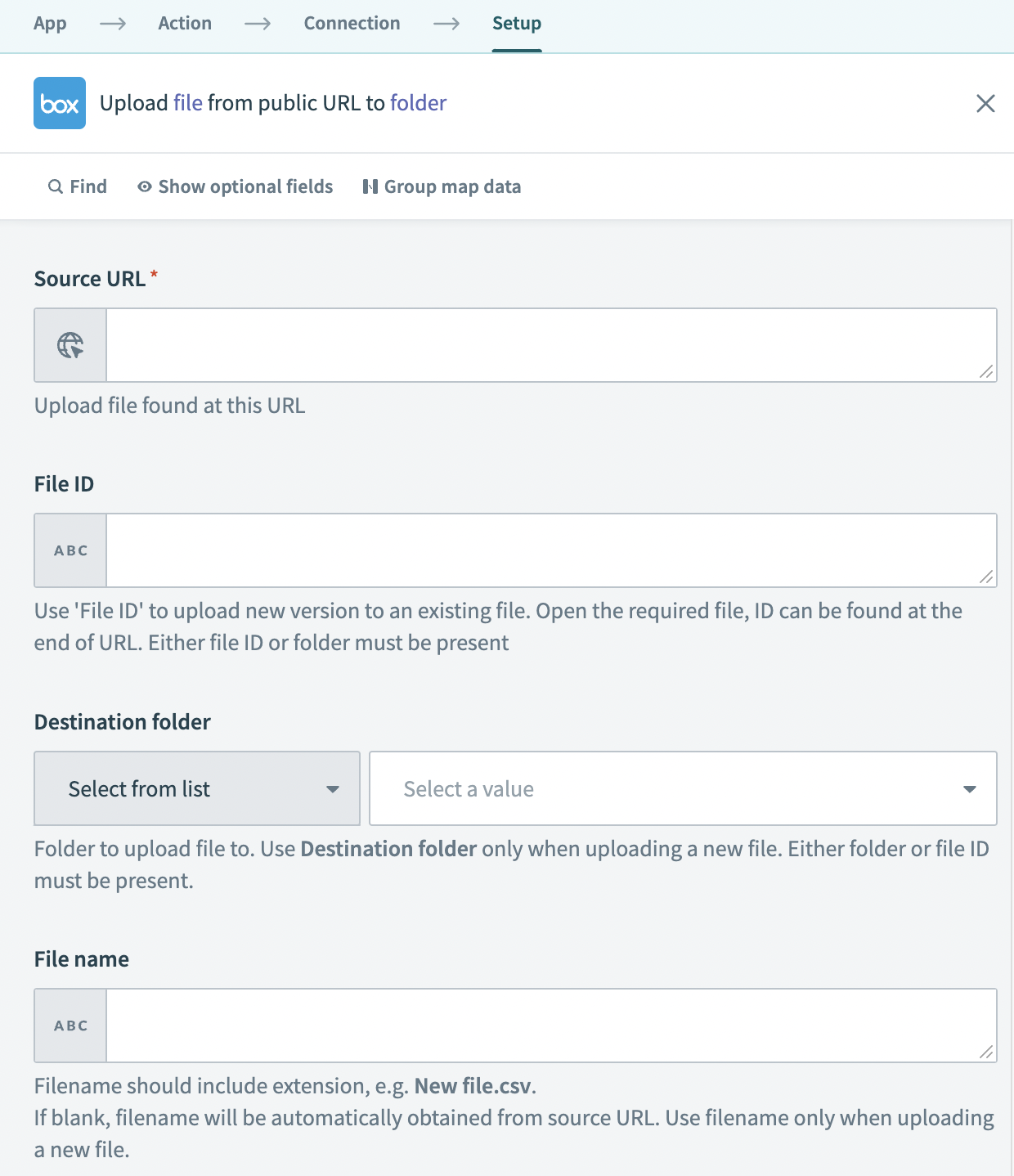

Upload file from URL
You can upload a file directly from a URL rather than entering text content. This allows you to upload non-text files such as images.
Enter the URL for the file you plan to upload in the Source URL field. Attachment URLs typically end with the file extension for the file (such as .jpg).
Box Attachment 2Upload file from URL
Select the Destination folder where you plan to upload your file. Note that entering a file name is optional as Workato obtains the name of the file from the URL by default.

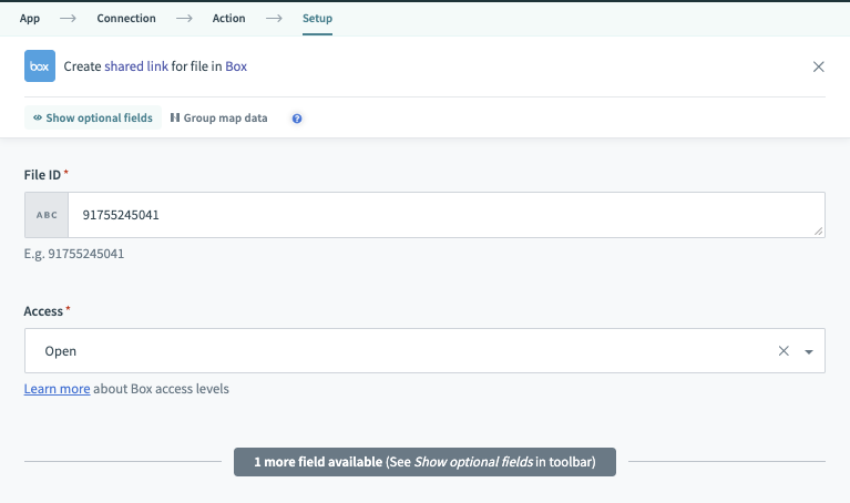

The Create shared link action allows you to create a direct link to a file or folder in Box.
Enter the file ID/folder ID for the file/folder for which you plan to create a shared link.
Select an access level for the shared link (Open, Company, Collaborators, or Default). Refer to Shared link permissions for more information.
  • This sets restrictions on who can view your file/folder using the shared link. If you have a Premium Box subscription, you can also enter a password that link-users must enter before they can access your file/folder.
    Box Attachment 3Create shared links

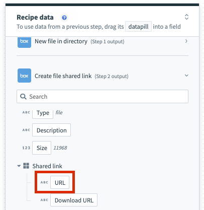

Optional. Use the IDStep 1 datapill from the trigger step to identify the new file when creating the shared URL link, and post the URL in the following schema to your Slack Workbot.
Box Shared Link 1Box Shared Link 2Post the URL in Slack Workbot
