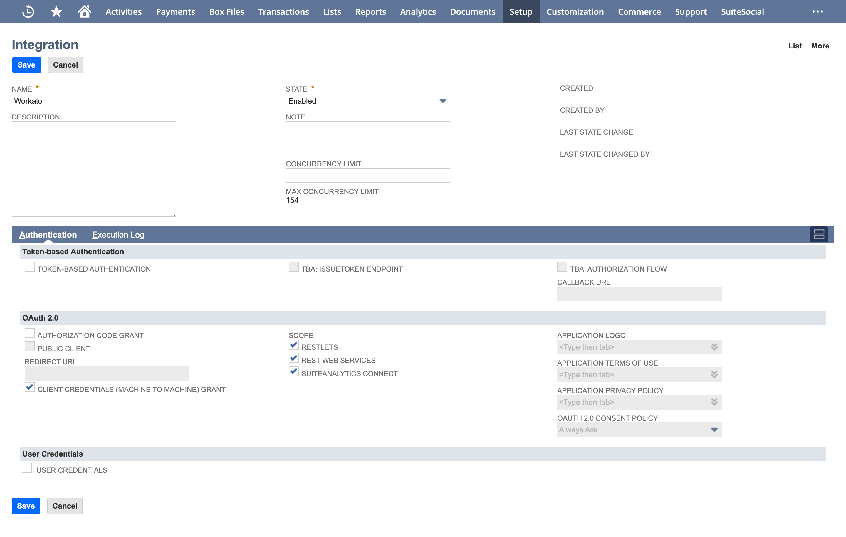

Create an integration record in NetSuite
Complete the following steps to create a new integration record. The integration record represents an app, platform, or tool you plan to integrate with NetSuite.

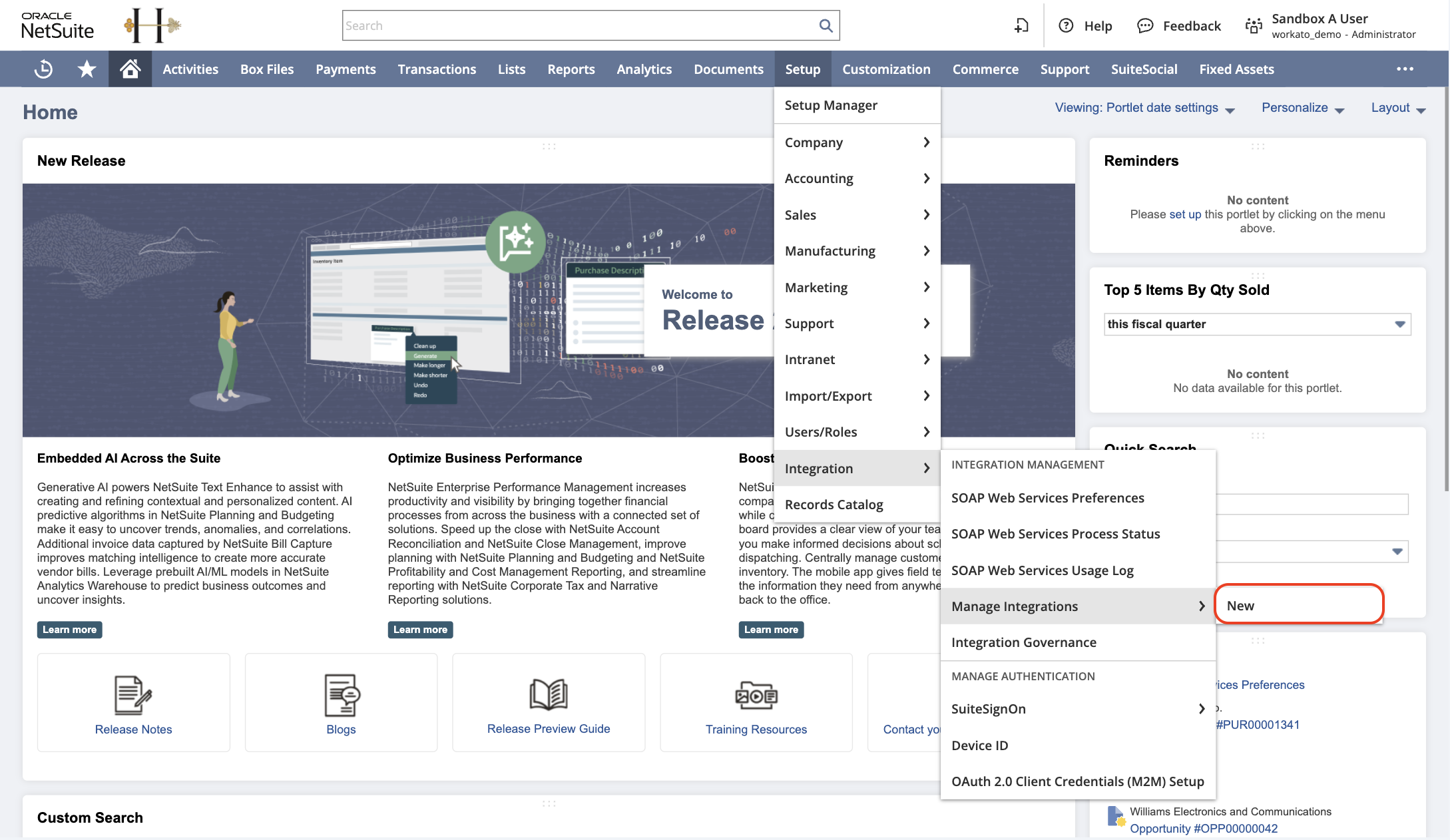

Go to Setup > Integration > Manage Integrations > New.
Provide a name for the integration record in the Name field.
Select the authentication flow based on your use case:
- Select Client credentials (machine to machine) grant to use client credentials (machine-to-machine).
- Select Authorization code grant to use user-based authentication.
You can enable one or both authentication methods depending on your integration requirements.
Select the following scopes:
- RESTlets
- REST Web Services
- SuiteAnalytics Connect

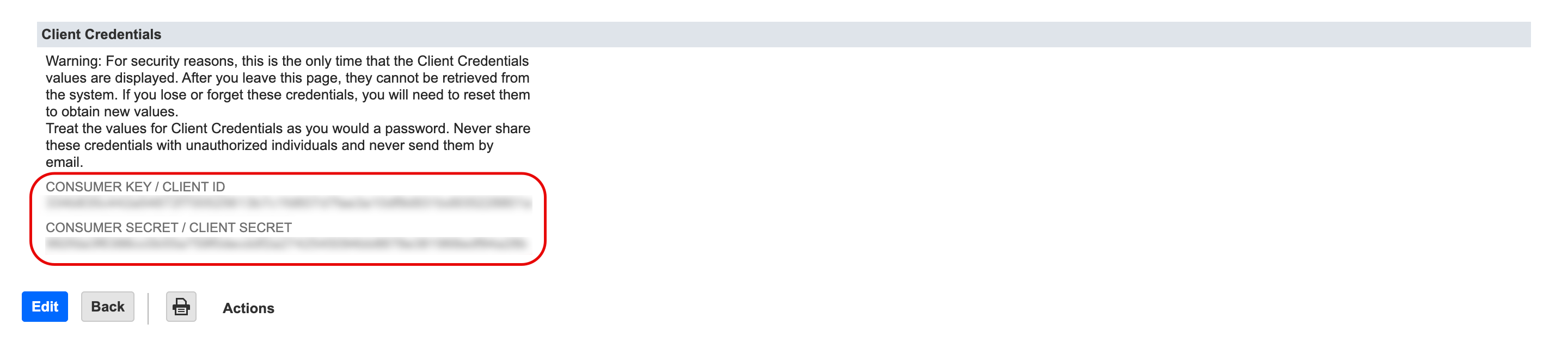

Click Save.
Copy the Consumer key / Client ID and Consumer secret / Client secret and store them securely.
- Client credentials authentication requires an EC private key and certificate.
- Authorization code grant requires a client ID and client secret configured in a custom OAuth profile.
Use the Client ID for client credentials authentication. Use the Client ID and Client secret for authorization code grant.

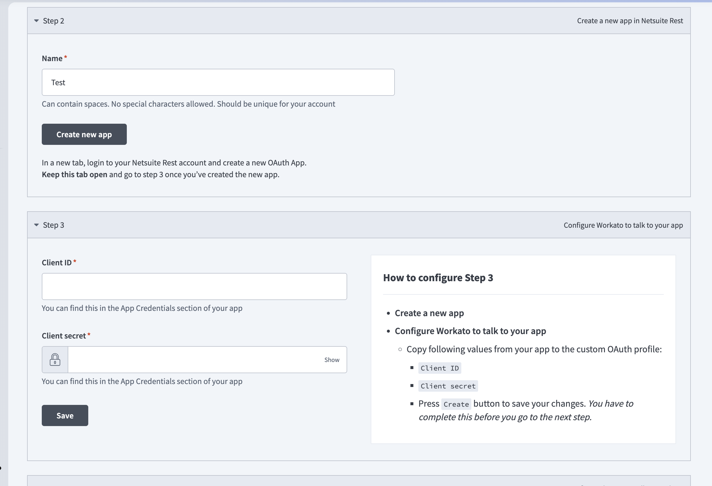

Create a custom OAuth profile in Workato
Authorization code grant requires a custom OAuth profile with a valid client ID and client secret.
Complete the following steps to create a custom OAuth profile:
Go to Tools > Custom OAuth profiles in Workato.
Click + New custom profile.
Select NetSuite REST in the Application field.
Enter a name for the custom OAuth profile in the Name field.
Copy the Client ID and Client secret from the Create an integration record in NetSuite step.
Paste the Client ID and Client secret into their respective fields.
Click Save.
Ensure your integration record in NetSuite supports authorization code grant and includes the required OAuth scopes.
Use the following redirect URL when configuring the custom OAuth profile in Workato:

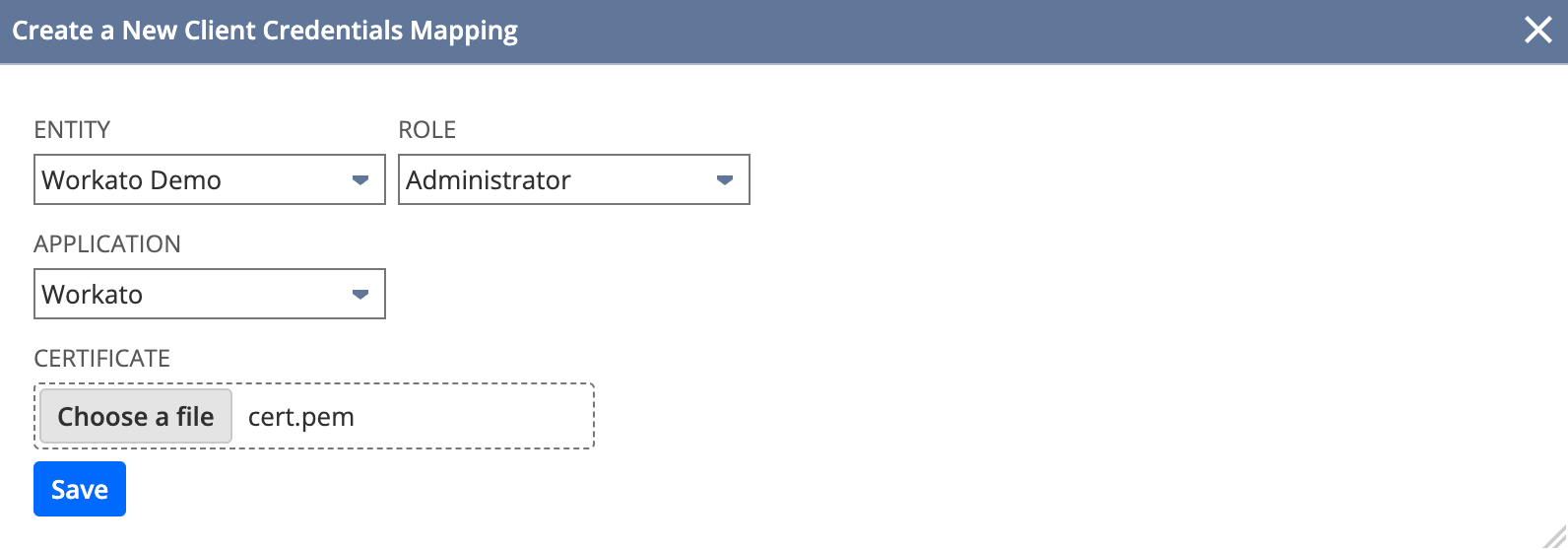

Go to Setup > Integration > OAuth 2.0 Client Credentials (M2M) Setup.
Click Create New. The Create a New Client Credentials Mapping dialog appears.
Configure the following fields:
- Entity
- Select the entity that uses the client credentials. Refer to our NetSuite SOAP connector documentation to learn how to set up an integration user.
- Role
- Choose the role that defines the permissions for the entity. Ensure the selected role has the necessary permissions for the integration. Refer to our NetSuite SOAP connector documentation to learn how to create an integration role.
- Application
- Select the integration record you created in the Create an integration record step.
- Certificate
- Upload the certificate you created in the Create key and certificate files step. The file should be saved on your computer as
cert.pem.

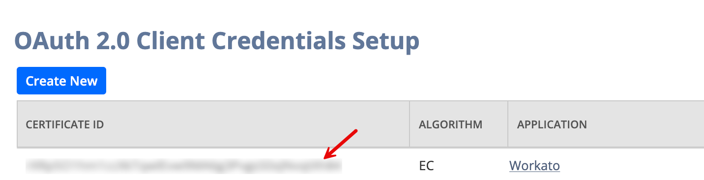

Copy the Certificate ID and store it in a secure location. Workato requires this value to establish the NetSuite REST connection.

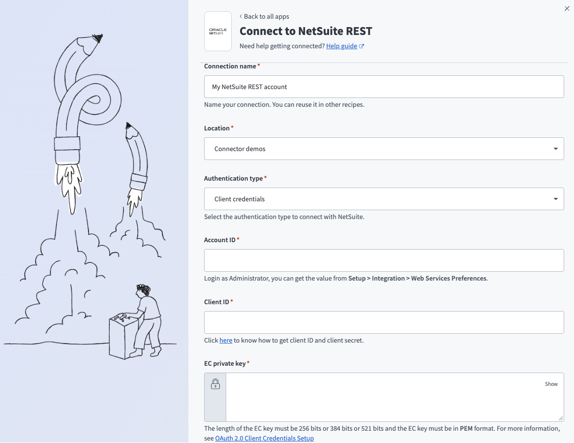

Enter a name for your NetSuite connection in the Connection name field.
Connect to NetSuite REST using client credentials
Enter the folder or project where you plan to store your NetSuite connection in the Location field.
Select Client credentials as the Authentication type.
Enter your Account ID.
Sign in to NetSuite as an Administrator and go to Setup > Company > Company Information to find your Account ID.
You can also find it at the beginning of the NetSuite URL. For example, if the URL is https://1234567.app.netsuite.com/, your Account ID is 1234567.
SANDBOX ACCOUNT ID FORMAT
You must replace underscores (_) with a hyphen (-) and capitalize letters if you are using a sandbox account. For example, 1234567_sb1 must be updated to 1234567-SB1.
Enter the client ID you saved from the Create an integration record in NetSuite step into the Client ID field.
Enter the private key from the Create key and certificate files step into the EC Private Key field. Ensure the key is in PEM format and has a length of 256, 384, or 521 bits.
To extract the key, open the private-key.pem file and copy the text, starting from -----BEGIN EC PRIVATE KEY----- and ending with -----END EC PRIVATE KEY-----.
Enter the certificate ID from the Create a machine-to-machine certificate in NetSuite step into the Certificate ID field.

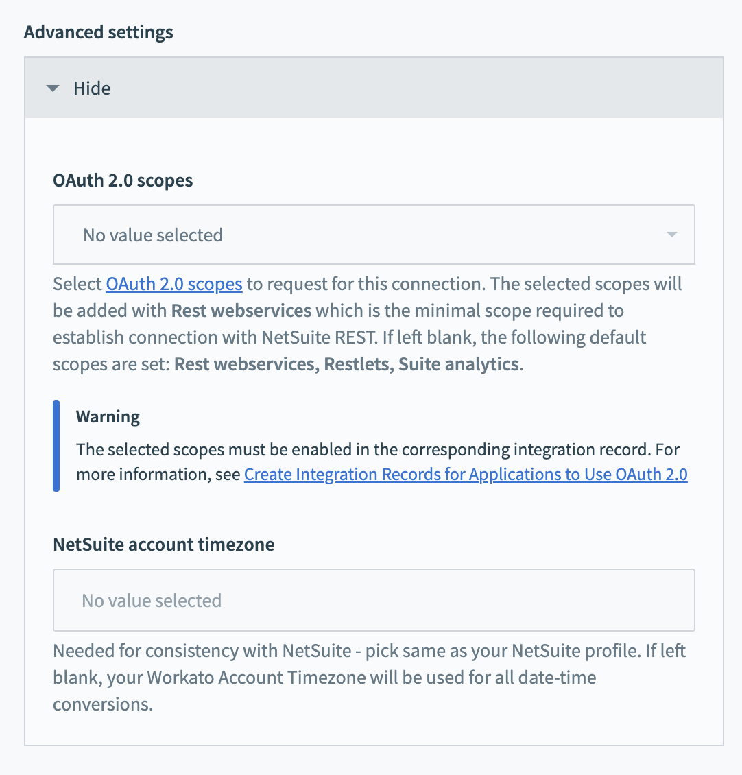

Optional. Click Advanced settings > OAuth 2.0 scopes and select a value.
- Select OAuth 2.0 scopes and add them along with REST Web Services to define the minimum scope required for a NetSuite REST connection. You must enable the selected scopes in the corresponding integration record.
Optional OAuth 2.0 scope settings

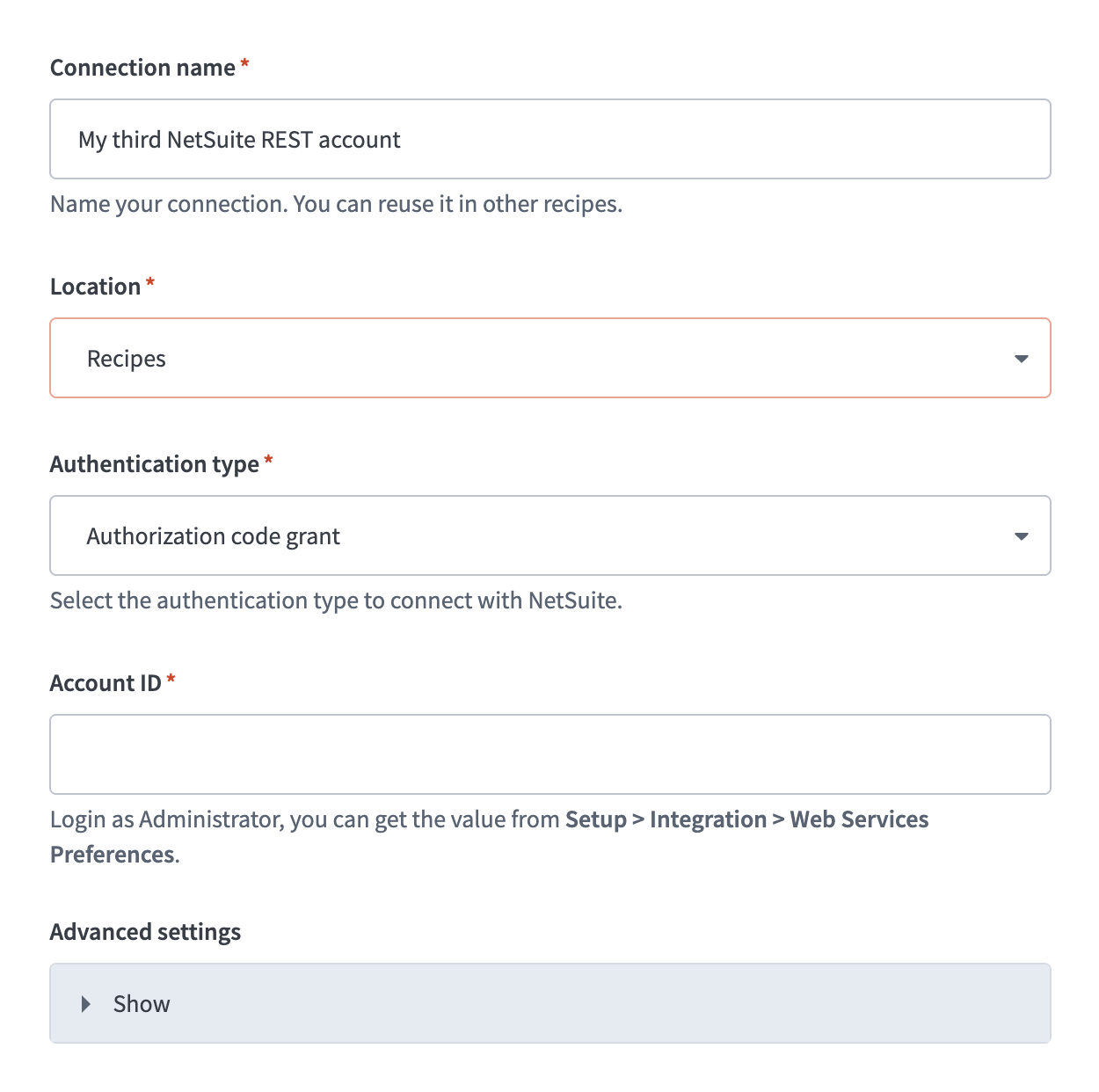

Authorization code grant (user-based authentication)
Complete the following steps to establish a connection using authorization code grant:
Connect to NetSuite REST using authorization code grant
Select Authorization code grant as the Authentication type.
Optional. Expand Advanced settings and configure OAuth 2.0 scopes and the NetSuite account timezone.
Select your custom OAuth profile in the Custom OAuth profile field.
Sign in to NetSuite and authorize access when prompted.
