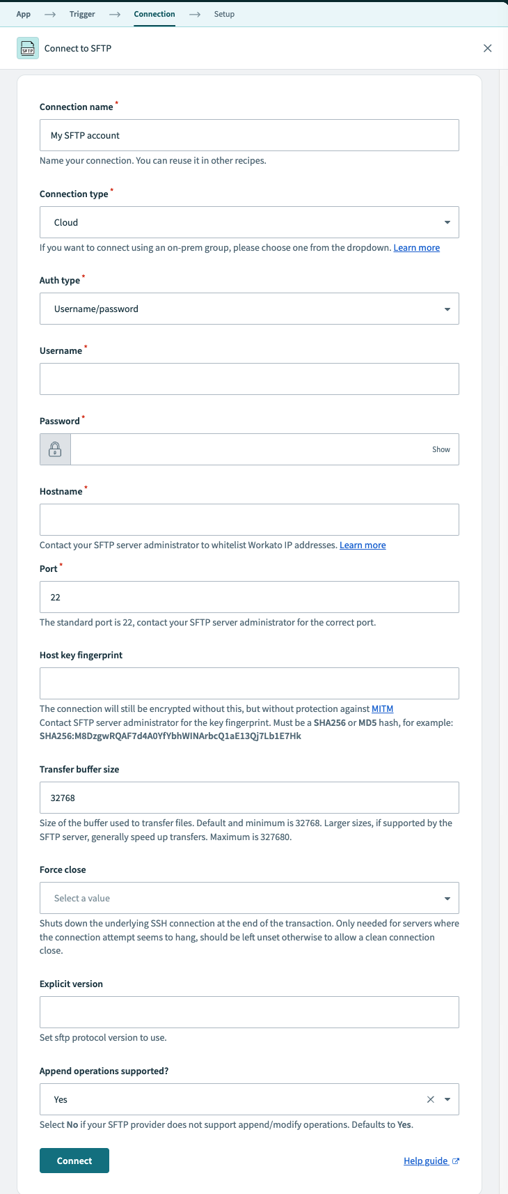

# Connection setup
SFTP connection setup
| Input field | Description |
| Connection name | Given this connection a unique name that identifies which SFTP server it is connected to. |
| Location | Select an existing project for this connection or create a new one. |
| Connection type | If you want to connect using an on-prem group, select the group name from the picklist. Otherwise, to use a direct connection, select Cloud. |
| Auth type | Select which authentication method to use. |
| Username | The user name of the SFTP server to be connected. |
| Password | The password credential to the SFTP server to be connected. |
| Private key | Only for Public/private key authentication type. The SSH private key for the SFTP server to be connected. You must provide the SSH private key in OpenSSH format (opens new window). To save a key in this format, specify SecureShellPrivateKeyFormat.NewOpenSecureShell value as the format parameter. Refer to the Private key example format for more information. |
| Hostname | The address of your SFTP server. |
| Port | The default port for SFTP is 22. |
| Host key fingerprint | A hash of the SSH public key. Workato supports SHA256 and MD5 encryption. For on-premise connection contact SFTP server administrator for the public key in Base64 format. |
| Transfer buffer size | The size of the buffer used to transfer files. |
| Force close | Shuts down the SSH connection at the end of each transaction. Toggle this if your SFTP server connection attempts get stuck. Otherwise, leave it blank. |
