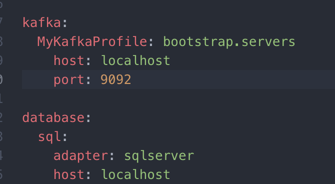

Kafka - No profile found error ​
The OPA displays a No profile found error when it can't locate the specified Kafka profile during execution. This issue often results from a configuration mismatch in the config.yml file.
File configuration mismatchFile configuration mismatch
Check the following in your config.yml to resolve the error:
  • The kafka: block exists
  • The profile name matches exactly, including capitalization
  • The profile is properly nested under kafka: without indentation errors
For example:
yaml
kafka:
  myKafkaProfile:
    bootstrap.servers: "localhost:9092"
The OPA must recognize the profile exactly as defined. Any mismatch in structure or naming prevents the agent from loading the configuration.
