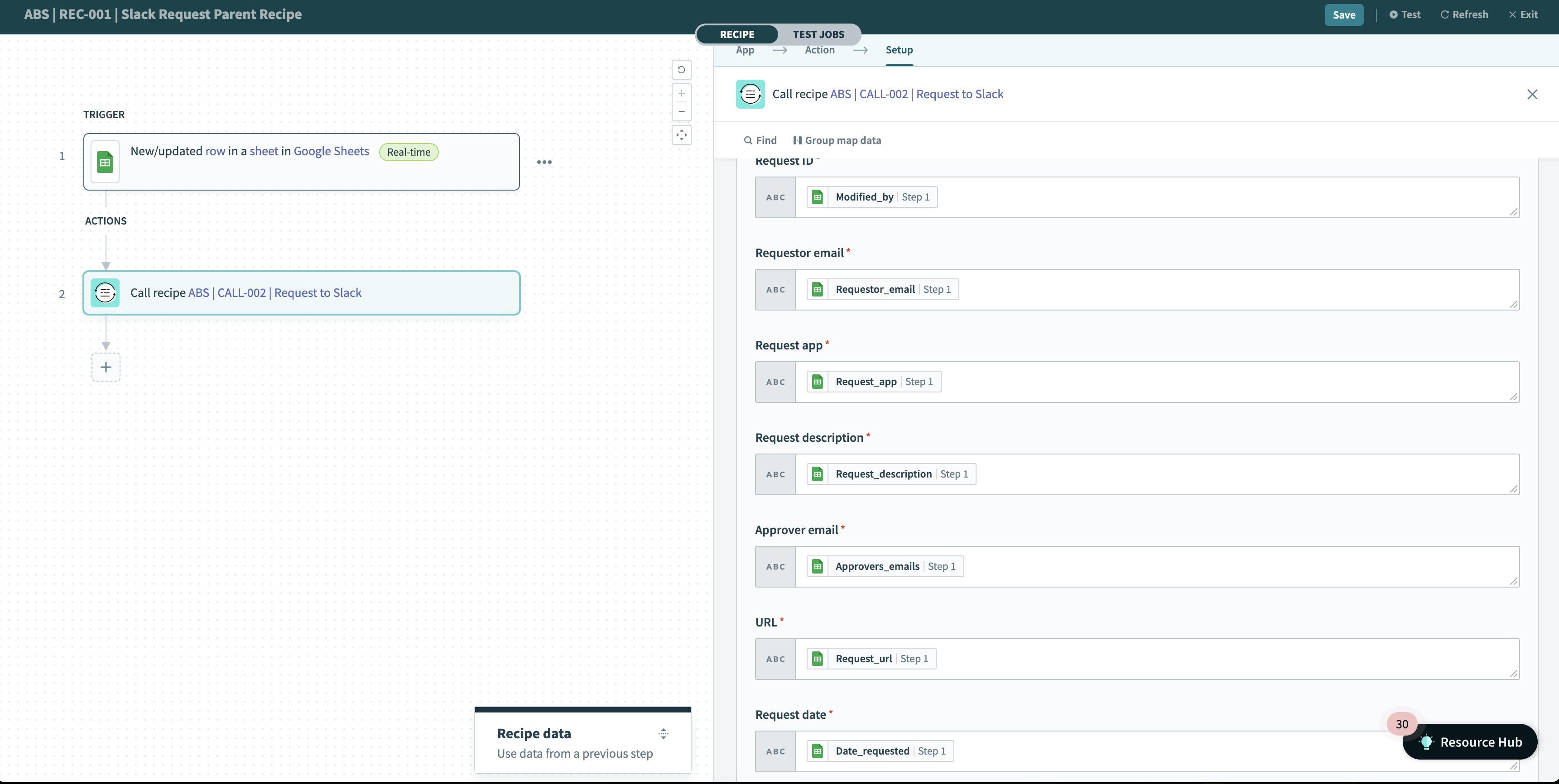

Configure recipe ABS | REC-001 | Slack Request Parent Recipe

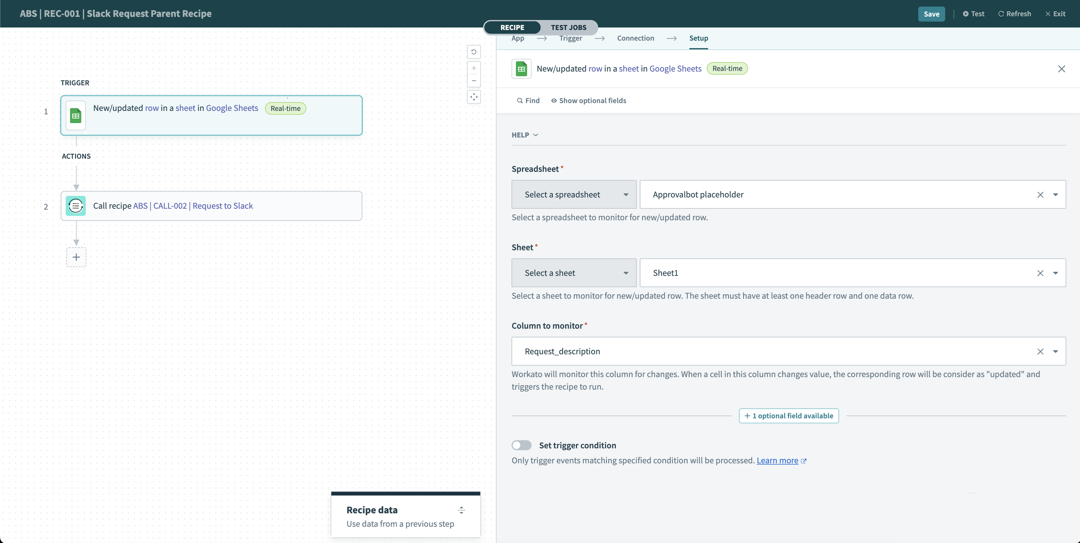

This recipe calls the ABS | Call-002 | Request to Slack recipe when there is a new/updated row in a sheet in Google Sheets.
To configure this recipe:
Optional. If you plan to use an application other than Google Sheets, replace Google Sheets with your chosen application in Step 1.
Map the datapill according to your specific application.
Map the datapill
The input fields in Workato correspond to headers in Google Sheets. Alternate applications should contain similar fields.

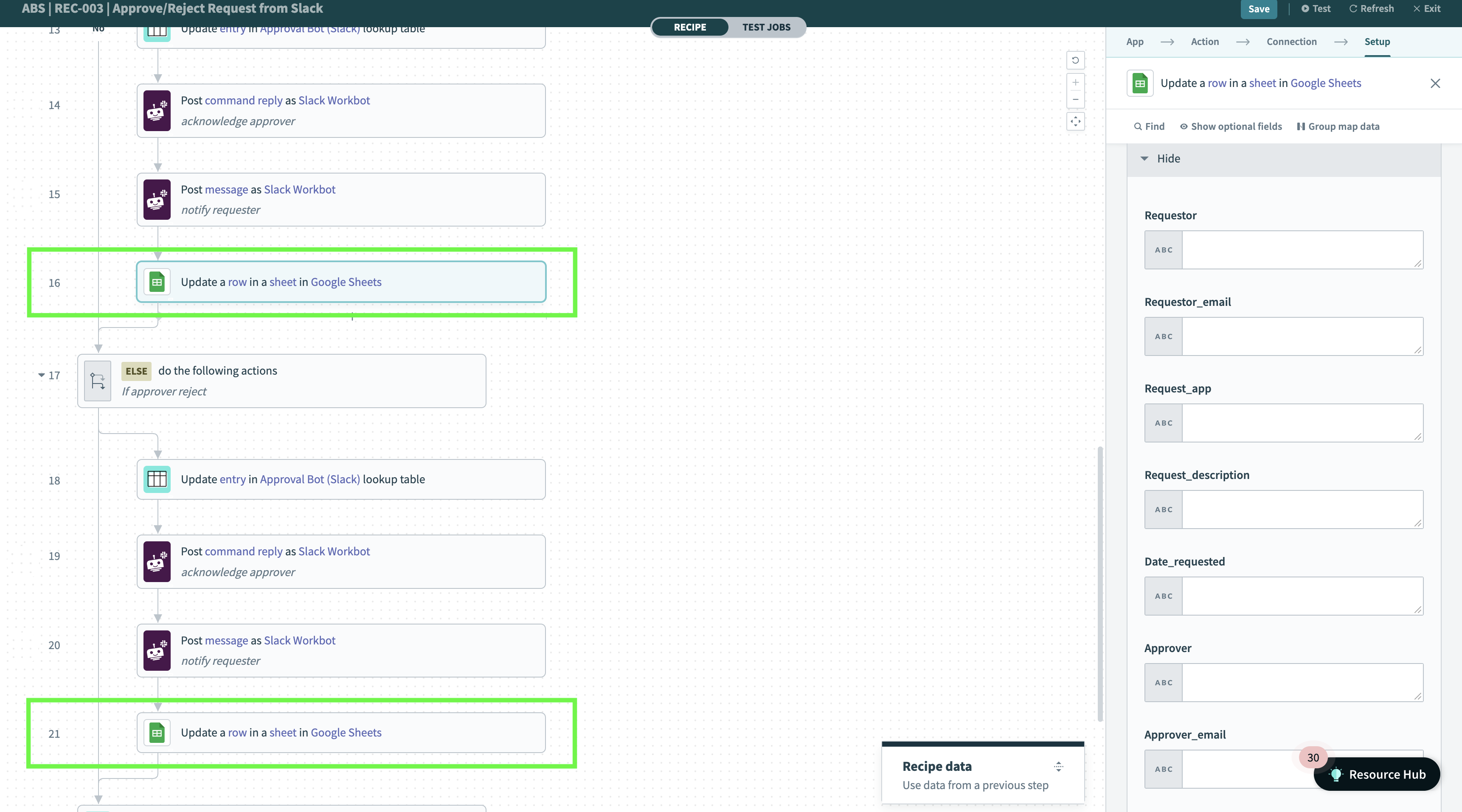

Configure recipe ABS | REC-003 | Approve/Reject Request from Slack
Follow these steps to configure this recipe:
Optional. If you plan to use an application other than Google Sheets, change the sheet connection to your chosen application.
Map the result (approval or rejection) back to your application in Step 16 and Step 21.
Modify Step 16 and Step 21
Optional. If you are not using the Sheet connector, delete Step 11.
