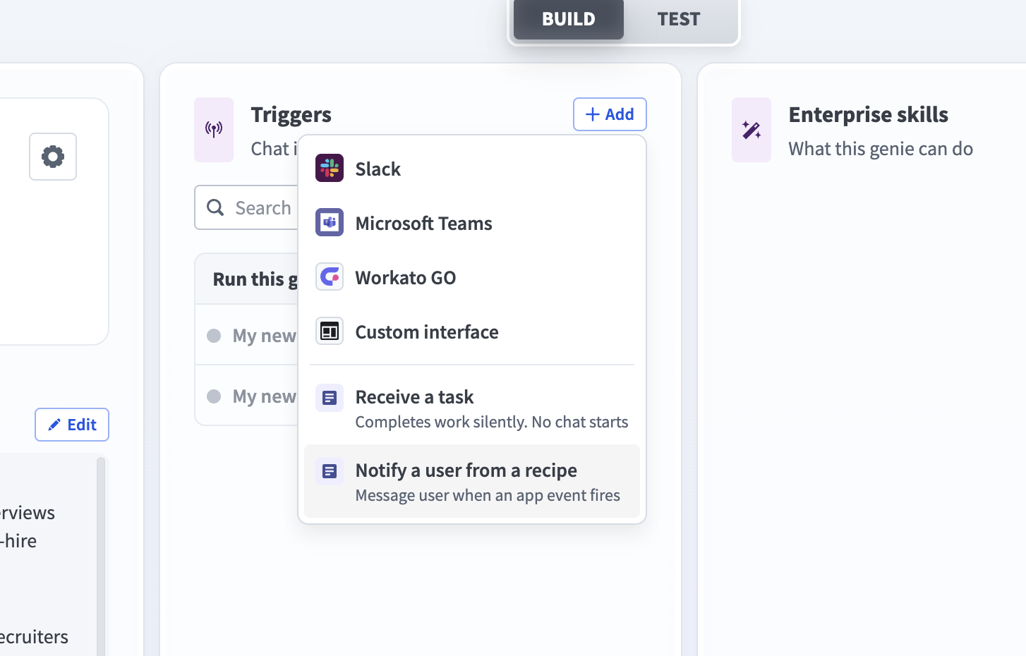

Sign in to Workato.
Go to AI Hub > Agent Studio. A list of your existing genies displays.
Select the genie where you plan to add an app event.
You can create a dedicated recipe from the genie editor, or add the action to an existing recipe.
