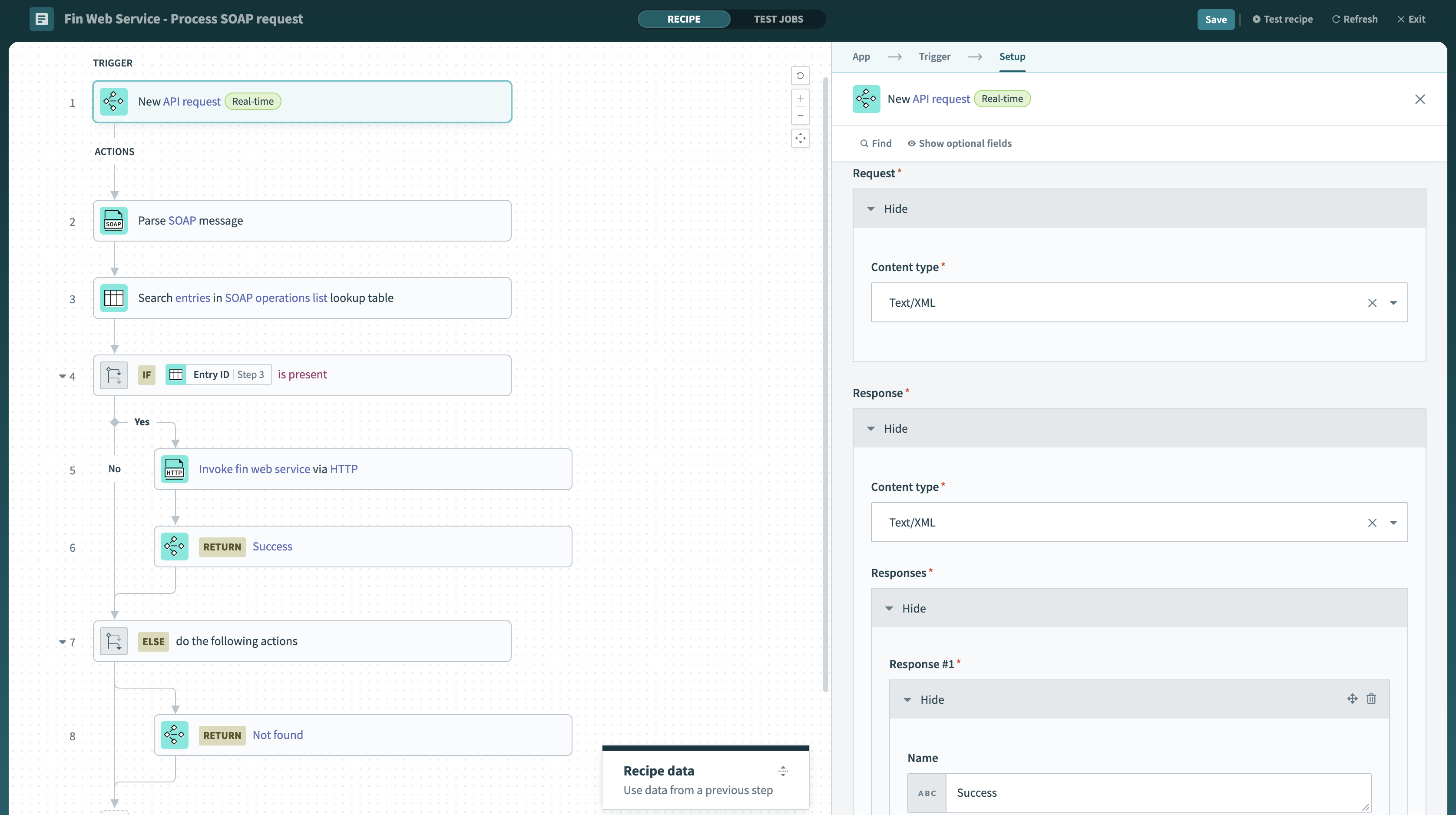

Step 3: Add steps to the recipe
Adding steps to the recipe consists of the following steps:
  1. Step 3.1: Parse and inspect XML payload
  2. Step 3.2: Send a request to the target application
Use XML Tools by Workato to parse the XML body and extract the operation name.
Verify that the incoming request is in the list of approved operations by searching the operation name from the Lookup table.

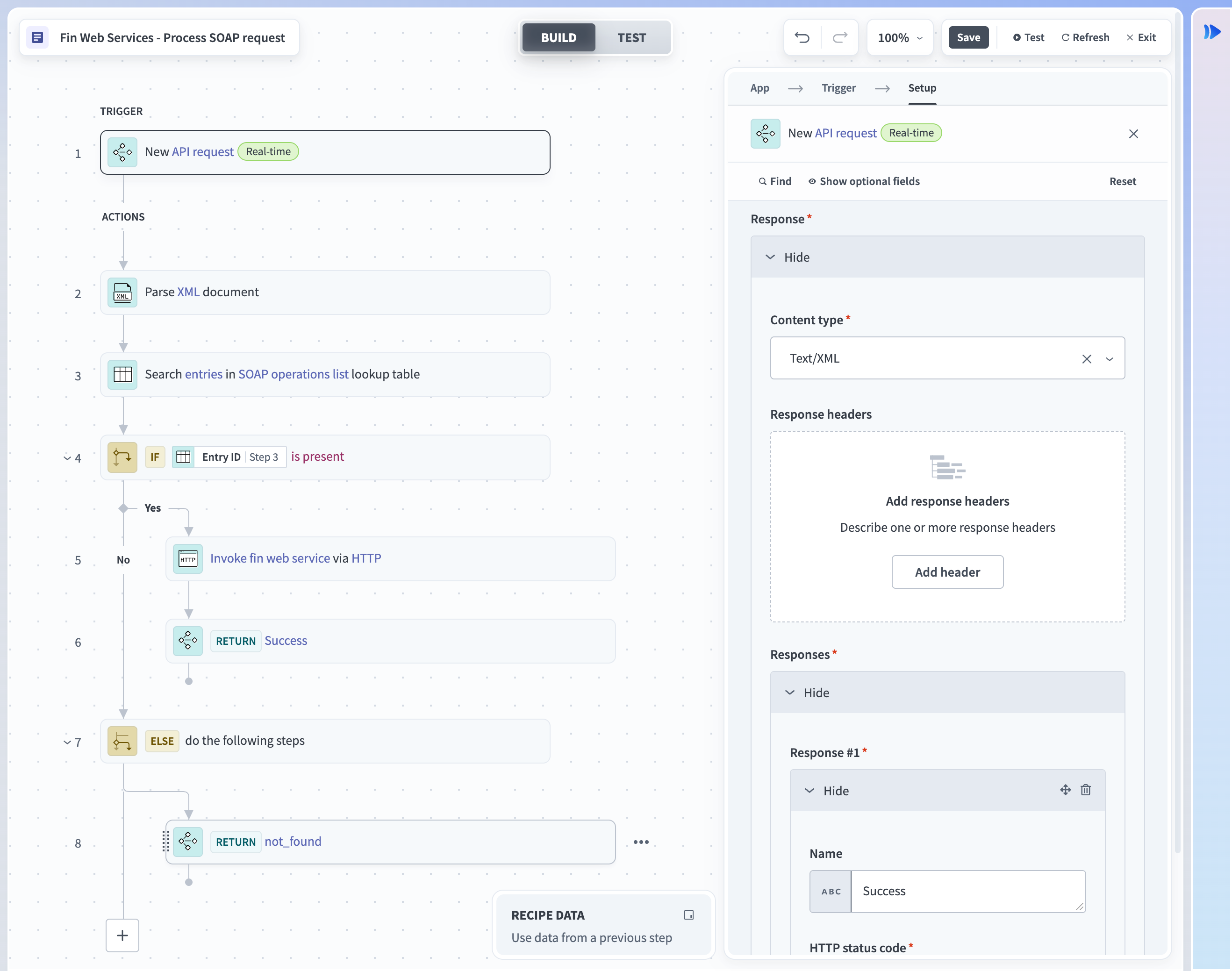

In the If block, Add the desired action. In this example, we'll add an action that sends a SOAP request to a target API hosted on-prem. (Action in an app > HTTP > Send request) Select the HTTP connection that forwards requests through an on-prem group.
After you're finished defining the action(s), select the Return action.
In the Response schema section, map the payload from the on-prem API to the response body.
The last step is to define the Else block, which will run if the request contains an unauthorized operation. Select the return action (Action in an app > API Platform by Workato > Respond to API request) and choose the Not found response.

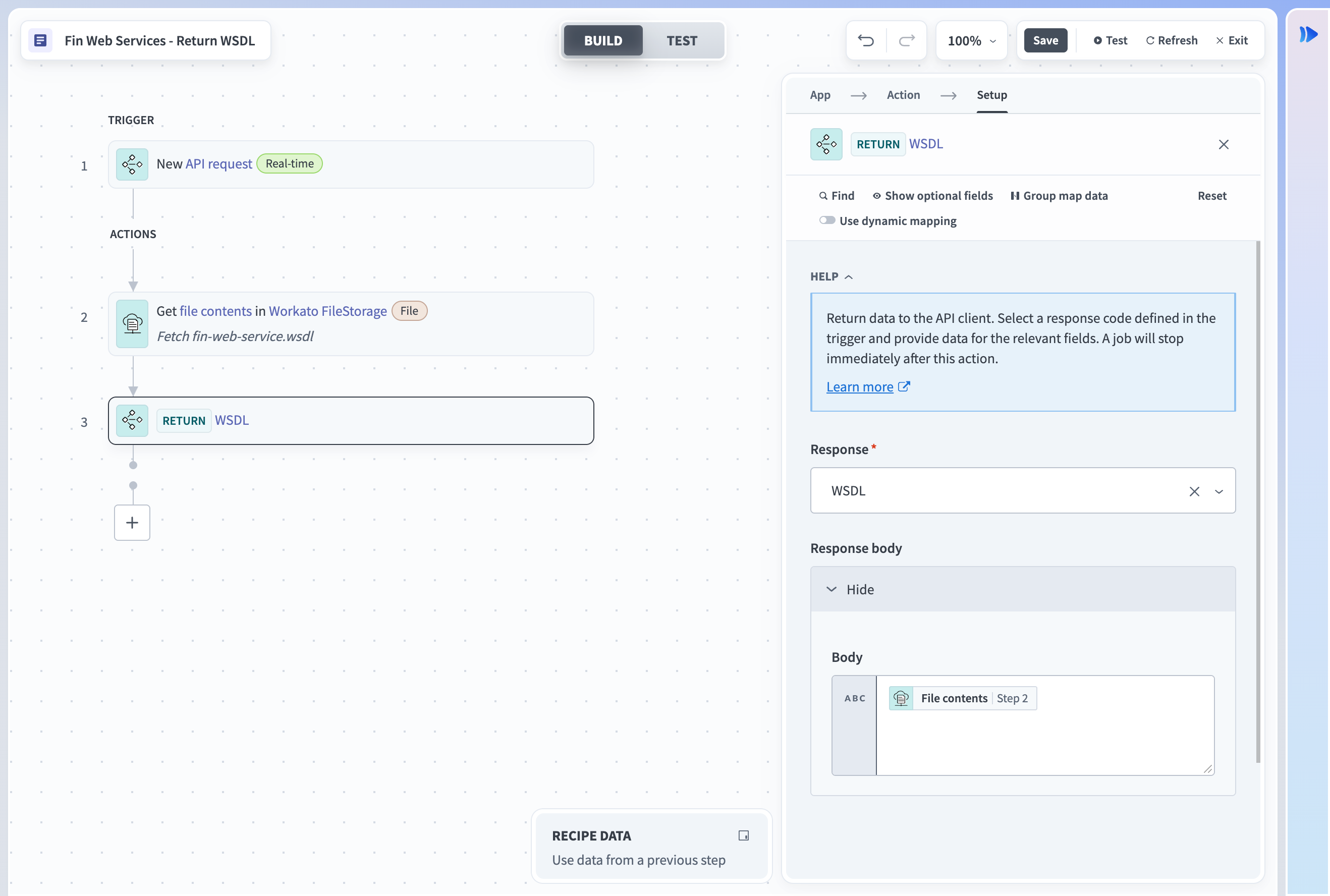

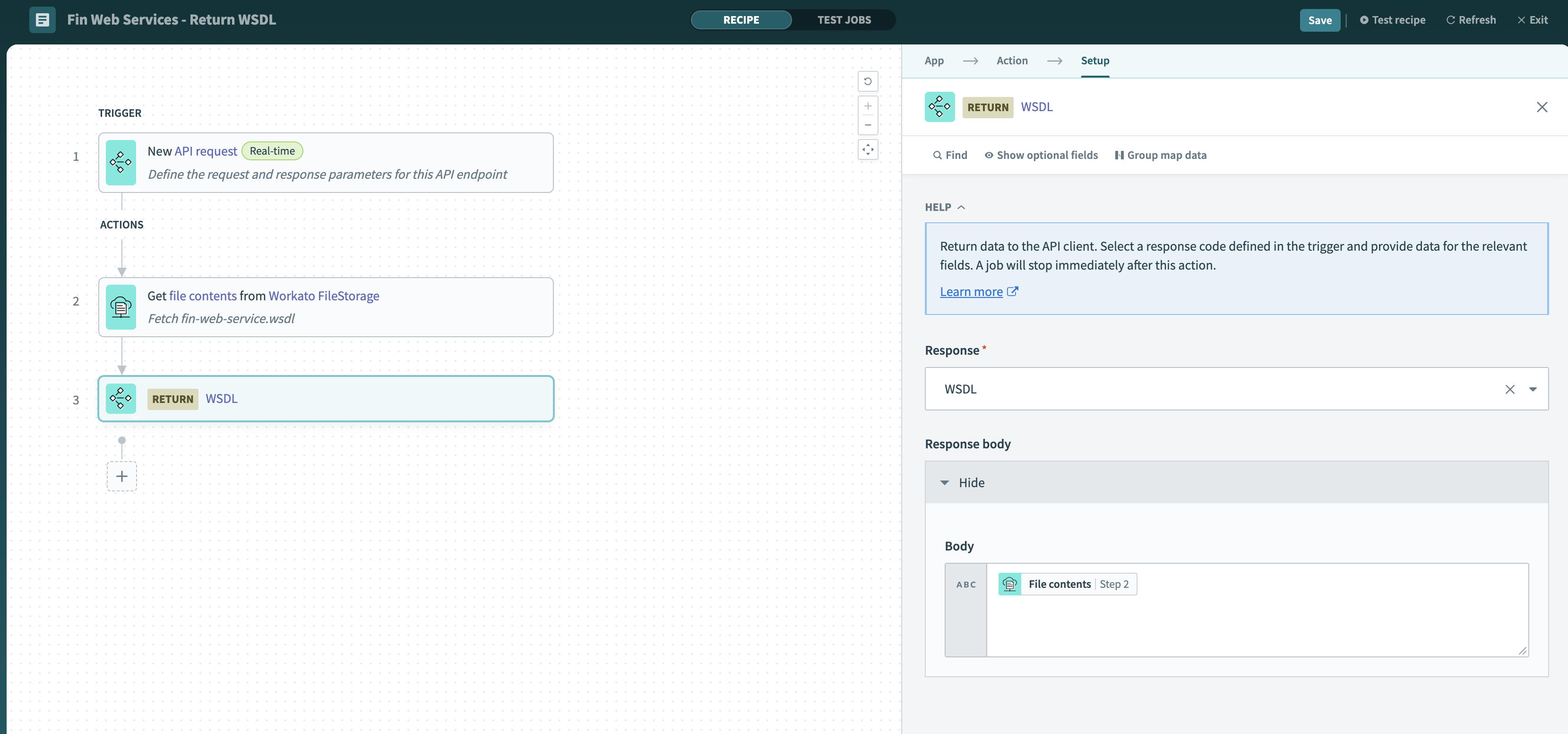

Step 4: Create a separate API recipe to return WSDL
Create a separate recipe that returns a WSDL describing this SOAP API. This WSDL can be stored on Workato using Workato FileStorage.
WSDL API recipeWSDL API recipe

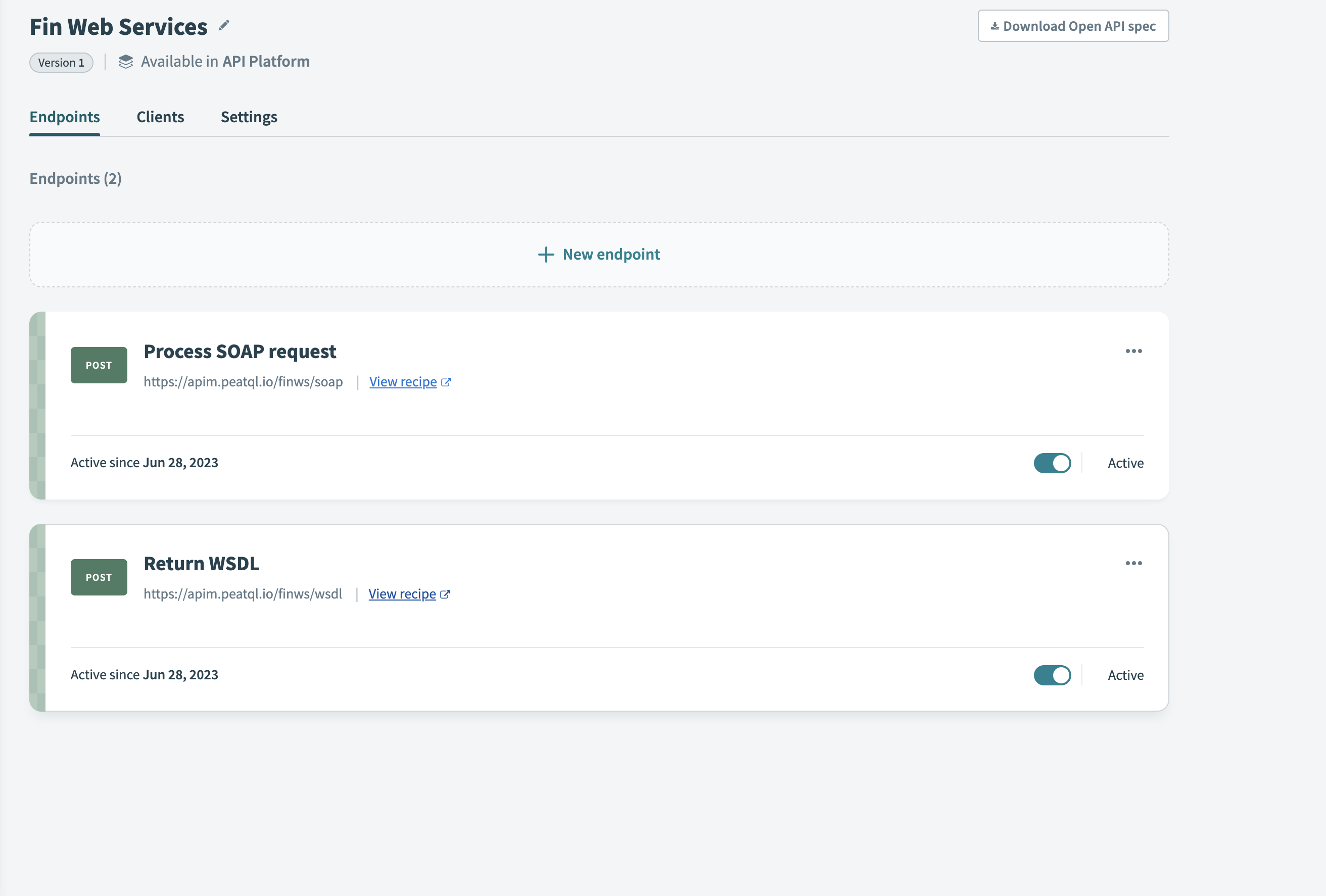

Step 6: Create a SOAP API collection
Create a new API collection using the two recipes. This should create two endpoints - the first to process each SOAP request and the other to return a WSDL.
SOAP API collectionSOAP API collection
