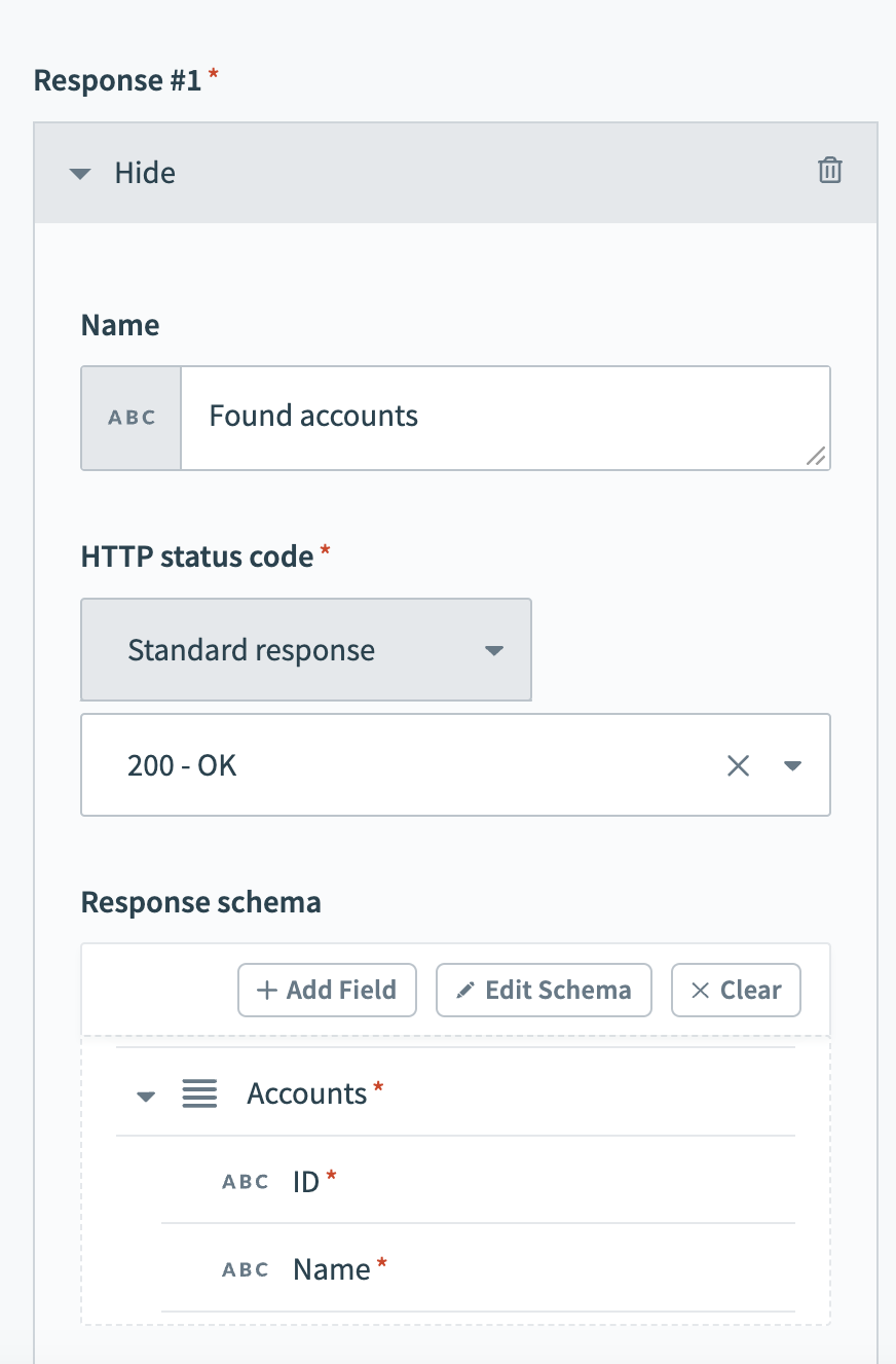

Go to the Responses section and select Add response.
Specify a name for the response in the Response #1 section.
Use the HTTP status code drop-down menu to select a code for the response. Alternatively, you can toggle the input field from Standard response to Custom response and enter a custom HTTP status code from 2xx to 5xx.
Use the Responses section to define the schema of response bodies. You can either upload a sample JSON file or enter the fields manually.
You can create a nested schema response by dragging and dropping properties between parents, including the root. Alternatively, click the Edit schema button and provide the nested schema you plan to use.
Response schemaResponse schema

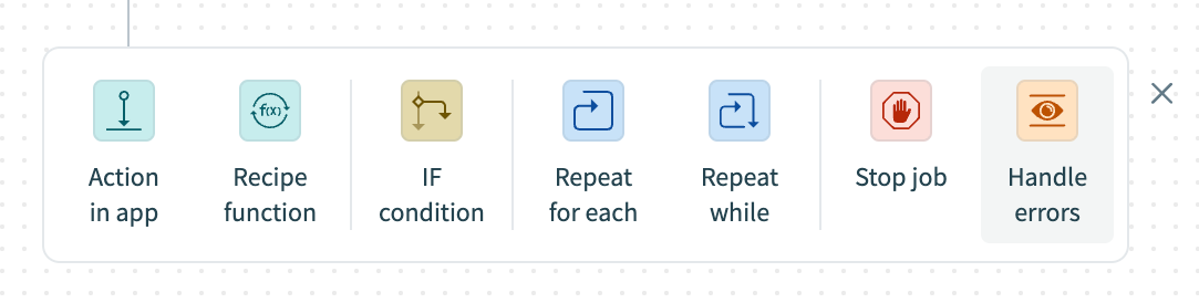

Click + Add step, then select Handle errors.
Add an error handling stepAdd an error handling step

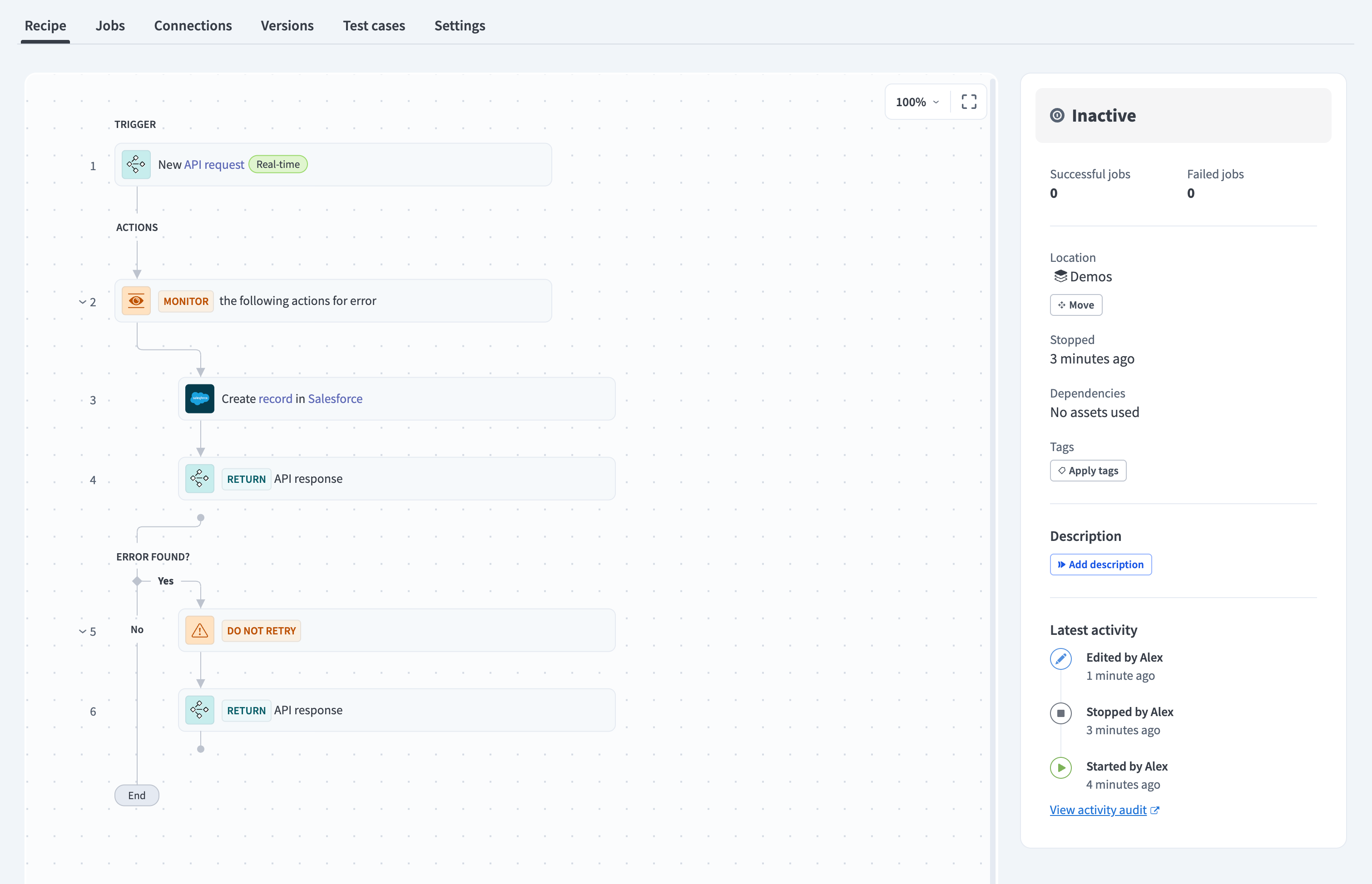

Your API recipe is ready to test and implement.
A configured API recipeA configured API recipe
