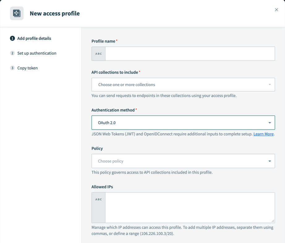

Create a new API client, or select an existing API client.
Select OAuth 2.0 as the authentication method.
Access profile - OAuth 2.0 Authentication methodOAuth 2.0 Authentication method

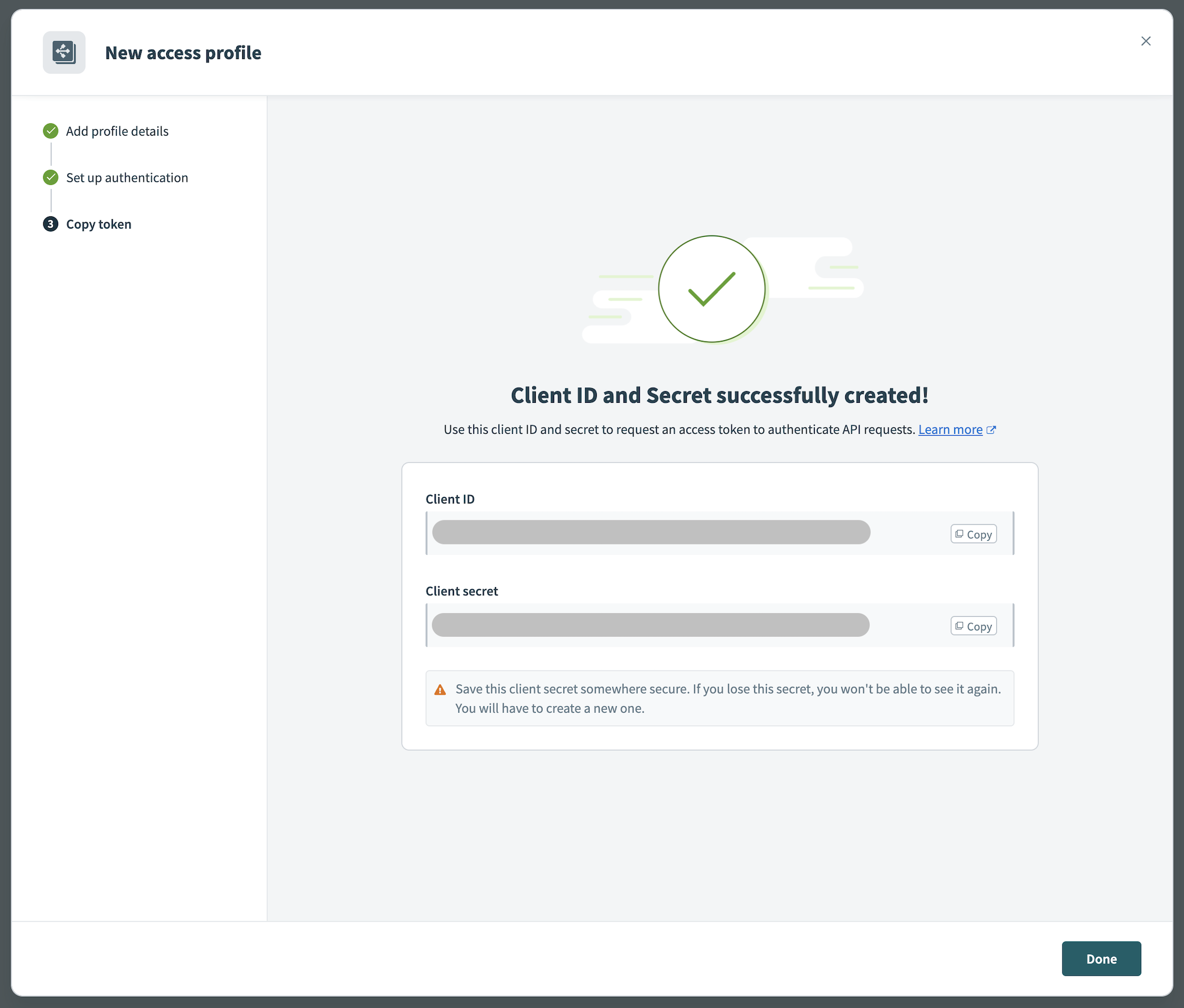

Create a new API key for the client. Workato displays the Client ID and Client Secret credentials when you generate the key. Copy and save both values.
Access profile - OAuth 2.0 CredentialsOAuth 2.0 Credentials

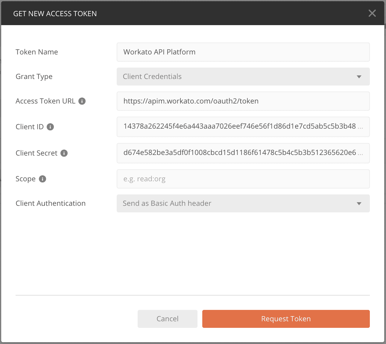

You can also use tools like Postman to generate an access token.
Request access token with PostmanGenerate access token with Postman
