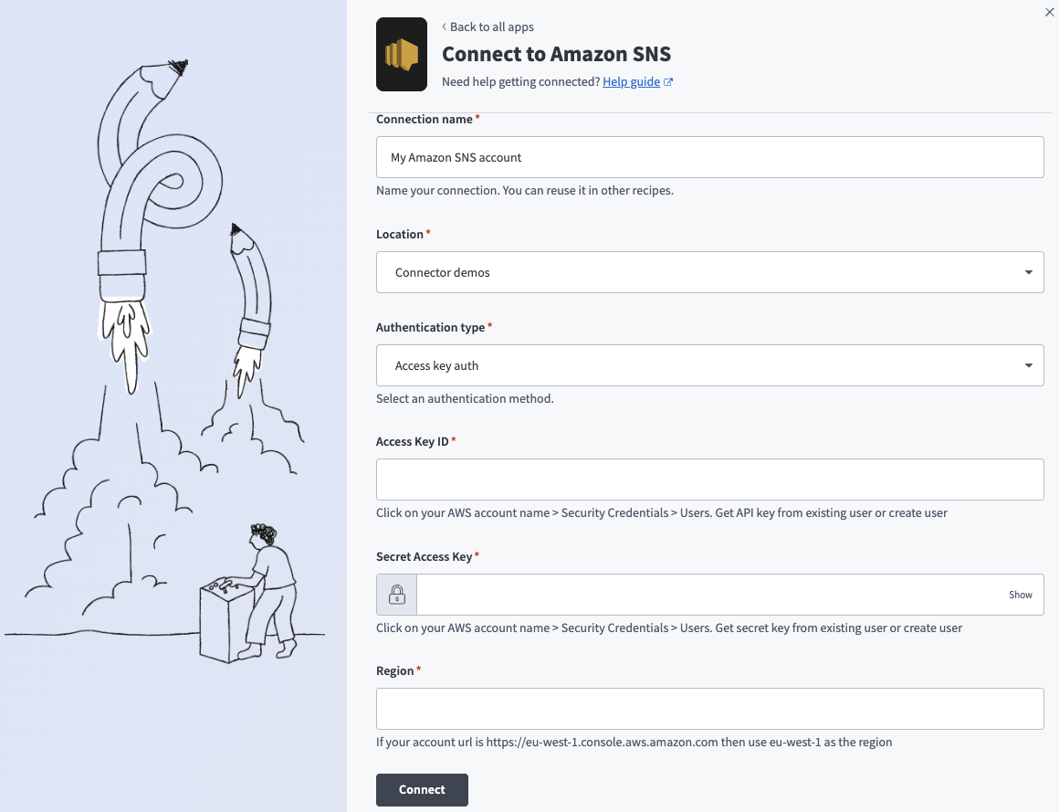

Amazon SNS connection setup
Use the Location drop-down menu to select the project or folder where you plan to store the connection.
Use the Authentication type drop-down menu to choose Access key auth.
Enter the Access key ID. Go to AWS account name > Security Credentials > Users to retrieve this value. This is the IAM user's access key ID.
Enter the Secret Access Key from the same page.
Enter the Region of the SNS account. For example, if your SNS URL is https://eu-west-1.console.aws.amazon.com, use us-east-1 as the Region.

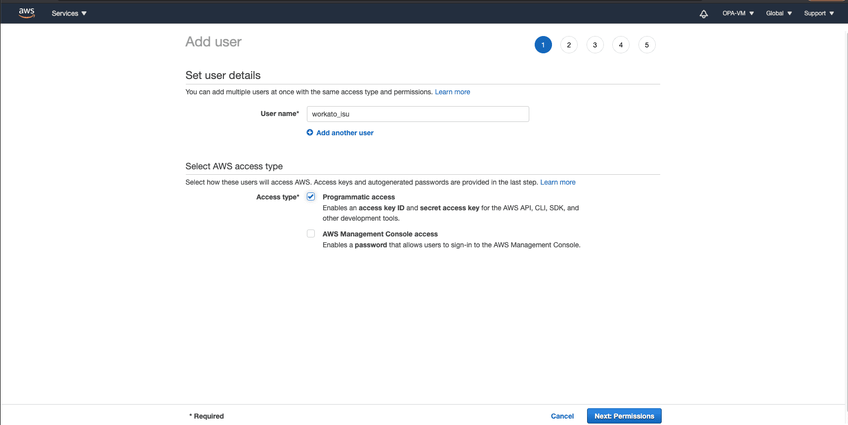

Click Add user.
Create IAM user
Set the username. Ensure that Programmatic access is selected.
Set username

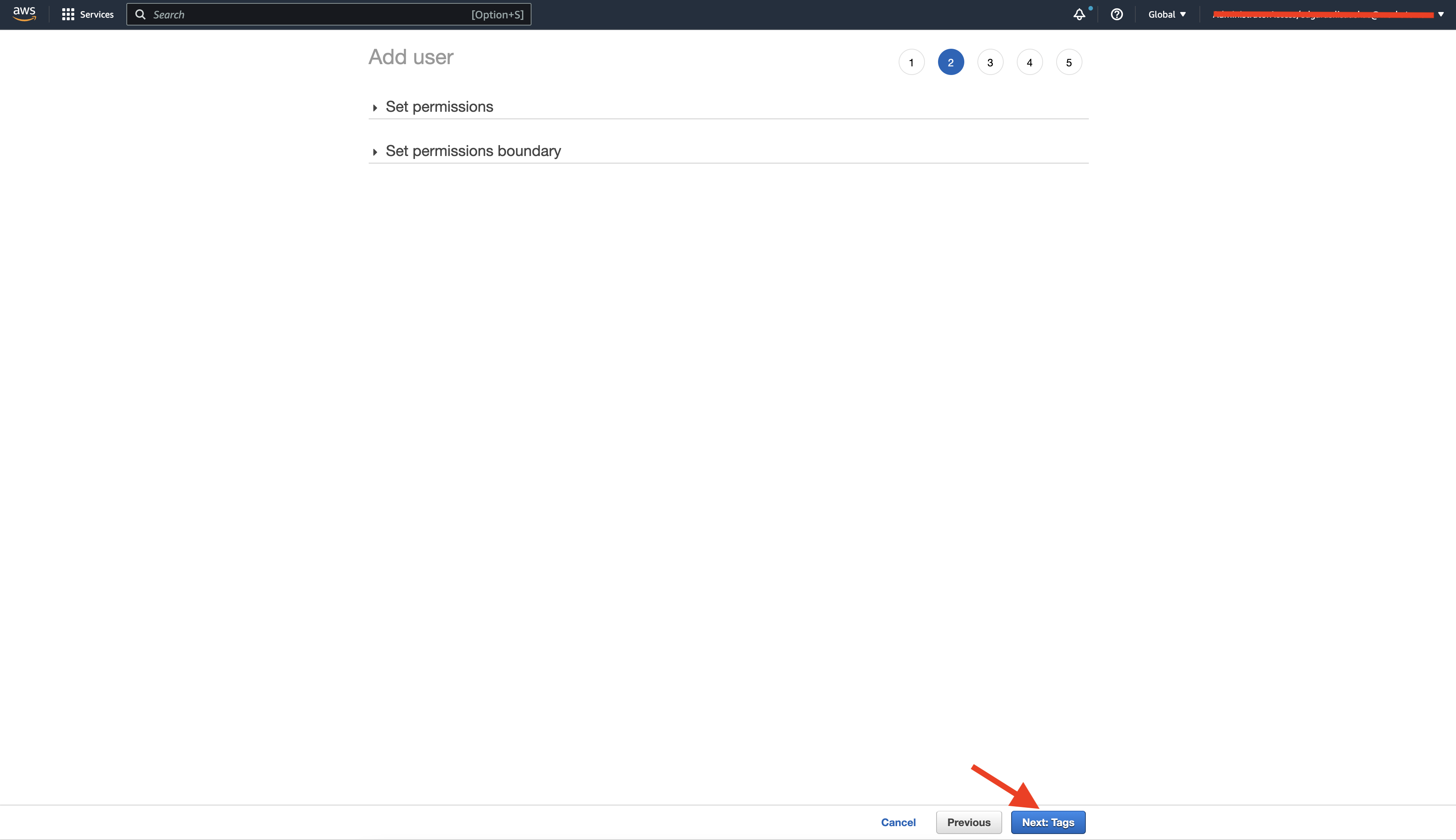

Skip selecting policies in the Add permissions view. You configure permissions and polices in a later step.
Skip setting permissions
Click Next.
Add Tags. Review the IAM user configuration.
USER HAS NO PERMISSION
You may see a warning that this user has no permissions. This is expected. You will assign permissions in a later step.

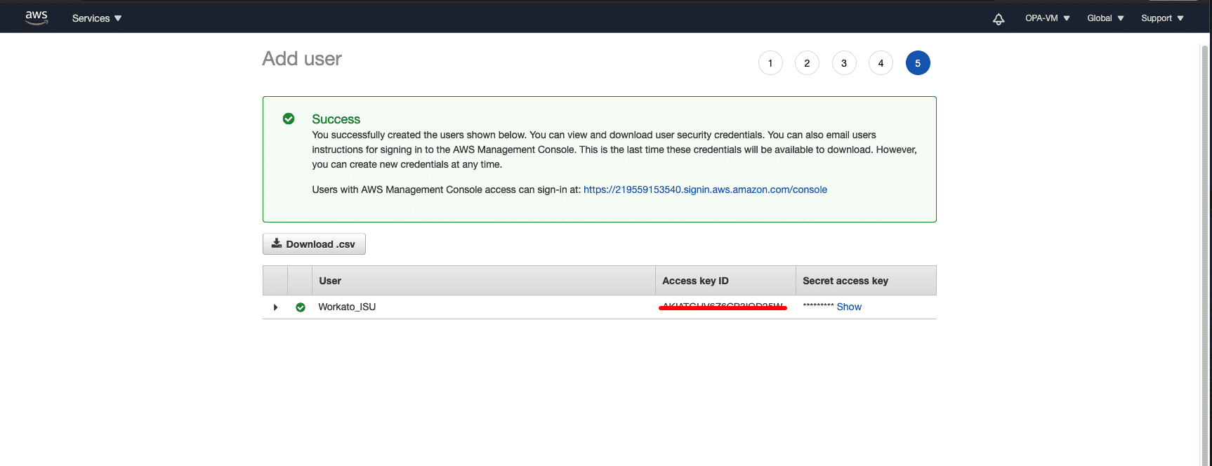

Download or copy the Access key ID and Secret access key. Use these credentials to connect to Workato.
Save access key credentials

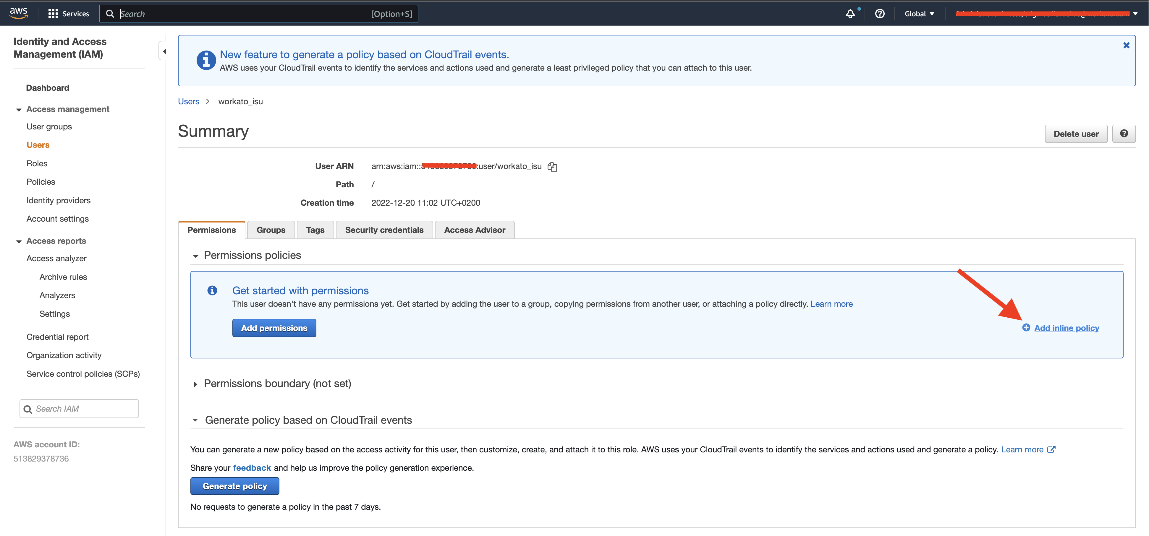

Return to Identity and Access Management (IAM) in your AWS console.
Select Users from the left panel and select the user that you created.
Click Add inline policy.
Update IAM user policy
Adding permission for ISU

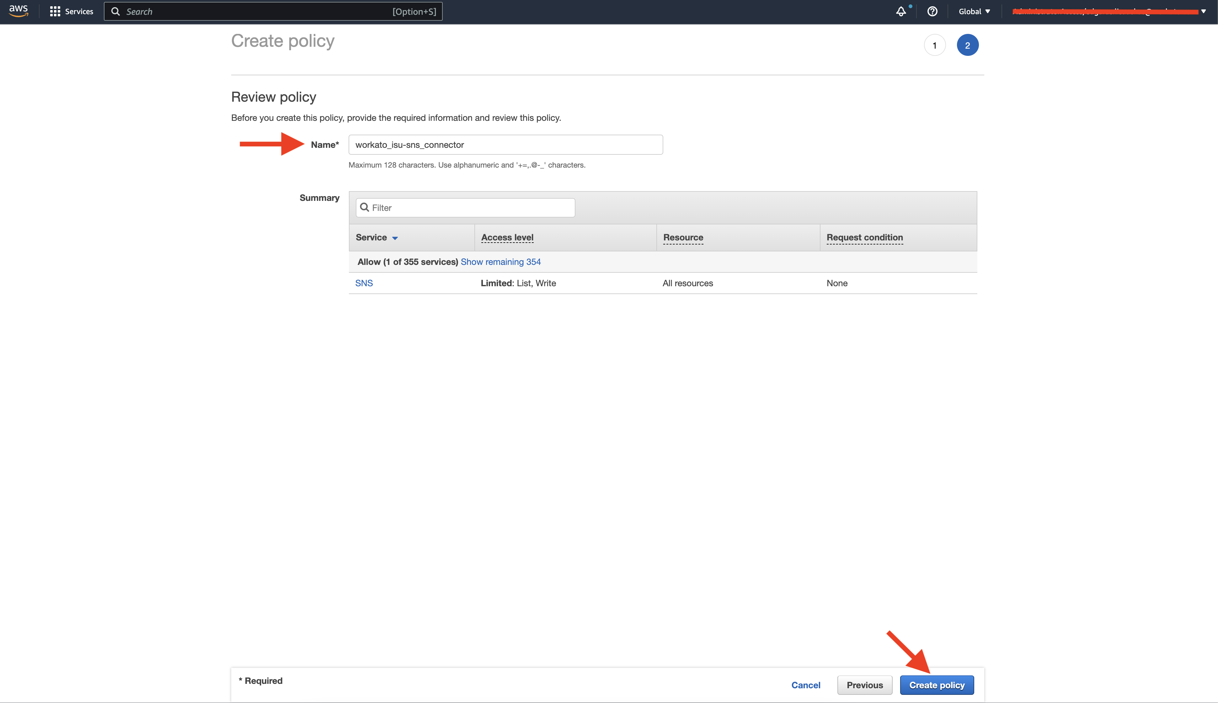

Review IAM user policy
Click Review policy.
Enter a name for the policy in the Review policy view. For example, workato_isu-sns_connector.
Click Create policy. Use the access key credentials you saved earlier to connect to Workato.
Create policy
