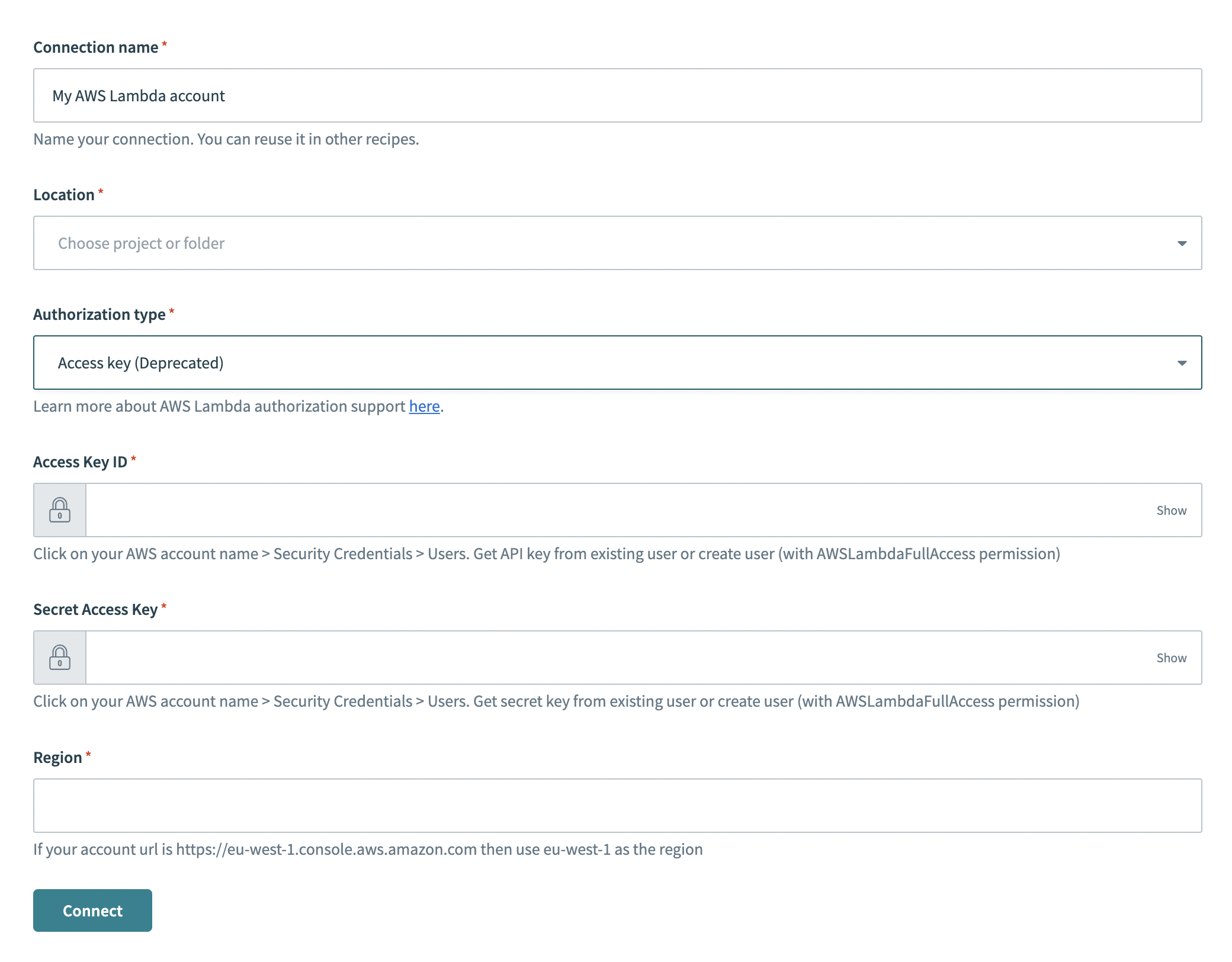

Connect to AWS Lambda using IAM user access key
Note that using an IAM user access key to connect to AWS Lambda is allowed but deprecated. You must provide the user credentials for this authentication method.
Input fields for access key
  • Fields for access key authentication.
    • Connection name
    • Give this connection a unique name that identifies which AWS Lambda instance it is connected to.
    • Location
    • The Workato project that requires the connection.
    • Authorization type
    • Select Access Key.
    • Access key ID
    • The ID of the user.
    • Secret access key
    • The secret of the user.
    • Region
    • Provide the region for this AWS Lambda account.
Authorization method - Access KeyAuthorization method - Access key

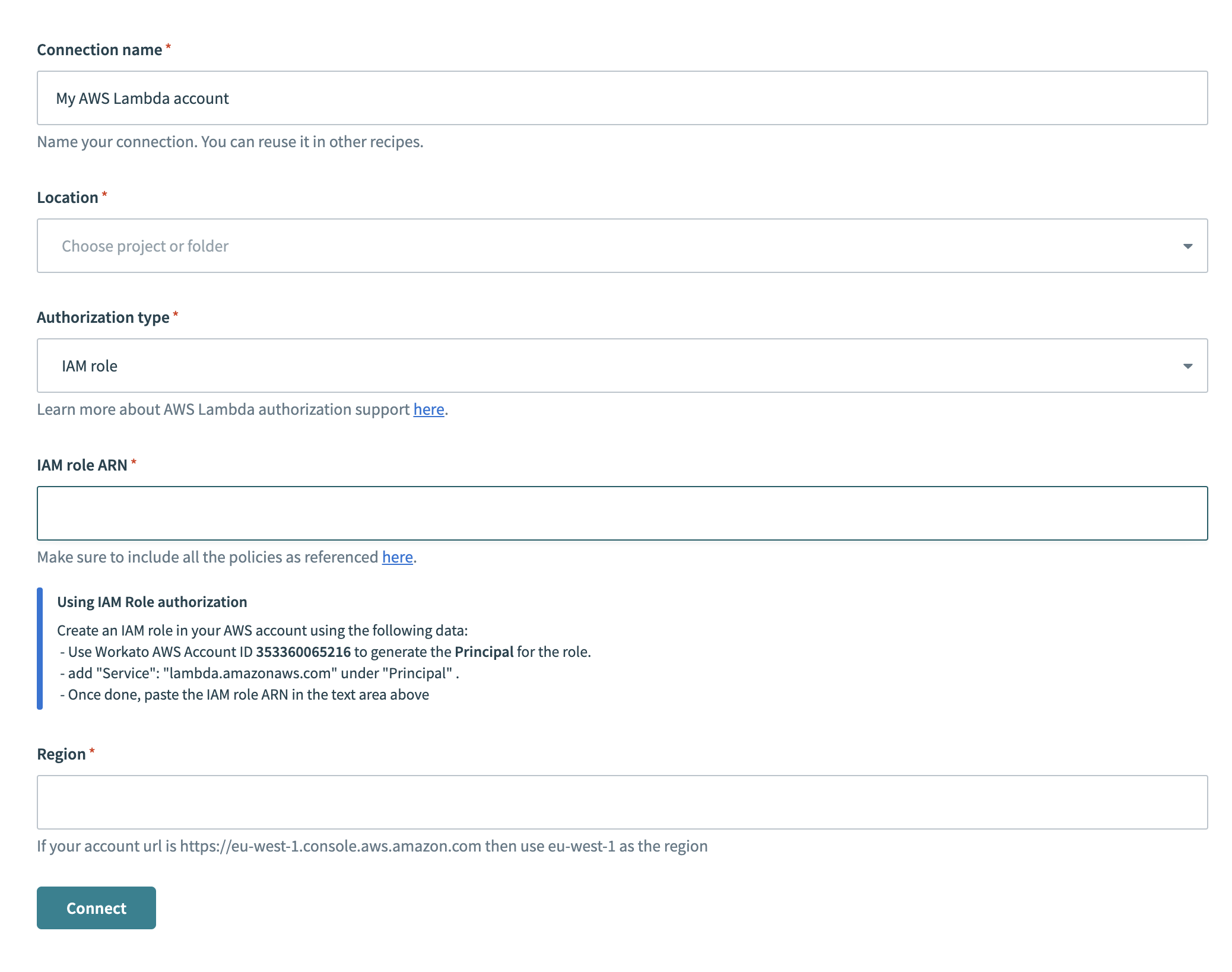

Connect to AWS Lambda using IAM role
You can provision a Workato IAM role to connect to AWS Lambda. Provisioning a dedicated IAM profile allows the owner of the AWS Lambda instance to grant Workato access to AWS resources without sharing AWS security credentials. It also helps to maintain permission boundaries, including controlled access to specific AWS folders and actions that are permitted by the third-party application (for example, Workato).
Refer to the IAM role-based authentication for AWS page for instructions on how to create an IAM role for Workato and retrieve your Amazon resource name (ARN).
Input fields for IAM role
  • Fields for IAM role authentication.
    • Connection name
    • Location
    • Select IAM role.
    • IAM role ARN
    • The IAM role ARN.
      Note: Workato will generate a unique external id (for example, workato-user-84762). This value is different for every Workato user and must be provided when creating an IAM role in AWS Lambda.
    • Region
Authorization method - IAM roleAuthorization method - IAM role

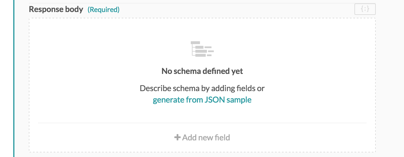

Output schema definition
When working with Lambda functions as triggers or actions, you must define the output schema for each callable function. Each function's response is variable. This sample output schema is used to build the output datatree. This datatree allows you to use the data returned from the Lambda function in subsequent recipe actions.
To define the output schema, provide a sample response to the Function output input field. This should describe the data structure and schema of the output. There are 2 ways to configure this input field:
  • Use a sample JSON
  • Manually define schema using the schema designer widget
Schema DesignerFunction output input field

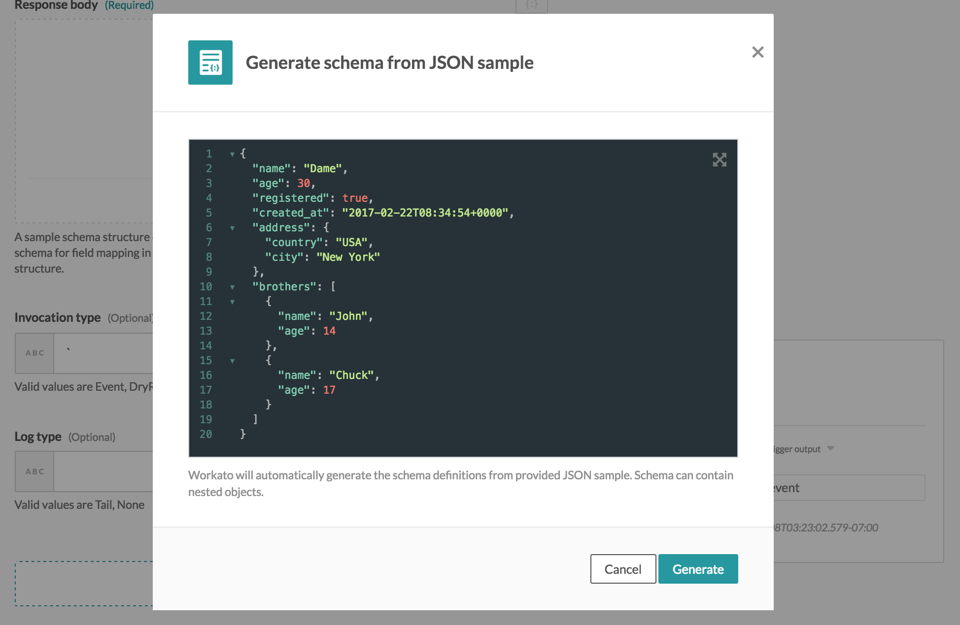

The following example focuses on defining the output schema via sample JSON. Clicking Use JSON displays the following schema designer widget.
Sample JSON pop upSchema designer widget

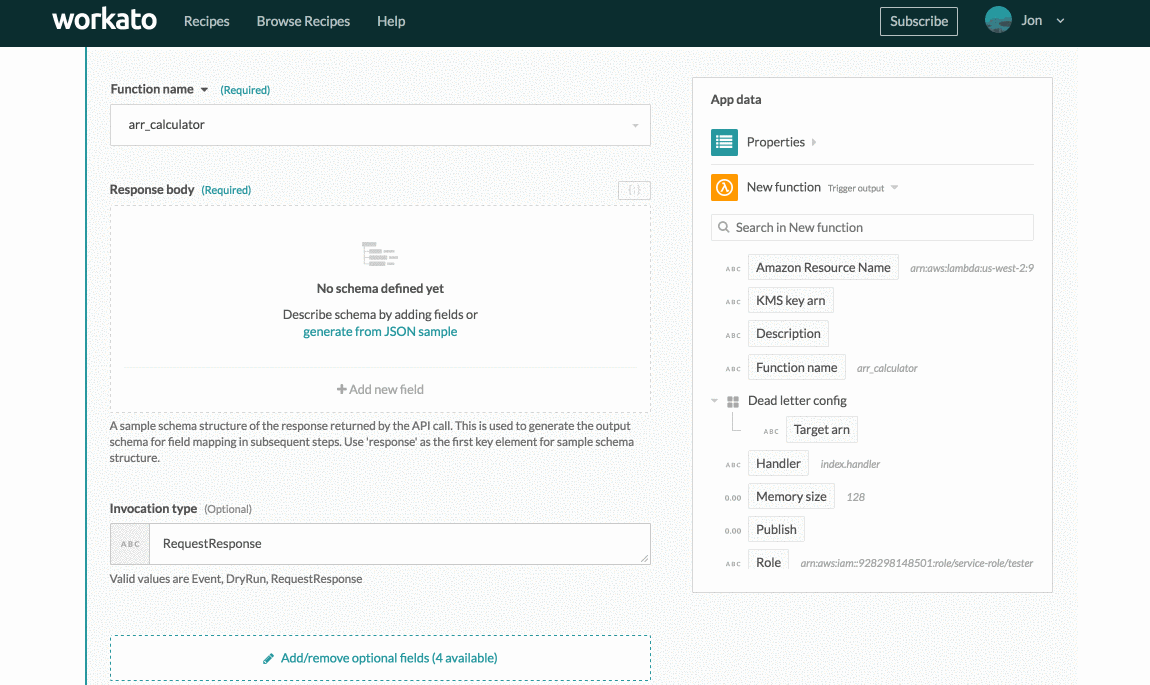

Insert the output JSON, click Next to review the data, and click Generate. This generates the following output datatree:
JSON response output datatreeJSON body output datatree

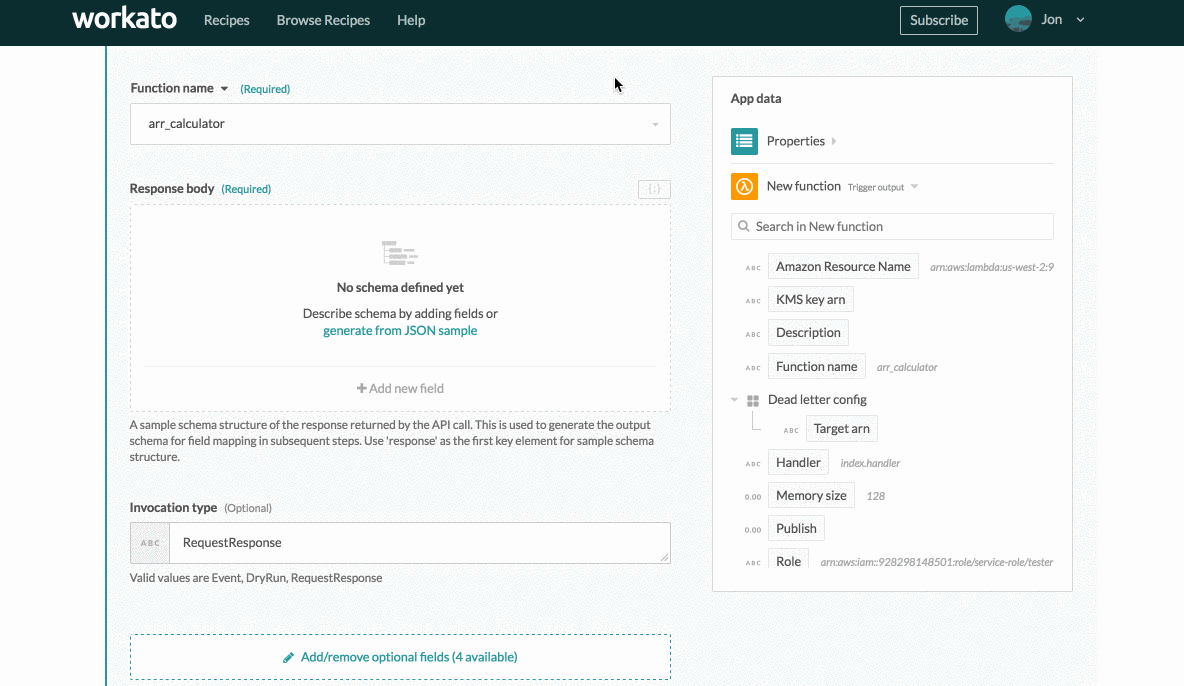

Insert the output JSON and click Generate. This generates the following output datatree:
Primitive response output datatreePrimitive response output datatree
