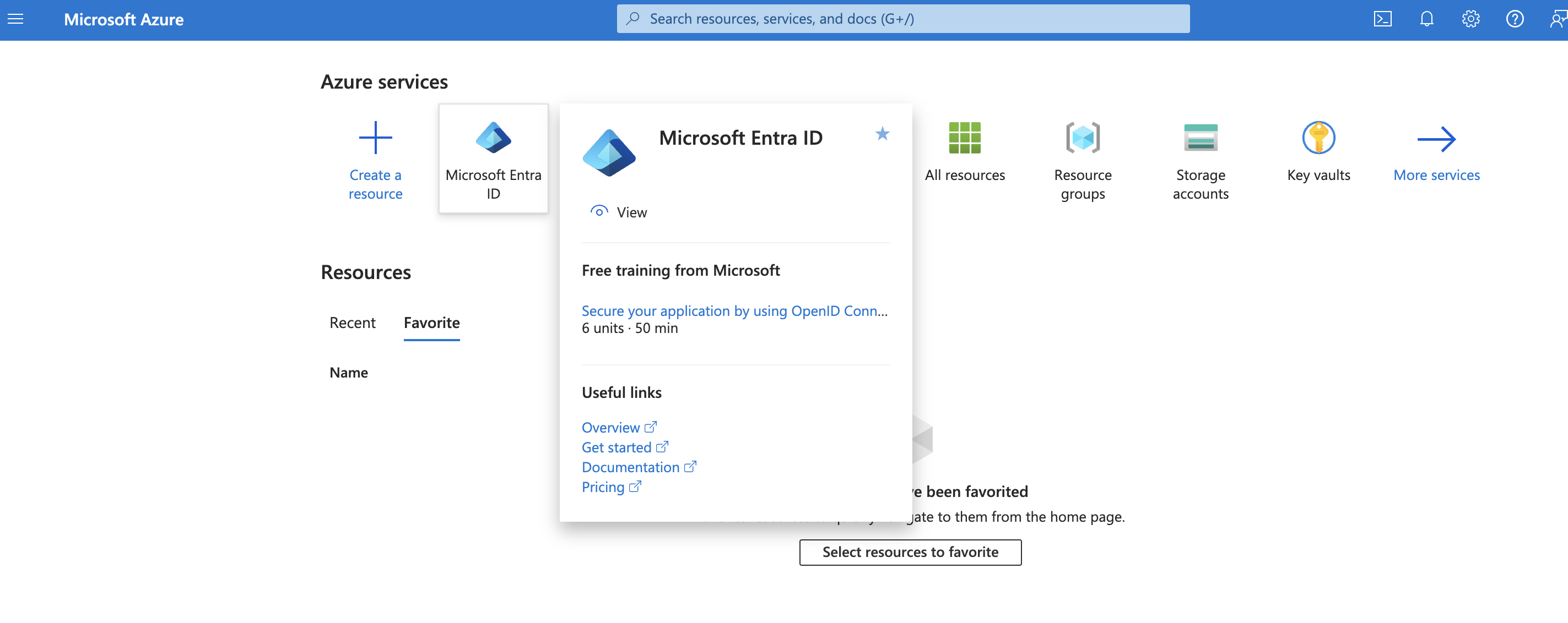

Go to Microsoft Entra ID.
Go to Microsoft Entra IDAccess Microsoft Entra ID from your Azure portal

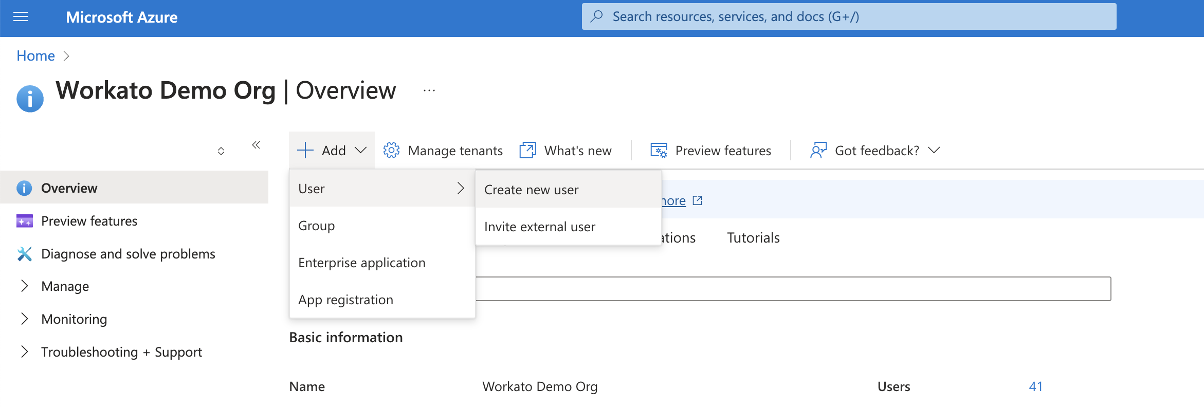

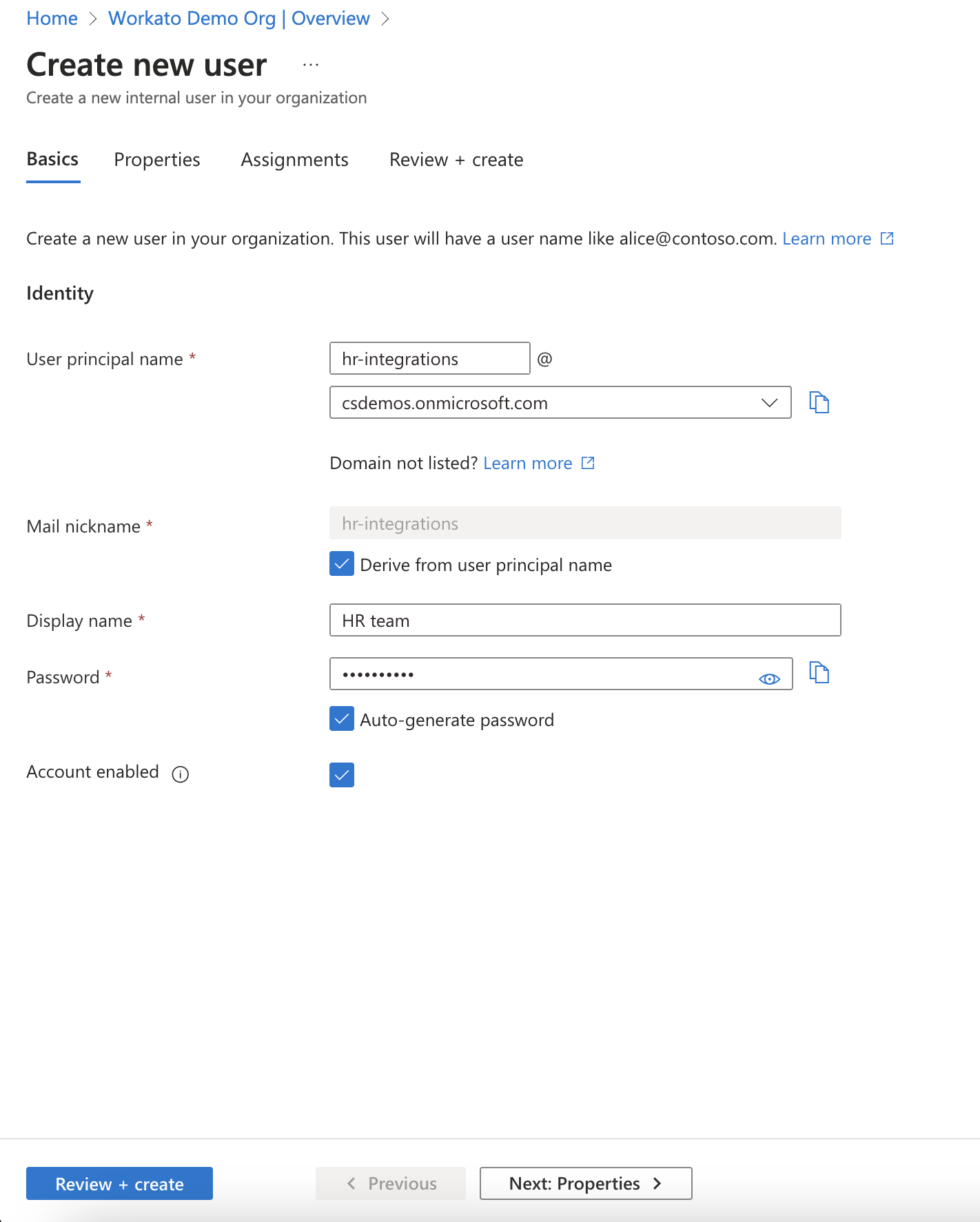

Select Add > User > Create new user.
Select new userCreate a new user
Enter the Identity details for the ISU, such as the User principal name, Display name, and Password.
Fill in new user detailsProvide details for the new user.
Select Review + create > Create to create your ISU.

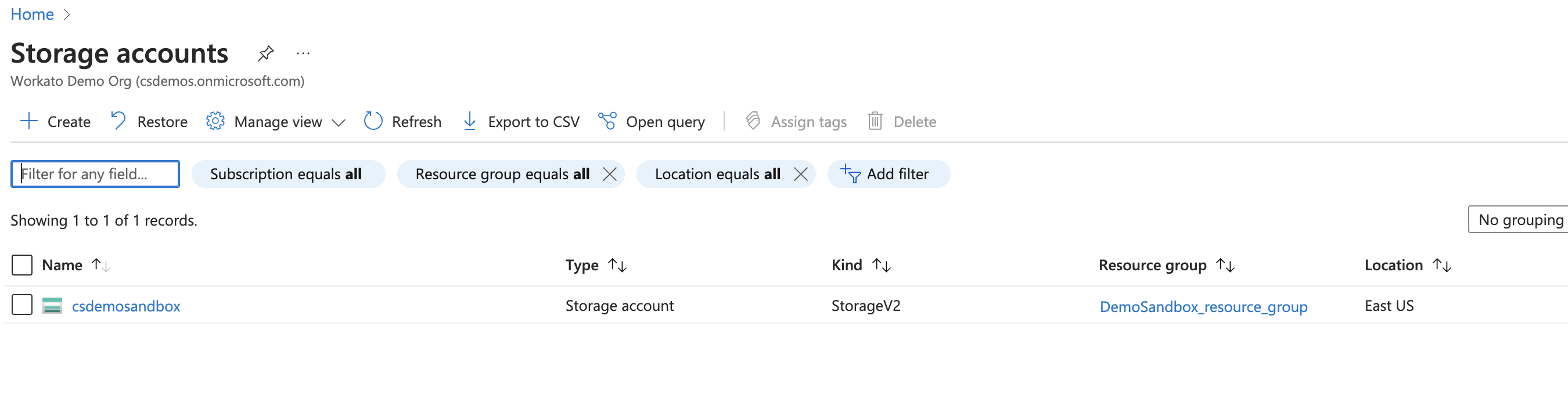

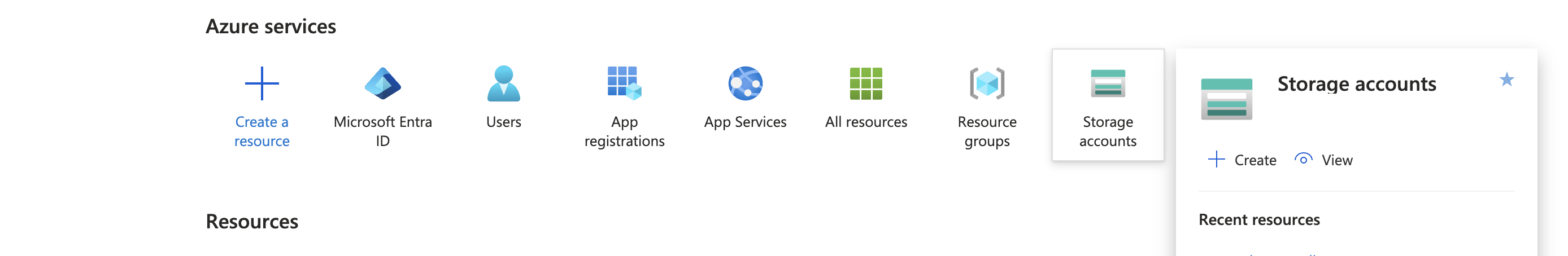

In your Azure portal, go to Storage accounts.
Go to storage accountsNavigate to Storage accounts from your Azure portal

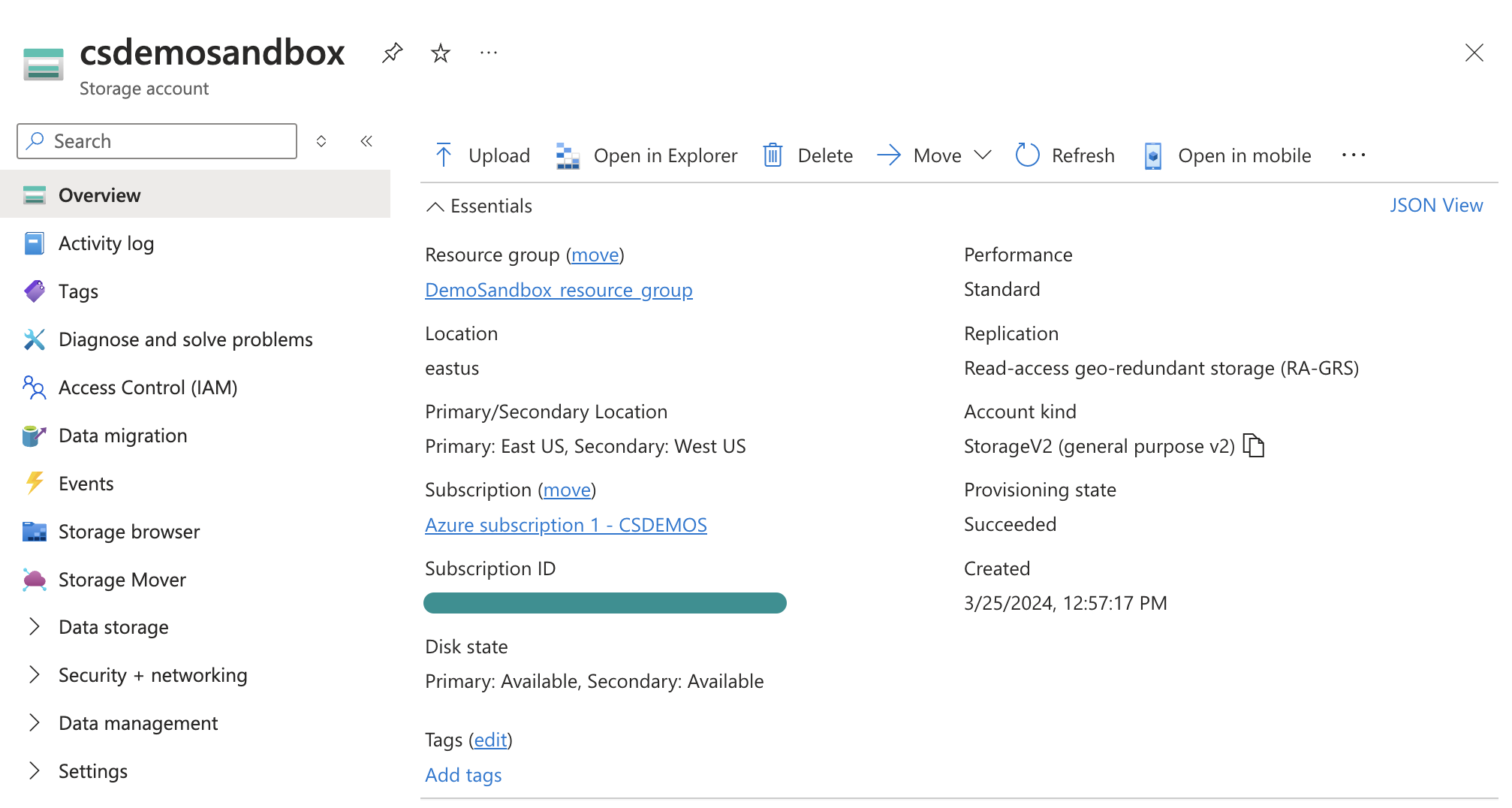

Select your Storage account.
Go to specific Storage AccountSpecify the Storage account to grant access to Workato

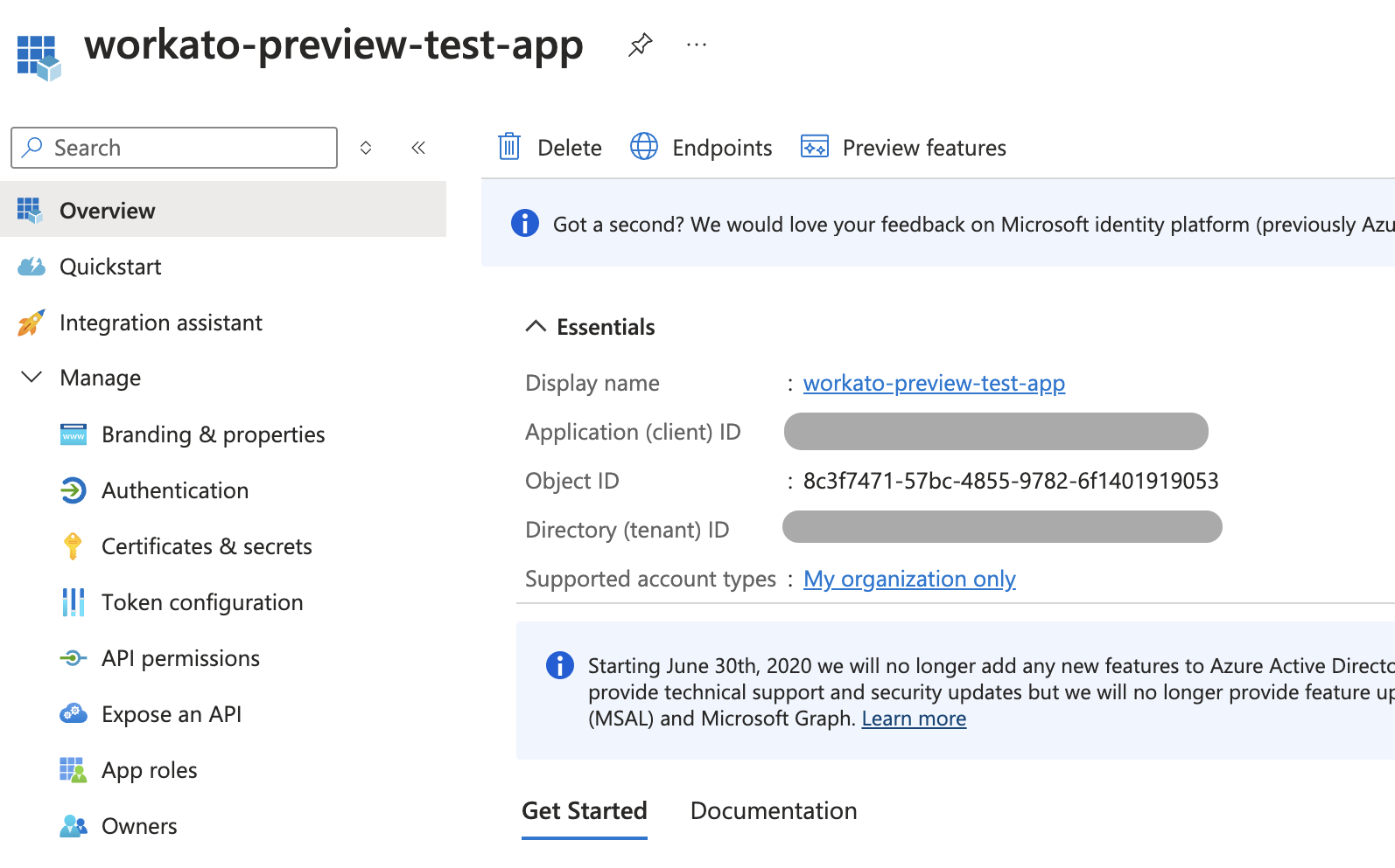

Go to App registrations in your Azure portal.
Navigate to App registrationsGo to App registrations in your Azure portal

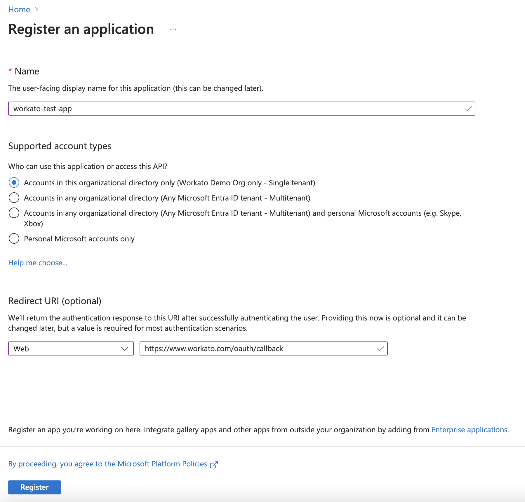

Select New registration.
Enter the Name of the application you plan to register.
Register an applicationRegister an application
Select the Supported account types that can use the application and access the API.
Select Web as the platform and enter https://www.workato.com/oauth/callback in the Redirect URI field.
Click Register to create the application and view the Overview page.
Record the Client ID and Tenant ID for connection setup in Workato.
Record IDsRecord IDs

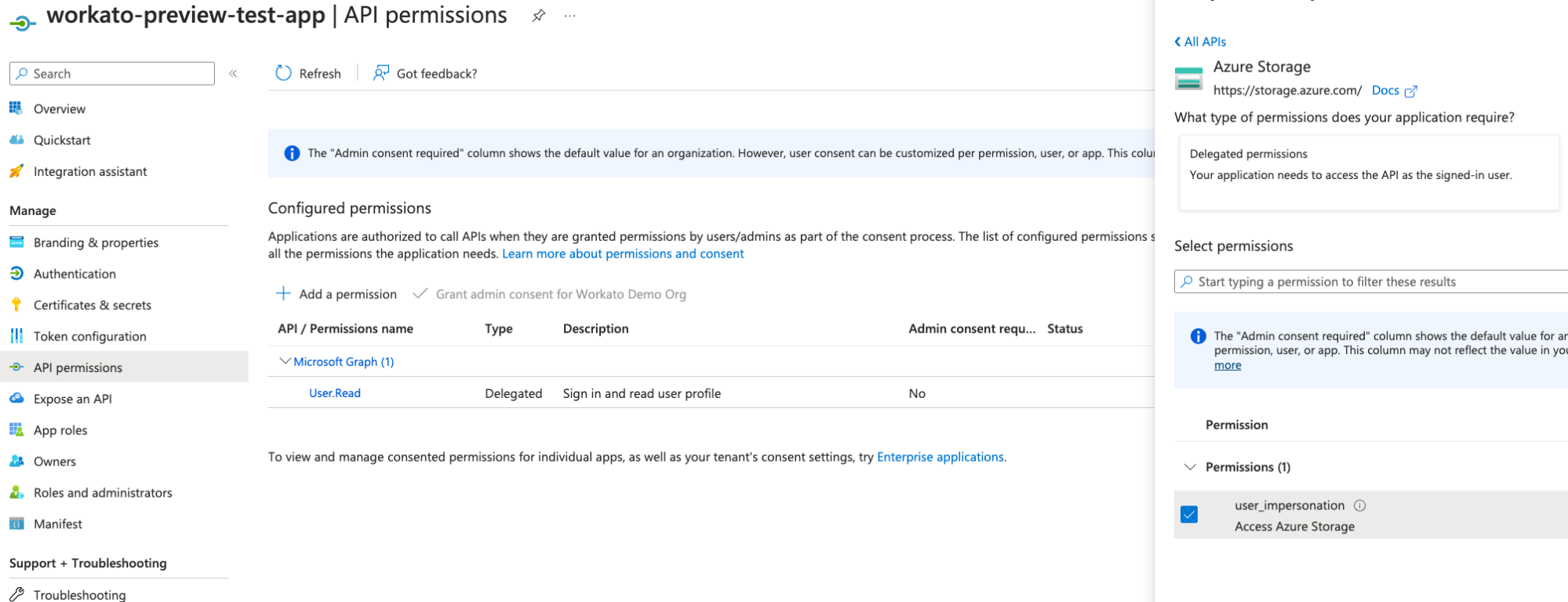

Go to Manage > API permissions.
Select Add a permission.
Add a permissionAdd a permission
Select permissions for Azure Storage and Azure Service Management on the Request API permissions page, including user_impersonation.
Click Add permissions to grant the permissions.

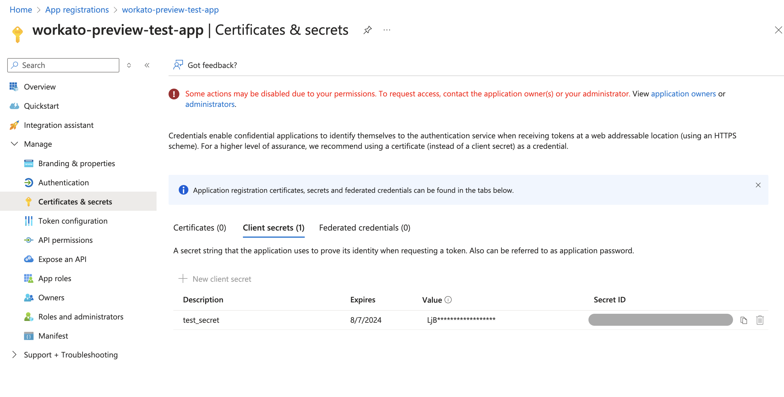

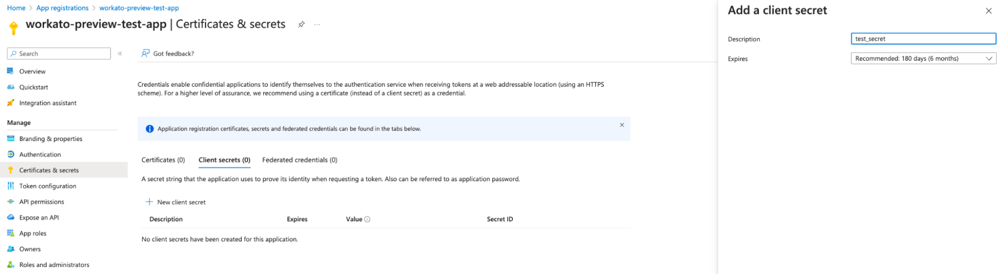

Go to Certificates & secrets > Client secrets.
Navigate to Client secretsNavigate to Client secrets
13
Generate a New client secret and securely record its Value.
Generate a Client secretGenerate a client secrets

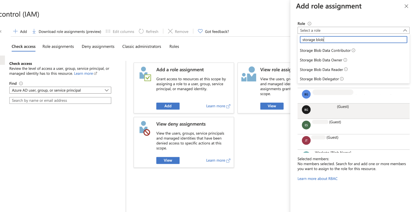

Select Access Control (IAM).
Click Add > Add role assignment.
Search for and select Storage Blob Data Contributor.
Click Next.
Select User, group, or service principal.
Click Select members and search for your registered application by name.
Select your application and click Select.
Click Review + assign to complete the role assignment.
