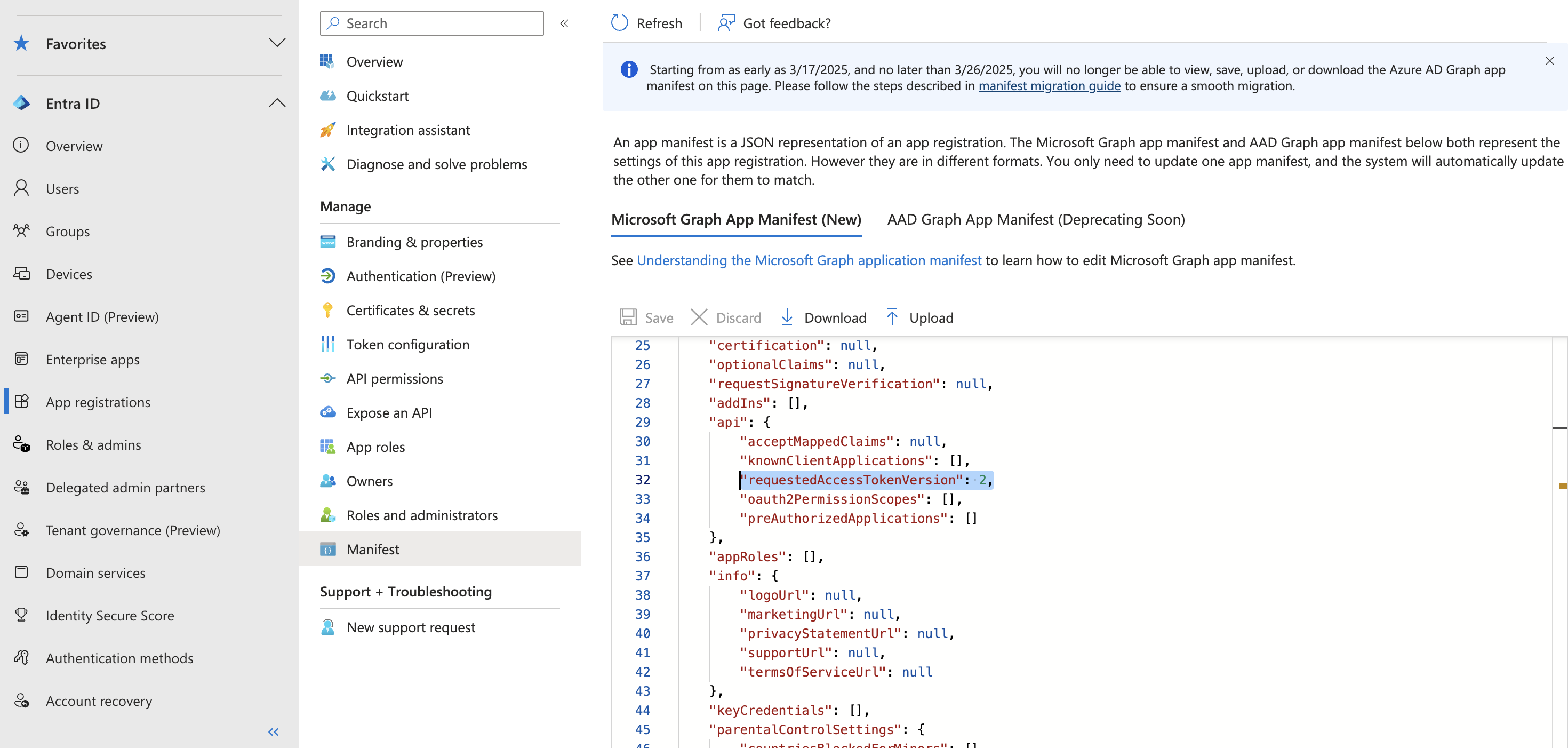

UPDATE APP MANIFEST
If you registered your app as a single tenant and need to switch to multitenant later, you must first update "requestedAccessTokenVersion" to 2 in the app Manifest before changing the account type. If you don't update the Manifest, you might encounter this error: Property api.requestedAccessTokenVersion is invalid on the Microsoft Entra platform. Refer to the Microsoft Entra app manifest (Azure AD Graph format) documentation for more information.
Update app ManifestUpdate app Manifest
