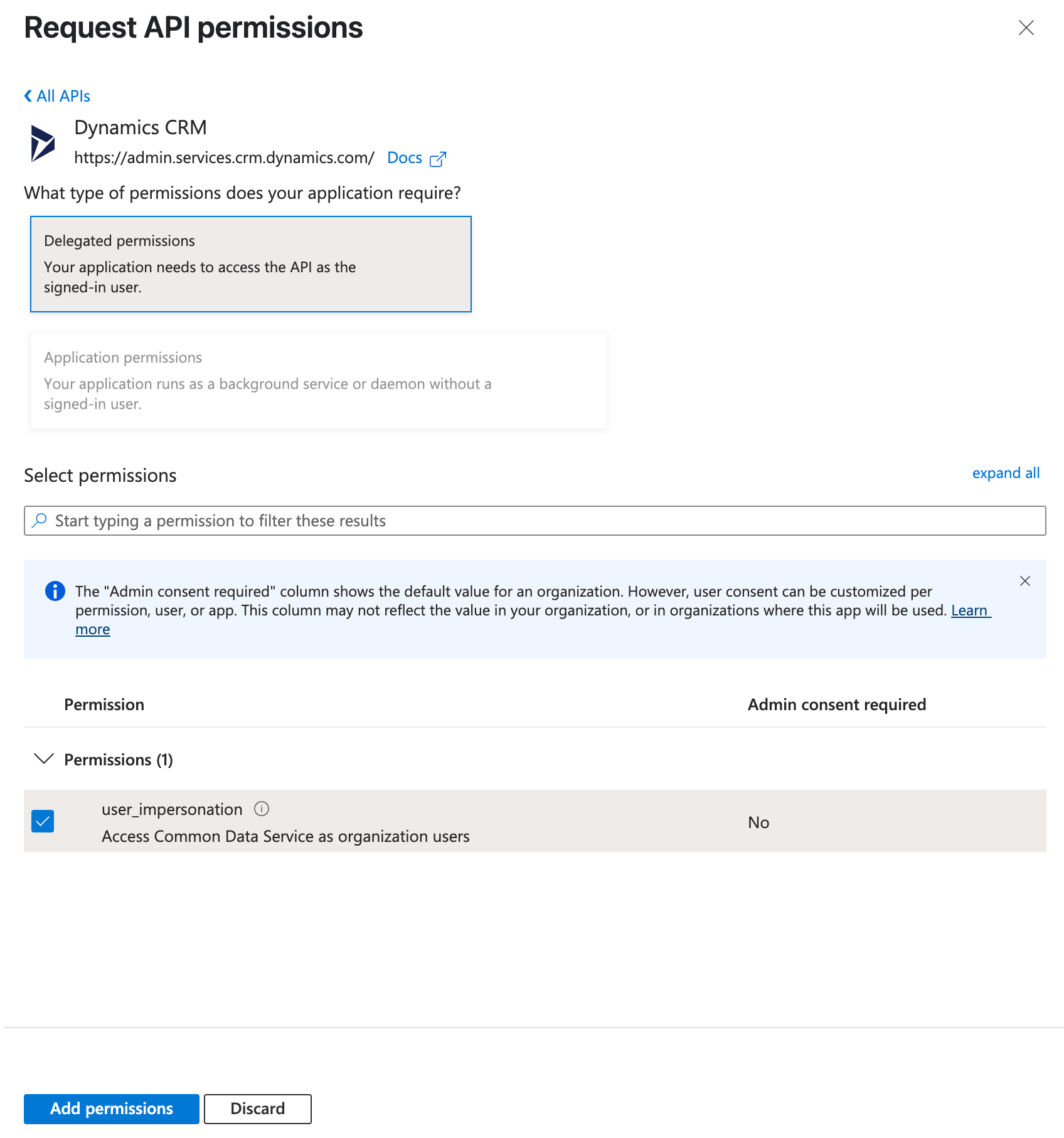

In the navigation sidebar, select Manage > API permissions.

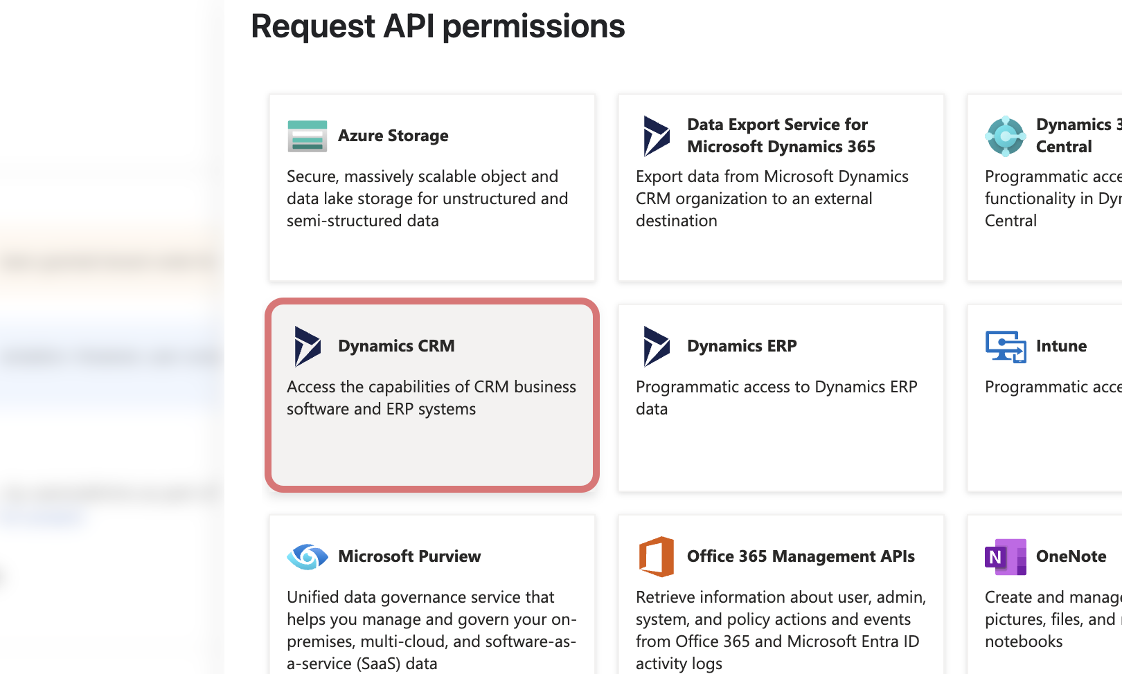

Click + Add a permission and select Dynamics CRM.
Select Dynamics CRMSelect Dynamics CRM
Select Delegated permissions, then select the user_impersonation checkbox.
Select permissionsSelect permissions
Click Add permissions.

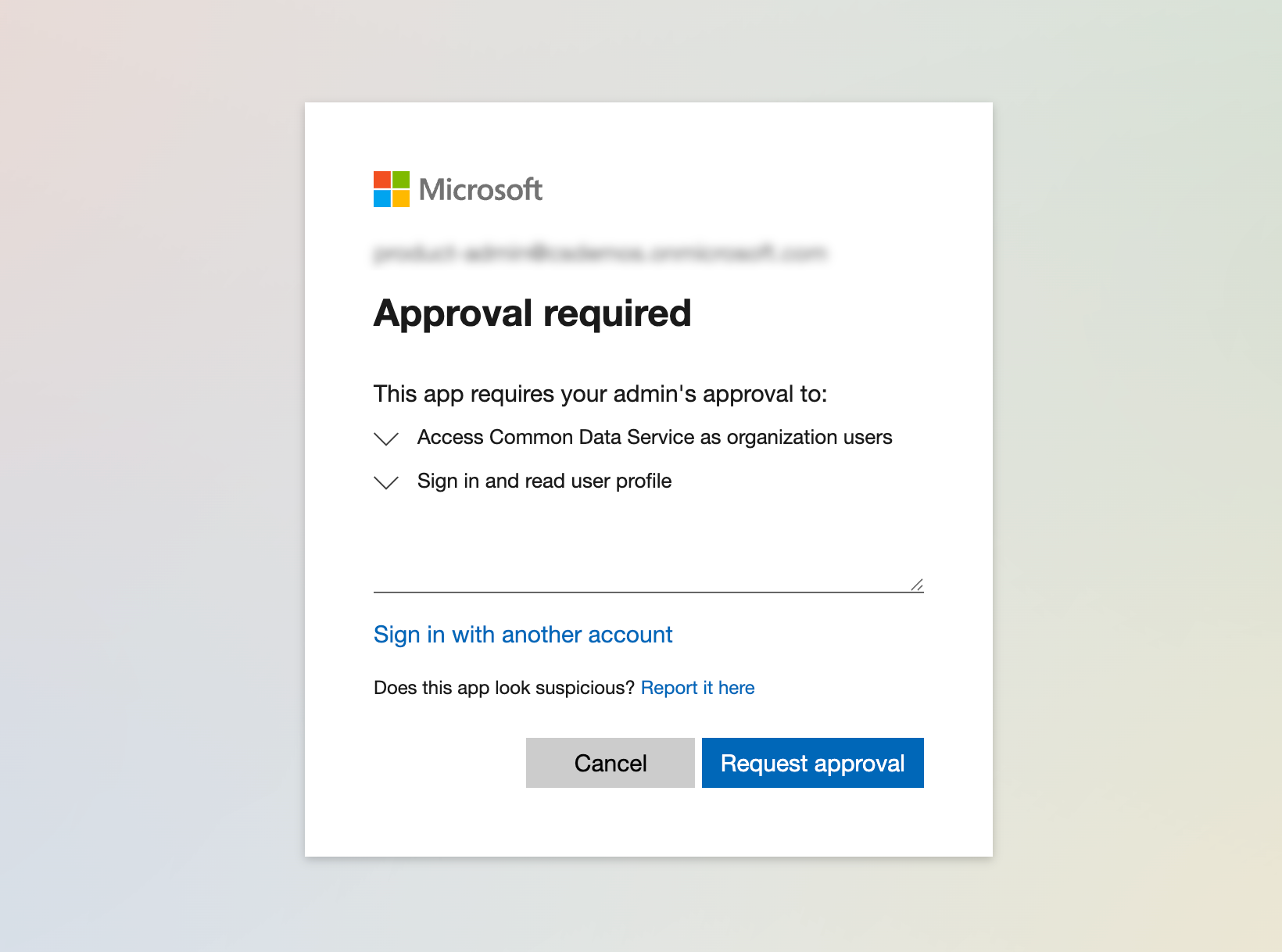

Note: Admin consent is required for specific permissions. Refer to the Granting admin consent section to learn more.
Admin consent screenAdmin consent screen

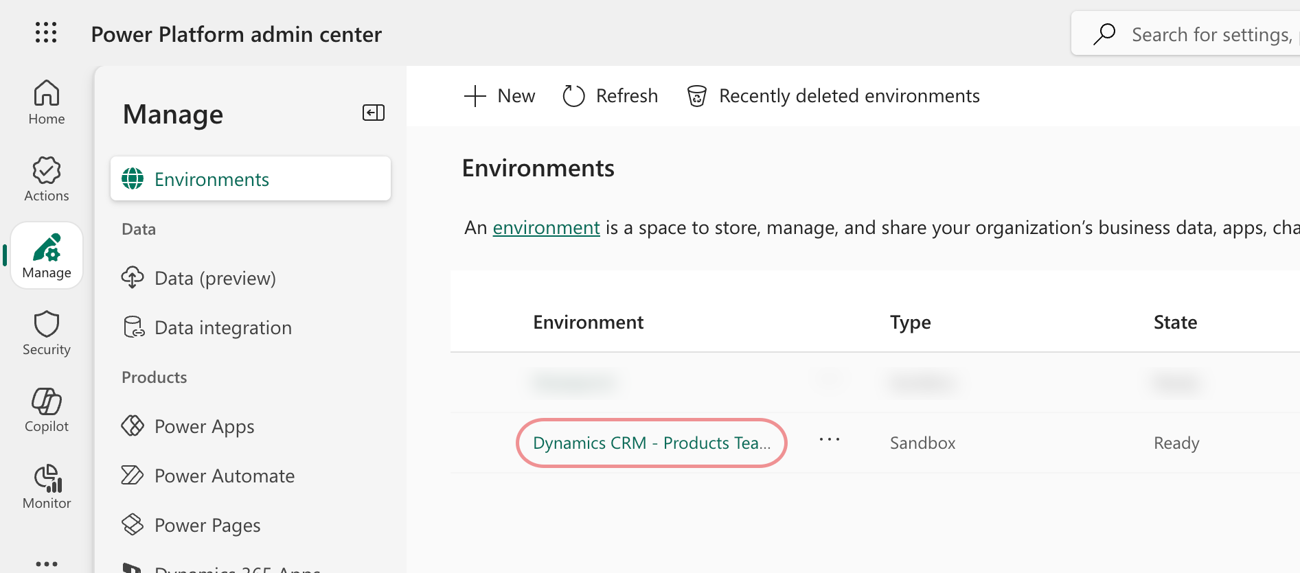

Sign in to the Power Platform admin center.
Select Manage in the navigation pane.
In the Manage pane, select Environments. Then, select an environment from the table.
Select an environmentSelect an environment

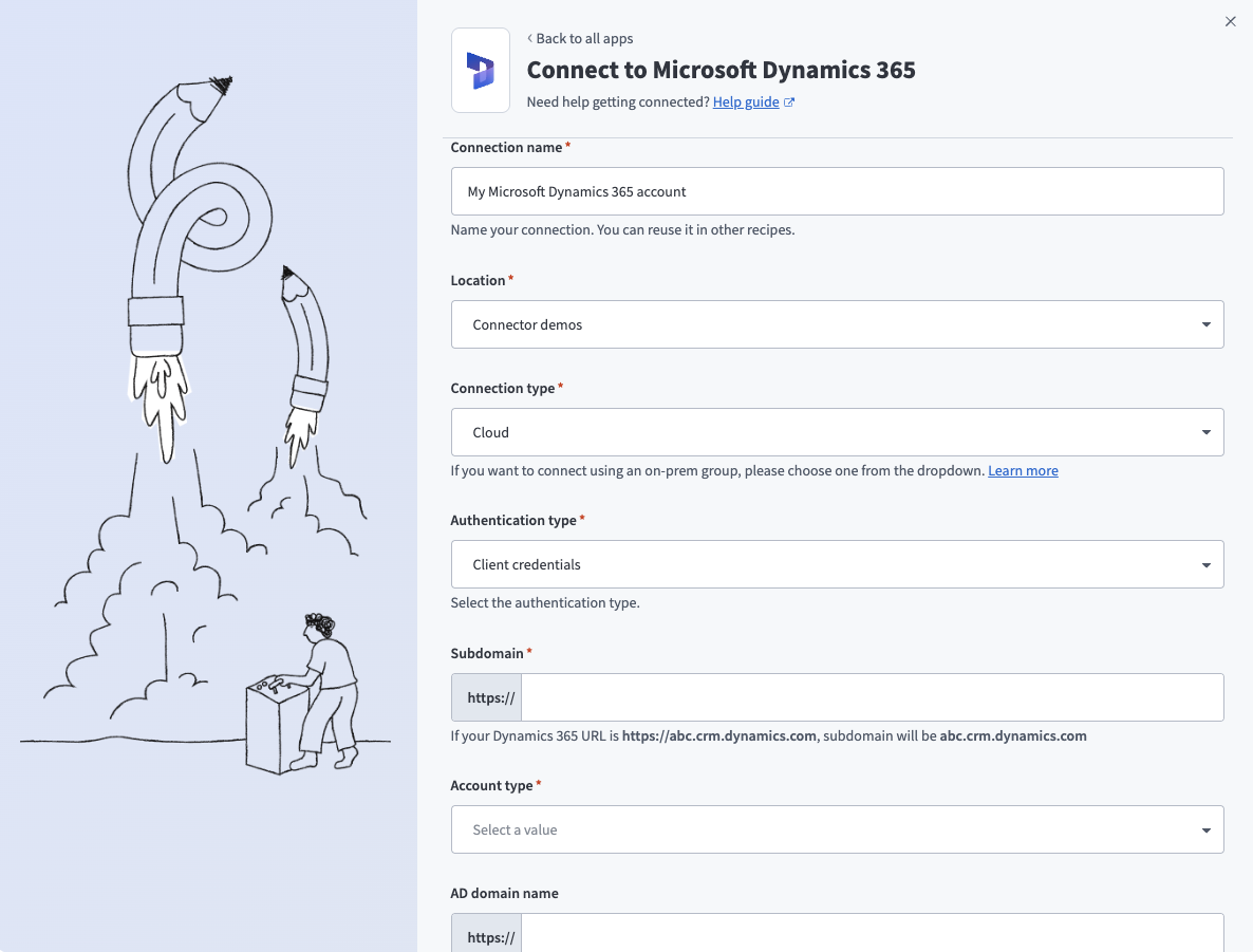

Complete the following steps to establish a Microsoft Dynamics 365 connection using client credentials authentication:
Search for and select Microsoft Dynamics 365 as your connection on the New connection page.
Connect to Microsoft Dynamics 365Connect to Microsoft Dynamics 365
Use the Connection type to specify a cloud connection or select an on-prem group for the connection.
ON-PREM CONNECTIONS
If using an on-prem connection, you must obtain a client ID by registering your Microsoft Dynamics 365 app with the Active Directory Federation Service. Learn more.
Select Client credentials as the Authentication type.
Enter your Microsoft Dynamics 365 environment’s full domain, such as abc.crm.dynamics.com, in the Subdomain field.
Use the Account type drop-down menu to specify whether the account you're connecting to is hosted in the cloud or on-prem.
Fill in the AD domain name field. This field is required if you select On-premise as the Account type. For example, if your AD server is https://abc.adfs.dynamics.com/adfs, the AD domain name is abc.adfs.dynamics.com.
Enter your client ID in the Client ID field.
Enter your client secret in the Client secret field.

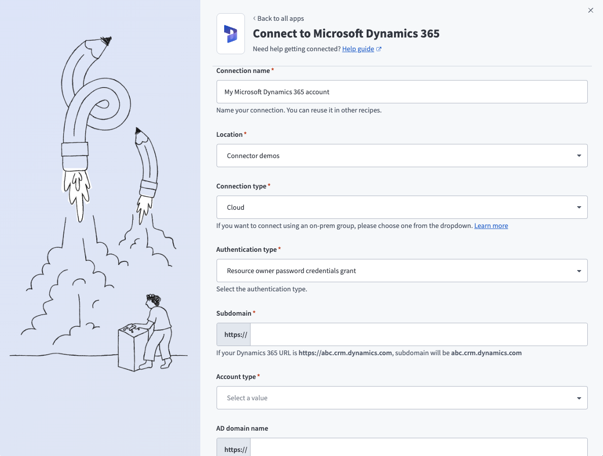

Complete the following steps to establish a Microsoft Dynamics 365 connection using resource owner password credentials grant authentication:
ON-PREM CONNECTIONS
Select Resource owner password credentials grant as the Authentication type.
