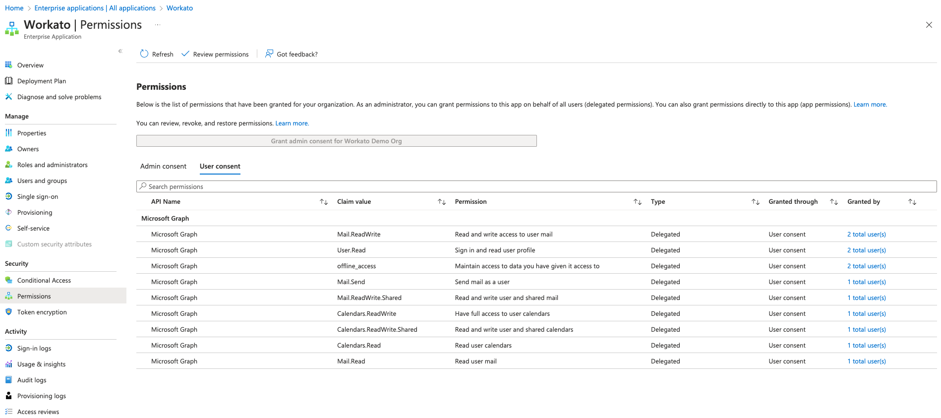

Open the Workato application and select Permissions from the left menu.
Review the list of Microsoft Graph API permissions. Confirm that each permission matches the required Outlook scopes.
Click Grant admin consent for [Tenant name] to approve access on behalf of your organization.
Return to Workato and reconnect to Outlook. The connection completes without another admin approval prompt.
When the consent is granted correctly, the Permissions page for the Workato enterprise application lists the Microsoft Graph APIs with the updated status.
Grant admin consent for Workato in Microsoft Entra IDGrant admin consent for Workato in Microsoft Entra ID
