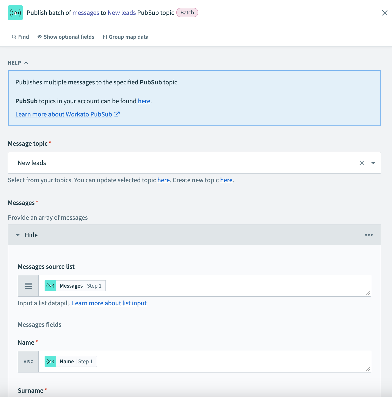

The batch publish action enables you to publish a batch of messages to a specific topic in Workato. Other recipes can then pick up all messages published to that topic, using Event streams triggers.
One action can publish up to 100 messages at a time. The topic schema defines the action input fields available here.
Publish message action configurationSelect the topic and fill in the input fields to configure the publish message action
Note that you need to use a list of messages as a datapill.
