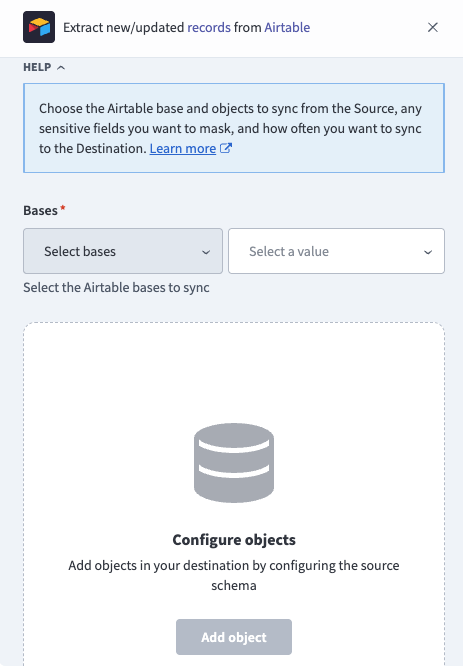

Use the Bases drop-down menu to select the Airtable bases to sync. Workato lists tables only from the bases you select here.
Select Airtable basesSelect Airtable bases
Click Add object to open the Add new objects panel. Workato dynamically discovers the tables in your selected bases and displays them as a searchable list, labeled by base and table. Workato shows the base ID instead of the base name when discovery is scoped using base IDs.
Search or browse the list of available Airtable tables, select the tables you plan to sync, and click Add.
