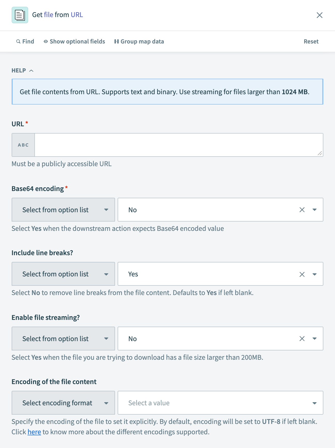

Input
| Field | Description |
| URL | Specify the URL where the file is located. The URL must be publicly accessible. |
| Base64 encoding | Select Yes when the downstream action expects a Base64 encoded value. |
| Include line breaks? | Select No to remove line breaks from the file content. Defaults to Yes if left blank. |
| Enable file streaming? | Select Yes when the file you plan to download is larger than 200 MB. |
| Encoding of the file content | Specify the encoding of the file to set it explicitly. Defaults to UTF-8 if left blank. |
Output
| File contents | The contents of the file. |
| Size | The size of the file in bytes. |
