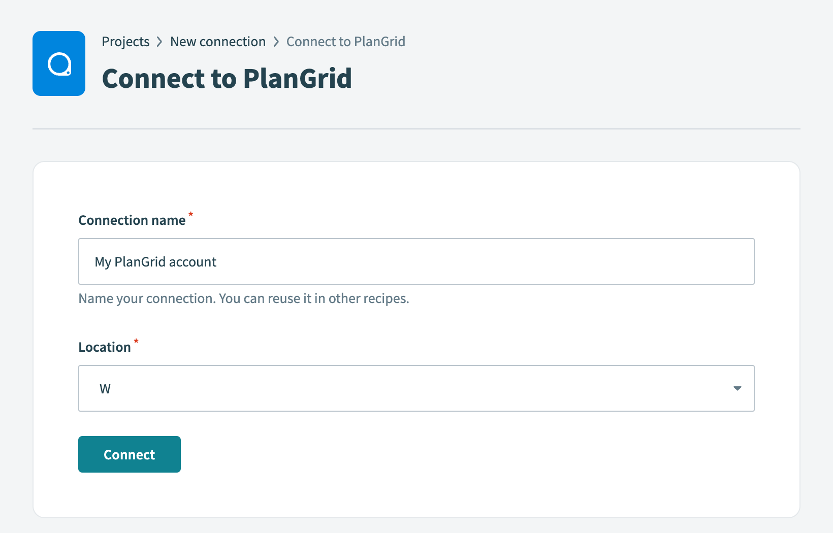

Create a PlanGrid connection ​
This step creates a connection between Workato and your PlanGrid account.
Search for and select PlanGrid on the New connection page.
PlanGrid connection setupPlanGrid connection setup
Click Connect. A PlanGrid OAuth dialog appears.
Click Give Permission to authorize Workato to establish the connection.

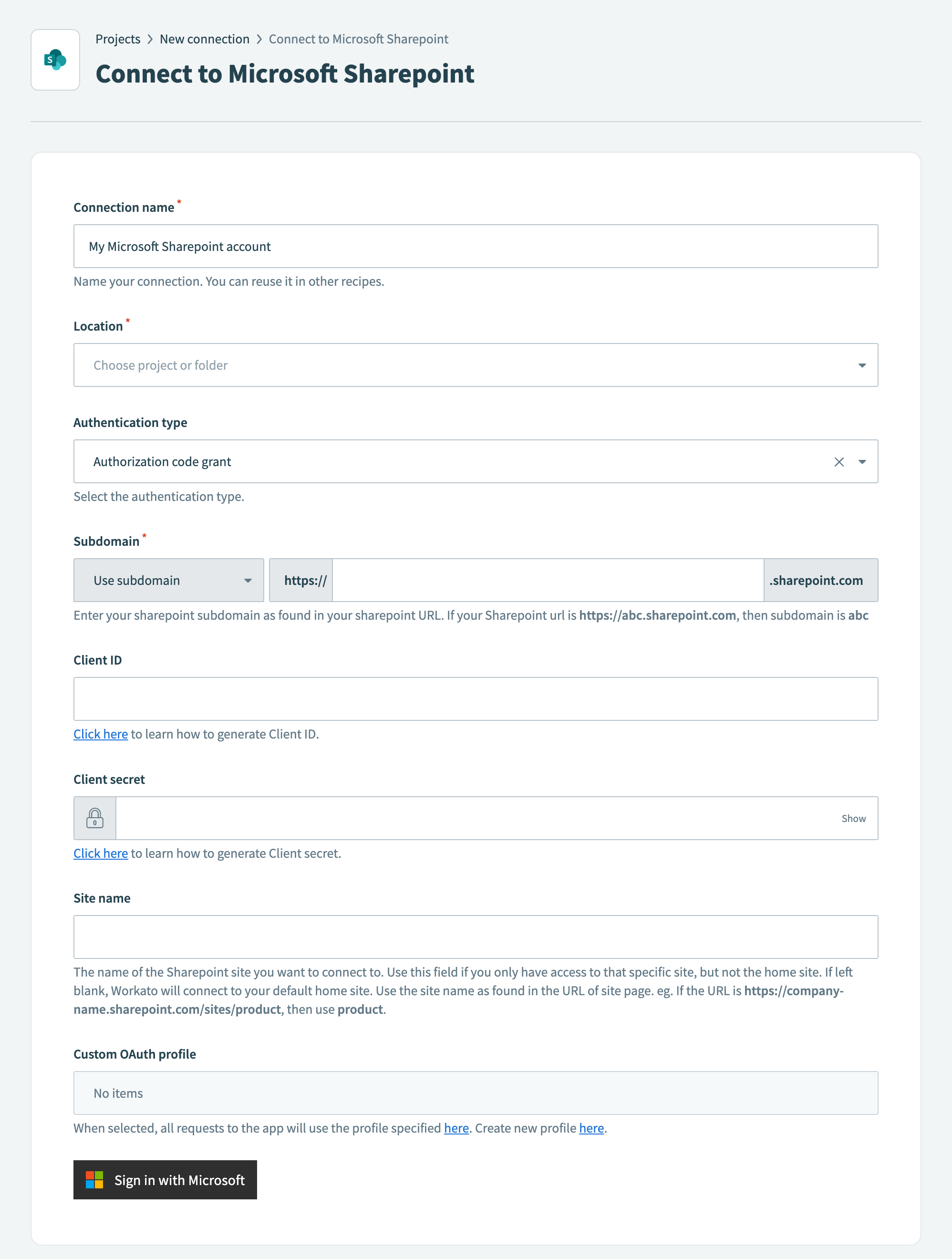

Step 2: Complete setup in Workato ​
Search for and select Microsoft Sharepoint on the New connection page.
Microsoft SharePoint connection setupMicrosoft SharePoint connection setup
Use the Authentication type drop-down menu to select Authorization code grant.
Enter your SharePoint subdomain as found in your SharePoint URL in the Subdomain field. For example, if your SharePoint URL is https://abc.sharepoint.com, the subdomain is abc.
Enter the client ID generated in SharePoint in the Client ID field.
Enter the client secret generated in SharePoint in the Client secret field.
Enter the name of the SharePoint site you plan to connect to in the Site name field. If left blank, Workato connects to your default home site. Use the site name as found in the URL of the site page. For example, if the URL is https://company-name.sharepoint.com/sites/product, the site name is product.
Click Sign in with Microsoft.
Enter your credentials to sign in.
Click Accept to authorize the app you created in your Azure Portal.

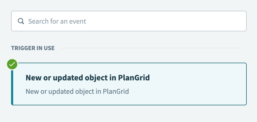

Set up your PlanGrid New or updated object trigger.
Set up PlanGrid New or updated object trigger ​
This trigger monitors your PlanGrid project for new or updated field reports that include the word Safety in the file name.
Search for PlanGrid and select it as your app.
Choose PlanGridChoose PlanGrid
Select the New or updated object in PlanGrid trigger.
Select the New or updated object in PlanGrid triggerSelect the New or updated object in PlanGrid trigger

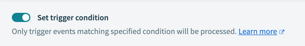

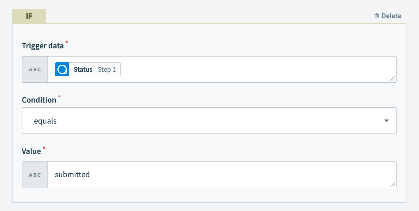

Click the Set trigger condition toggle.
Set trigger conditionSet trigger condition
Map the PlanGrid StatusStep 1 datapill to the Trigger data field.
Use the Condition drop-down menu to select equals.
Type submitted in the Value field.

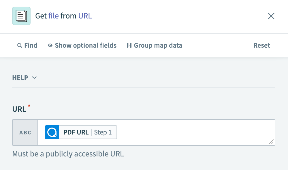

Set up your File tools by Workato Get file from URL action.
Set up File tools by Workato Get file from URL action ​
This step retrieves the file contents from the PDF URL.
Search for File tools by Workato and select it as your app.
Choose File tools by WorkatoChoose File tools by Workato
Select the Get file from URL action.
Select the Get file from URL actionSelect the Get file from URL action
Map the PlanGrid PDF URLStep 1 datapill to the URL field.
Map the PDF URL datapillMap the PDF URLStep 1 datapill
Click Save.

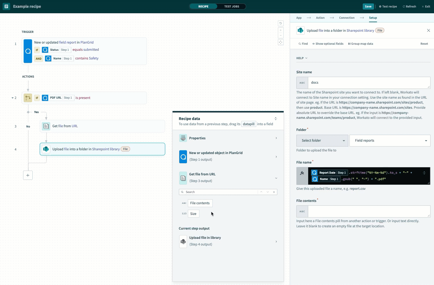

Set up your Microsoft SharePoint Upload file in library action.
Set up Microsoft SharePoint Upload file in library action ​
This step uploads the PlanGrid field report PDF file to a folder you specify in Microsoft SharePoint.
Search for Microsoft SharePoint and select it as your app.
Choose Microsoft SharePointChoose Microsoft SharePoint
Select the Upload file in library action.
Select the Upload file in library actionSelect the Upload file in library action
Enter the name of the Microsoft SharePoint site you plan to connect to in the Site name field. If left blank, Workato connects to the site name specified when you configured your connection.
Select the folder where you plan to upload the field report in the Folder field.
Enter a name in the File name field.
Complete the following steps to configure this field dynamically:
Configure the file nameConfigure the file name
Switch the File name field to formula mode.
Map the PlanGrid Report DateStep 1 datapill.
Append the .strftime formula to format the Report DateStep 1 datapill. Enter "%Y-%m-%d" as the value in the .strftime formula.
Append the .to_s formula to convert the Report DateStep 1 datapill into a string.
Type + "-" + to insert a hyphen between the date and document title.
Map the PlanGrid NameStep 1 datapill.
Append the .gsub formula to replace spaces with hyphens in the document name. Enter " ", "-" as the value in the .gsub formula.
Type + ".pdf" to complete the file name with the .pdf extension.
File name configurationFile name configuration
This configuration applies the following naming convention:
YYYY-MM-DD-YOUR-SAFETY-FIELD-REPORT-TITLE.pdf
For example:
2024-10-09-Daily-Safety-Inspection.pdf
Map the File tools by Workato File contentsStep 3 datapill to the File contents field.
Map the File contents datapillMap the File contentsStep 3 datapill
Click Save.
Your Sync PlanGrid safety reports to Microsoft SharePoint recipe is ready to test and implement.
Example recipe configuration.
PlanGrid and Microsoft SharePoint recipeSync PlanGrid safety reports to Microsoft SharePoint recipe
