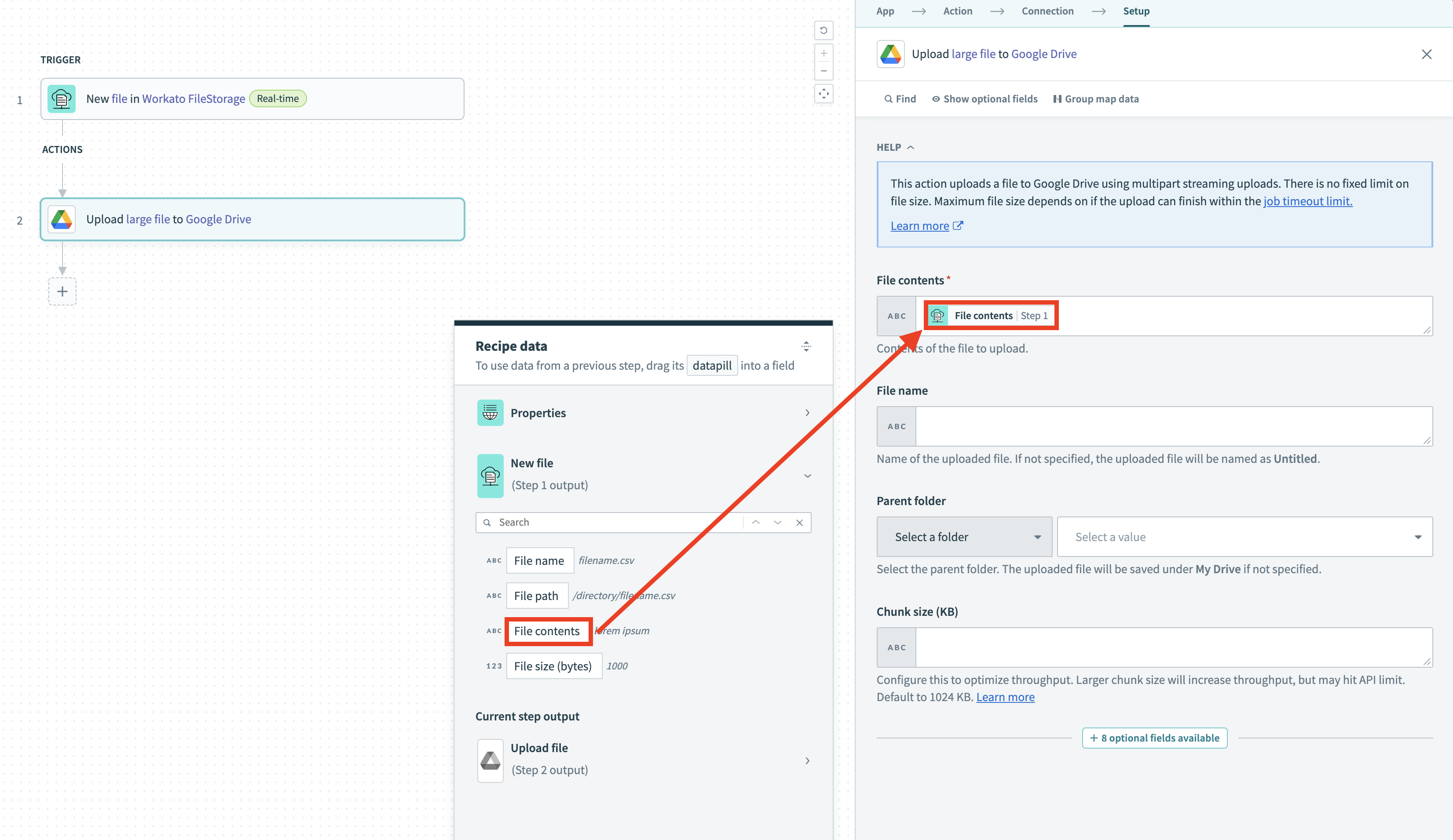

If either the source (such as a file download, bulk trigger, or bulk action) or the destination (such as a file upload or bulk action) supports file streaming, Workato automatically initiates file streaming when you pass a File contents or CSV contents datapill to the File contents input field. No additional configuration is required in the recipe.
Passing a File contents datapill to a File contents input field Passing a File contents datapill to a File contents input field
Note that the streaming transfer begins when the recipe reaches the consumer action step in the recipe. File streaming actions are usually long or deferred actions. As a result, streaming actions do not time out, no matter how long the transfer takes.
