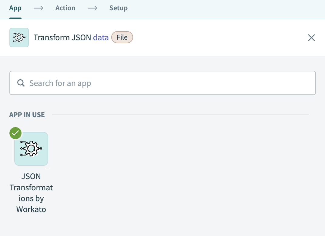

Search for and select JSON Transformations by Workato as your connector after you set up your trigger.
Select JSON Transformations by WorkatoSelect JSON Transformations by Workato

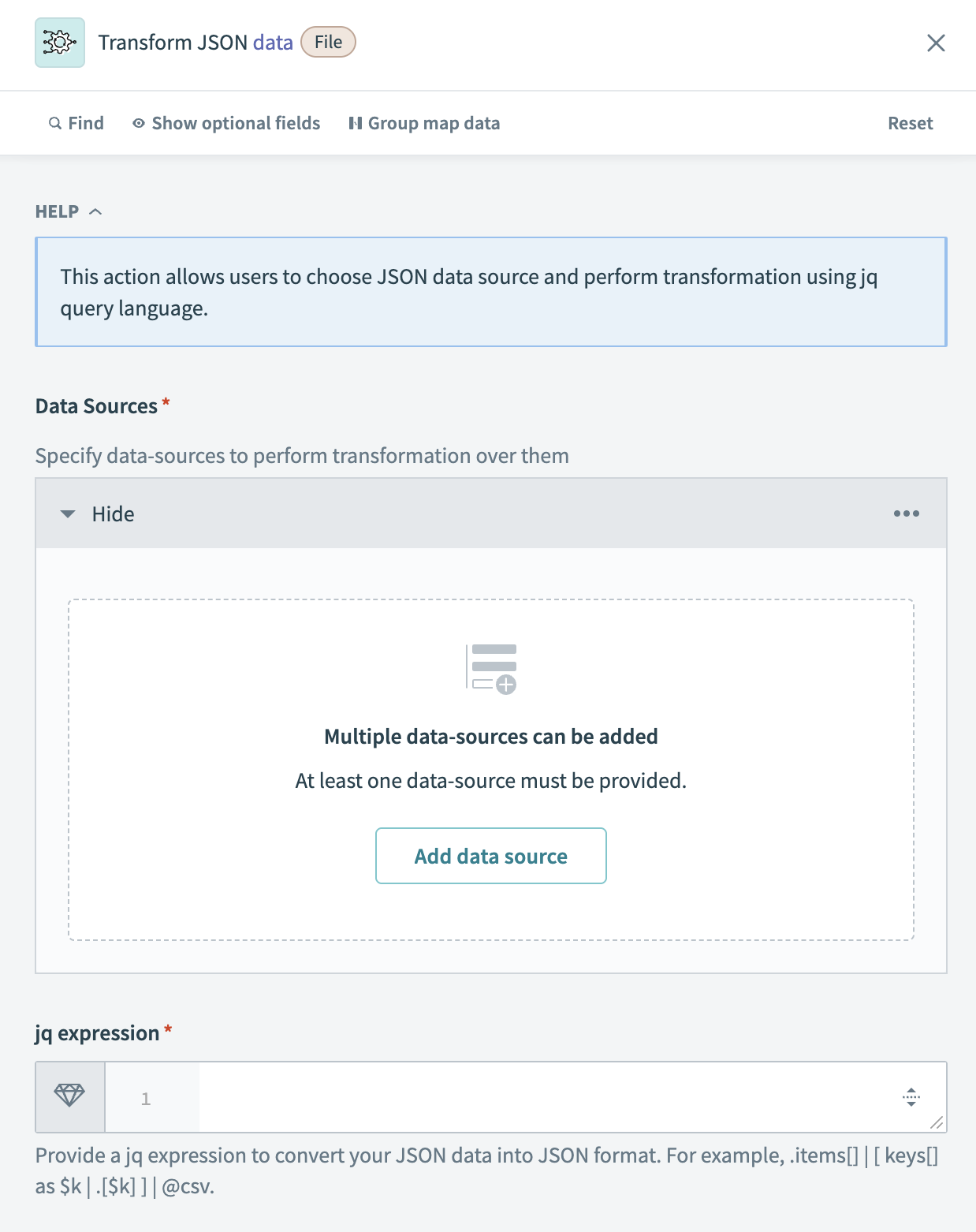

Click Add data source to define a source.
Add data sourceAdd data source
