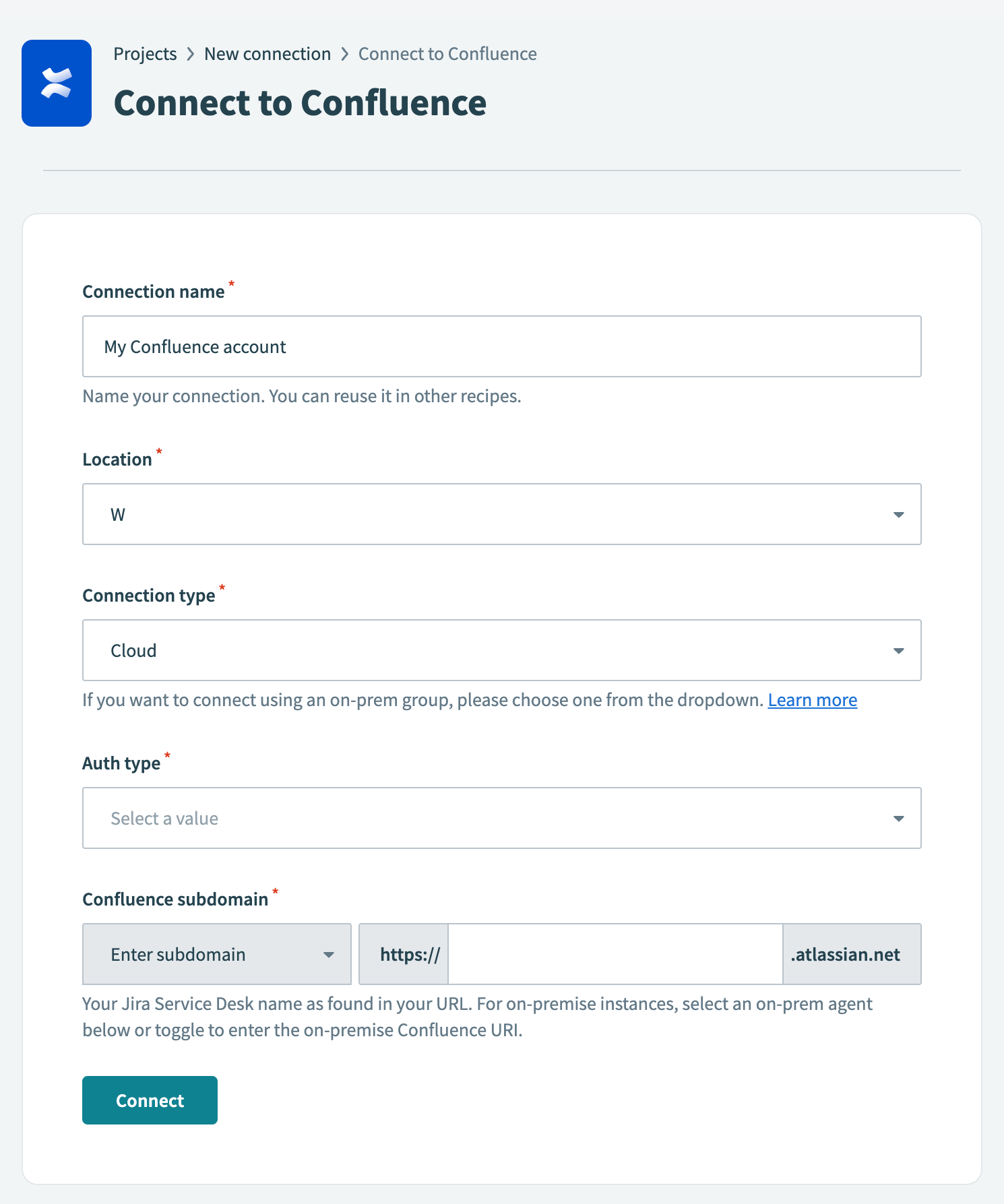

Search for and select Confluence on the New connection page.
Confluence connection setupConfluence connection setup
Use the Connection type drop-down menu to select the connection method you plan to use. You can select your on-prem group name or select Cloud to use a direct connection.
Use the Auth type drop-down menu to select your authentication method. Options include Basic, API token, and OAuth 2.0.
Provide your connection information.
  • If using a cloud connection: Enter your Confluence subdomain in the Confluence subdomain field.
  • If using an on-prem connection: Enter the root URI (includes protocol, optional port, and hostname) of your Confluence host in the Confluence root URI field.

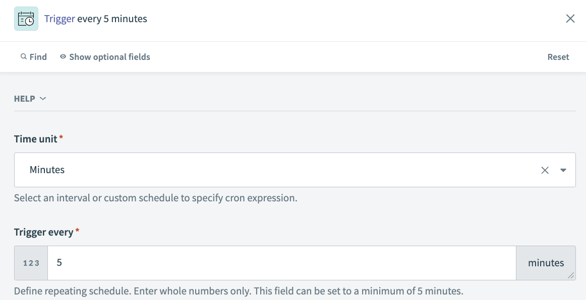

This step triggers your knowledge recipe to refresh Confluence content in your knowledge base every five minutes. This recipe uses the Scheduler by Workato trigger because the Confluence connector doesn't provide a trigger.
Search for and select Scheduler by Workato.
Use the Time unit drop-down menu to select Minutes.
Go to the Trigger every field and enter 5.
Scheduler by Workato trigger configurationScheduler by Workato trigger configuration

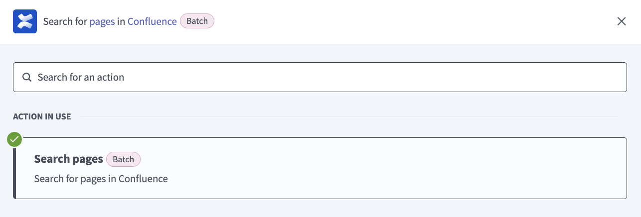

Search for and select Confluence.
Select the Search pages action.
Select the Search pages actionSelect the Search pages action
Select the Confluence connection you set up in the preceding steps. No additional configuration is required for this action.

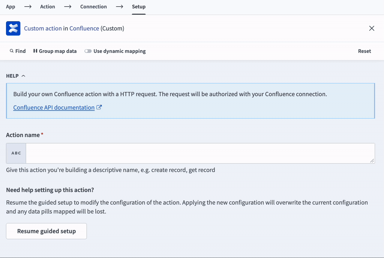

Confluence doesn't have a pre-built action that enables you to retrieve page content for all Confluence documents in a space. You must create custom HTTP request that downloads the content with the Custom action.
Select Custom action.
Go to the Action name field and enter GET pages.
Name your custom action GET pagesName your custom action GET pages
Click Resume guided setup.

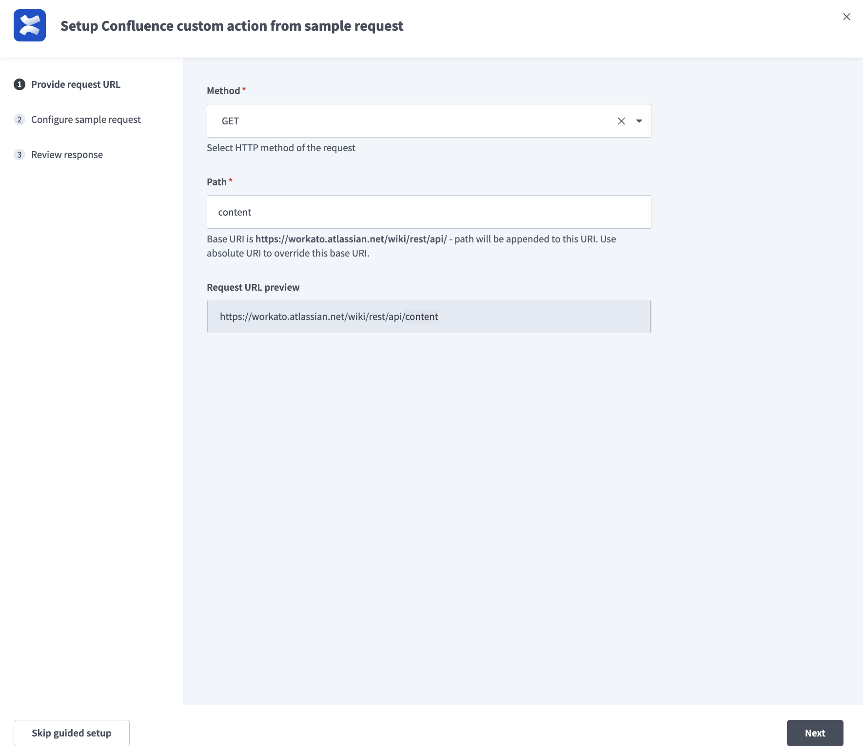

Use the Method drop-down menu to select GET.
Go to the Path field and enter content.
Provide your method and pathProvide your method and path
Click Next.

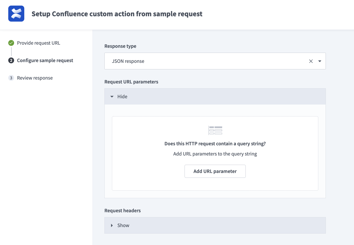

Use the Response type drop-down to select JSON response.
Expand the Request URL parameters section.
Click Add URL parameter.
Click Add URL parameterClick Add URL parameter
12
Go the Parameter name field and enter the spaceKey, then enter your parameter value in the Value field. For example: If your Confluence URL is https://yoursite.atlassian.net/wiki/spaces/DOCS/pages/, your API request would look similar to this: GET /rest/api/content?spaceKey=DOCS, and you would enter DOCS.
Configure your URL parameterConfigure your URL parameter

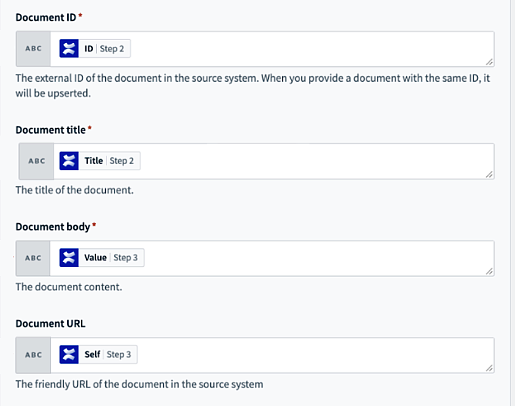

Use the Knowledge base drop-down menu to select the knowledge base you created in the preceding steps.
Expand the Documents section.
Map the IDStep 2 datapill to the Document ID field.
Map the TitleStep 2 datapill to the Document title field.
Map the ValueStep 3 datapill to the Document body field.
Map the SelfStep 3 datapill to the Document URL field.
Set up your Store knowledge in a knowledge base actionSet up your Store knowledge in a knowledge base action
