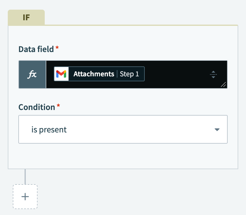

Set up email attachments IF condition
This IF condition checks if the email contains attachments.
Switch Data field to formula mode and map the Gmail AttachmentsStep 1 datapill.
Set Condition to is present.
Check if the email contains attachmentsCheck if the email contains attachments

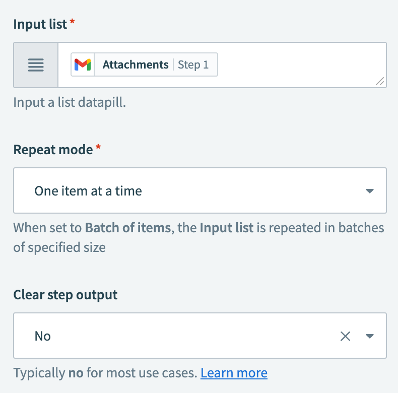

Set up your email attachments Repeat for each loop.
Set up an email attachments Repeat for each loop
This loop iterates through all the attachments in the email to ensure that all attachments are processed.
Map the Gmail AttachmentsStep 1 list datapill to the Input list field.
Ensure Repeat mode is set to One item at a time.
Iterate through attachments listIterate through attachments list

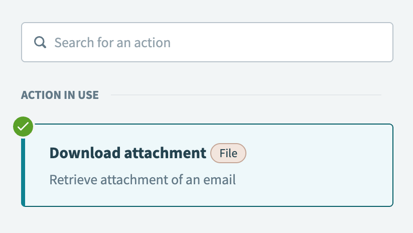

Set up your Gmail Download attachment action.
Set up Gmail Download attachment action
This step downloads the image attachment's content.
Search for Gmail and select it as your app.
Choose GmailChoose Gmail
Select the Download attachment action.
Select the Download attachment actionSelect the Download attachment action

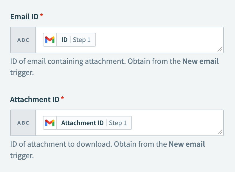

Map the Gmail IDStep 1 datapill to the Email ID field.
Map the Gmail Attachment IDStep 1 datapill to the Attachment ID field.
Configure the Download attachment actionConfigure the Download attachment action

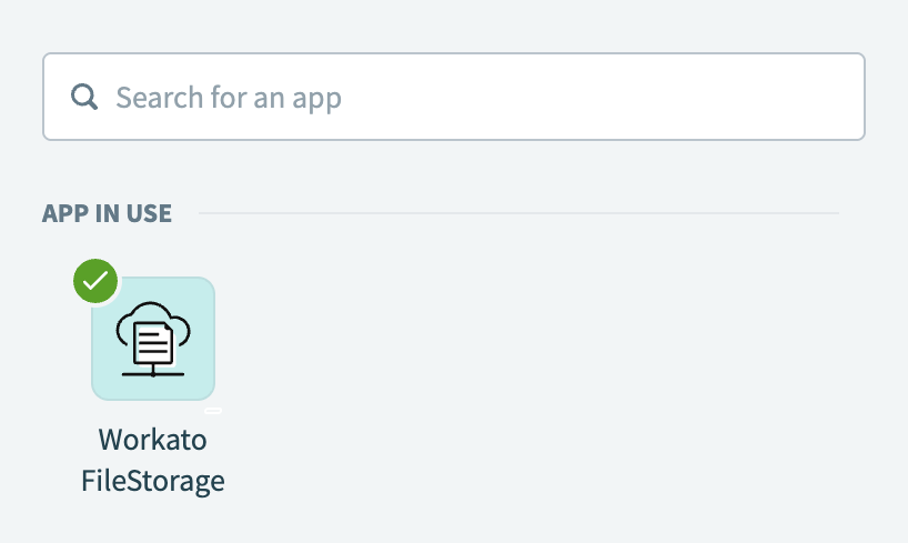

Set up your Workato FileStorage Create file action.
This step stores the downloaded image in Workato FileStorage.
Search for Workato FileStorage and select it as your app.
Choose Workato FileStorageChoose Workato FileStorage

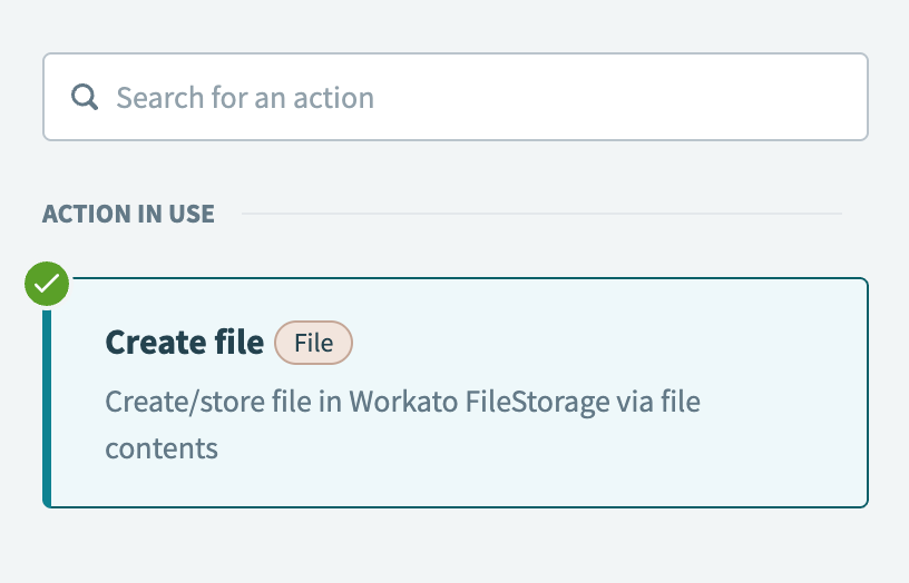

Select the Create file action.
Select the Create file actionSelect the Create file action
Map the Foreach FilenameStep 3 datapill to the File name field.
Specify the location of where to create the file in the File path field.
Map the Gmail Content bytesStep 5 datapill to the File contents field.

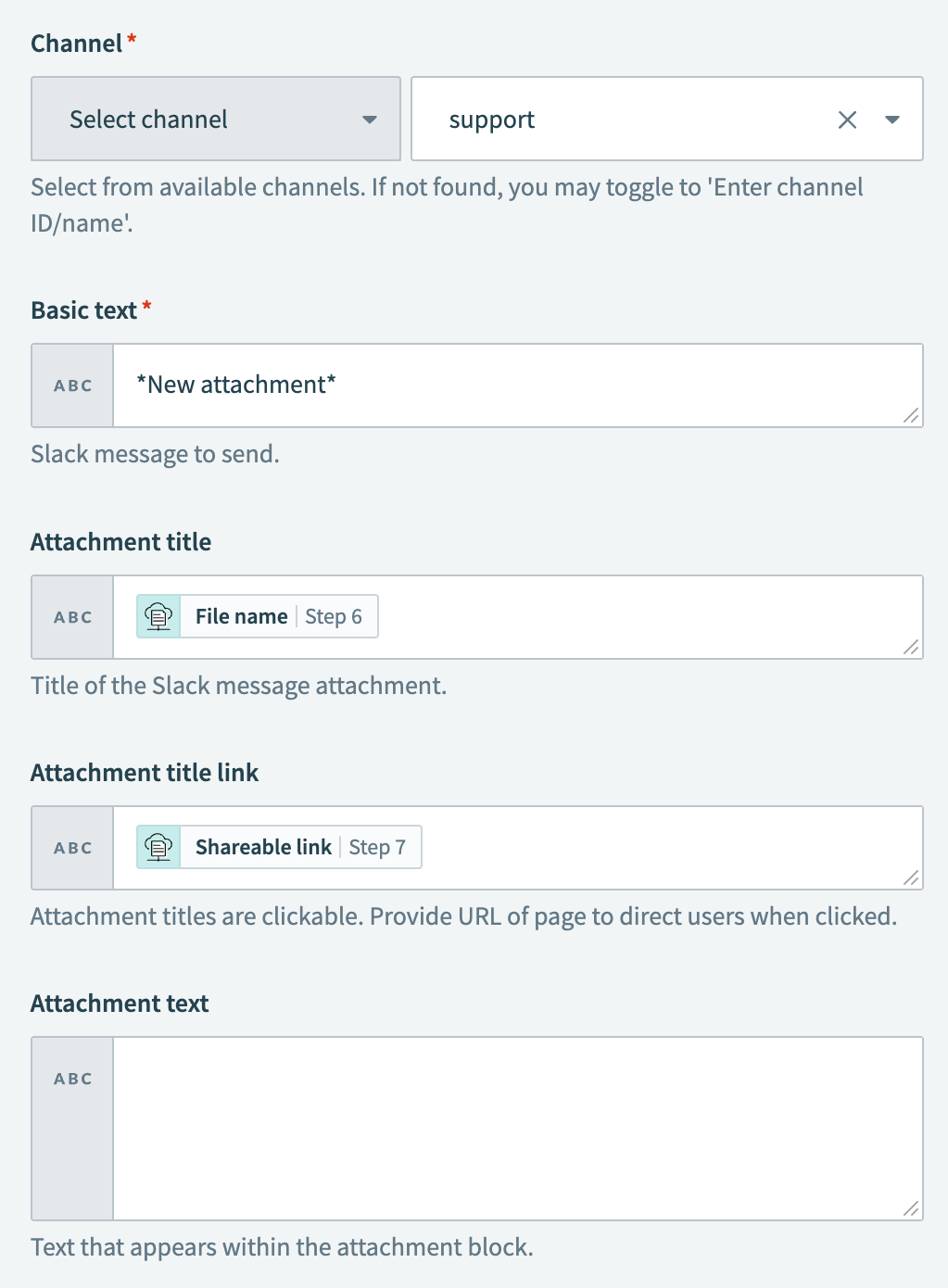

Set up your Slack Post message action.
Set up Slack Post message action
This step posts the image link in Slack, which users can click to download the attachment.
Search for Slack and select it as your app.
Choose SlackChoose Slack
Select the Post message action.
Select the Post message actionSelect the Post message action
Use the Channel drop-down menu to specify where to post the message.
Enter a message in the Basic text field. For example, *New attachment*.
Map the Workato FileStorage File nameStep 6 datapill to the Attachment title field.
Map the Workato FileStorage Shareable linkStep 7 datapill to the Attachment title link field.
Optional. Enter text in the Attachment text field. This text appears under the attachment link.
Configure the Post message actionConfigure the Post message action
