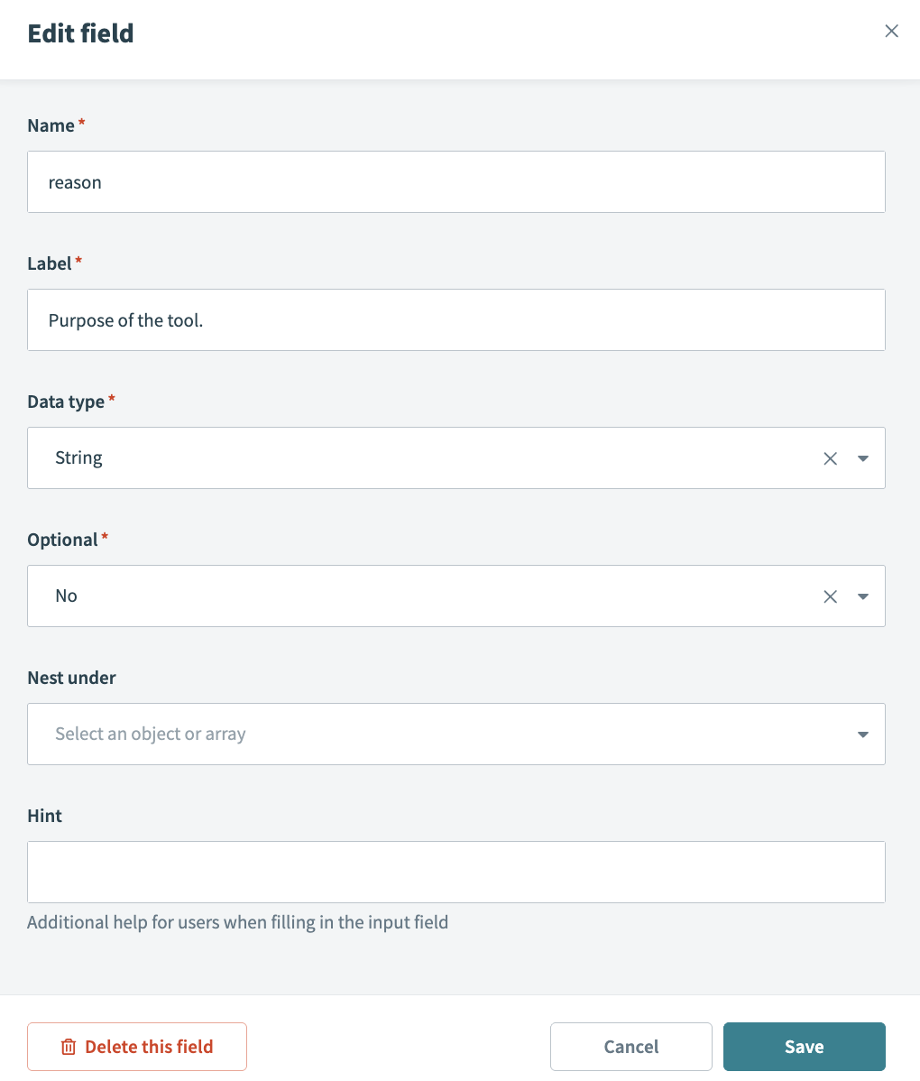

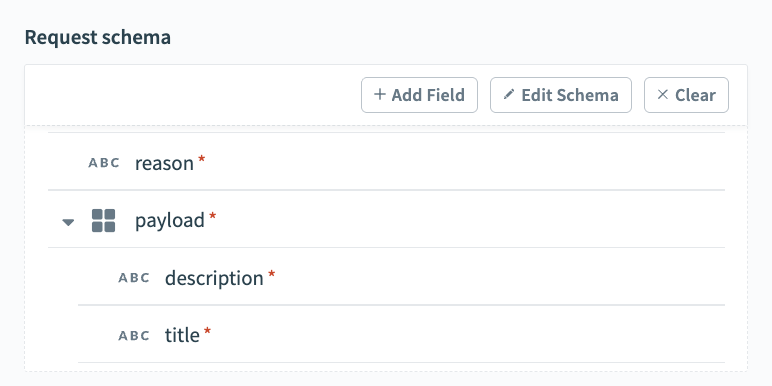

Complete the following steps to configure your request schema:
Go to the Request schema section and click + Add Field.
Enter reason in the Name and Label fields.
Use the Data type drop-down menu to select String.
Use the Optional drop-down menu to select No.
Reason fieldReason field
Click Save.
Return to the Request schema section and click + Add Field.
Enter payload in the Name and Label fields.
Use the Data type drop-down menu to select Object.
Click Save.
12
Enter description in the Name and Label fields.
13
14
15
Use the Nest under drop-down menu to select payload.
16
Click Save.
17
18
Enter title in the Name and Label fields.
19
20
21
22
Click Save.
Request schemaRequest schema

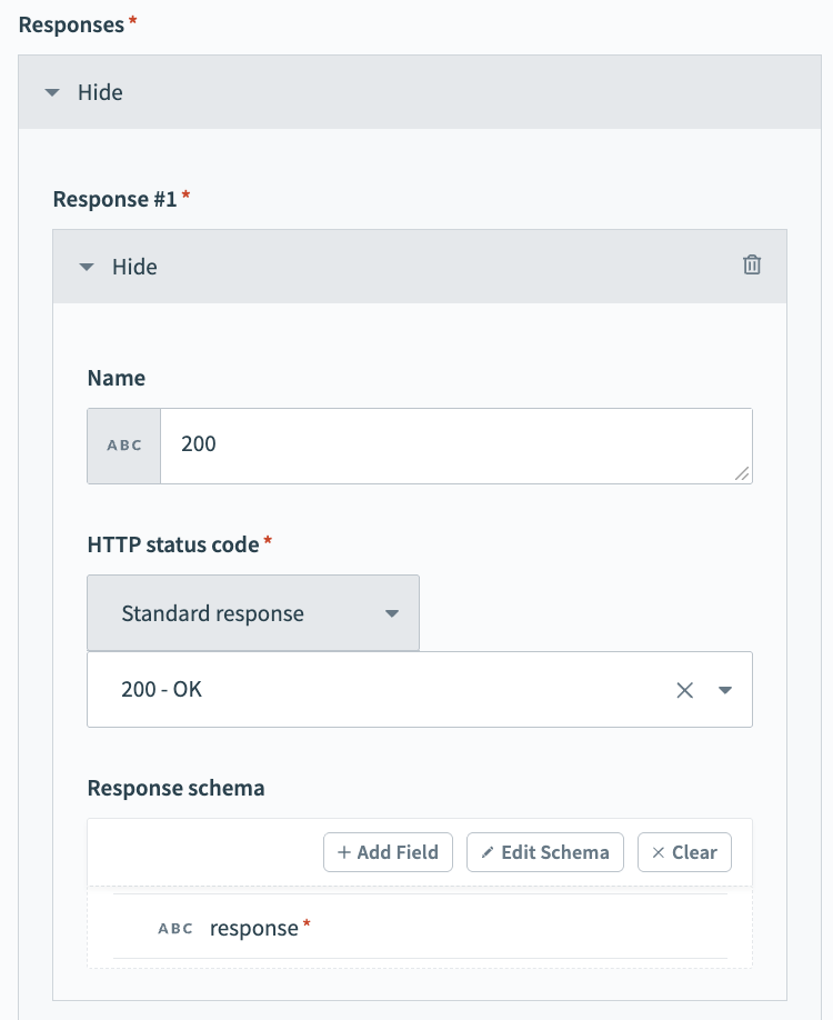

Complete the following steps to configure your request responses:
Go to the Responses section and click Add response.
Add responseClick Add response
Enter 200 in the Name field.
Use the HTTPS status code standard response drop-down menu to select 200 - OK.
Go to the Response schema section and click add fields manually.
Enter response in the Name and Label fields.
Click Save.
Response schemaResponse schema

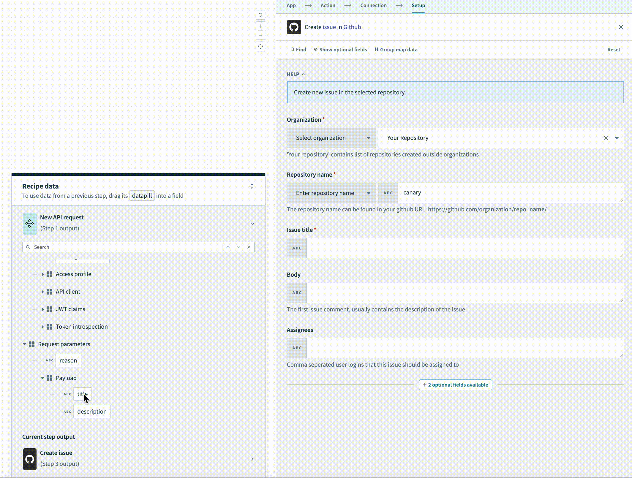

Set up your Create issue in GitHub action.
Create issue in GitHub action setup ​
This step creates a new GitHub issue with the title and description you provide in your LLM agent chat.
Search for GitHub and select it as your app.
Select the Create issue action.
Go to Organization and ensure that Select organization is selected.
Use the Select organization drop-down menu to select the GitHub organization you plan to use.
Go to Repository name and use the drop-down menu or manually enter the GitHub repository you plan to use.
Map the titleStep 1 datapill to the Issue title field.
Map the descriptionStep 2 datapill to the Body field.
Map GitHub datapillsMap the descriptionStep 2 datapill to the Body field
Click Save.

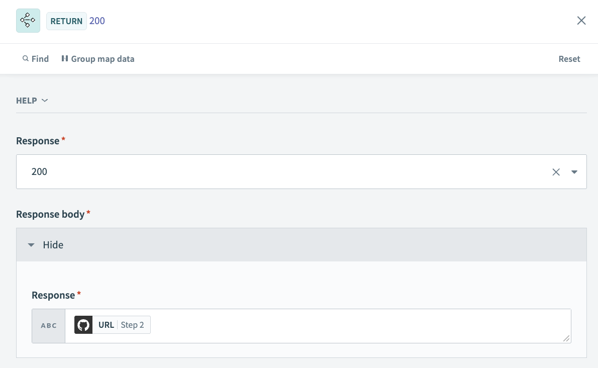

Set up your Respond to API request action.
Respond to API request action setup ​
This step instructs your LLM agent to respond with the 200 response you configured in the New API request trigger response schema. It also tells the LLM to include the newly created issue URL in the response.
Search for API platform by Workato and select it as your app.
Select the Respond to API request action.
Use the Response drop-down menu to select 200. This is the response you configured in the New API request trigger setup.
Expand the Response body section.
Map the GitHub URLStep 2 datapill to the Response field. This instructs your LLM to provide the URL link to the new issue in your chat.
Respond to API requestRespond to API request
Click Save.

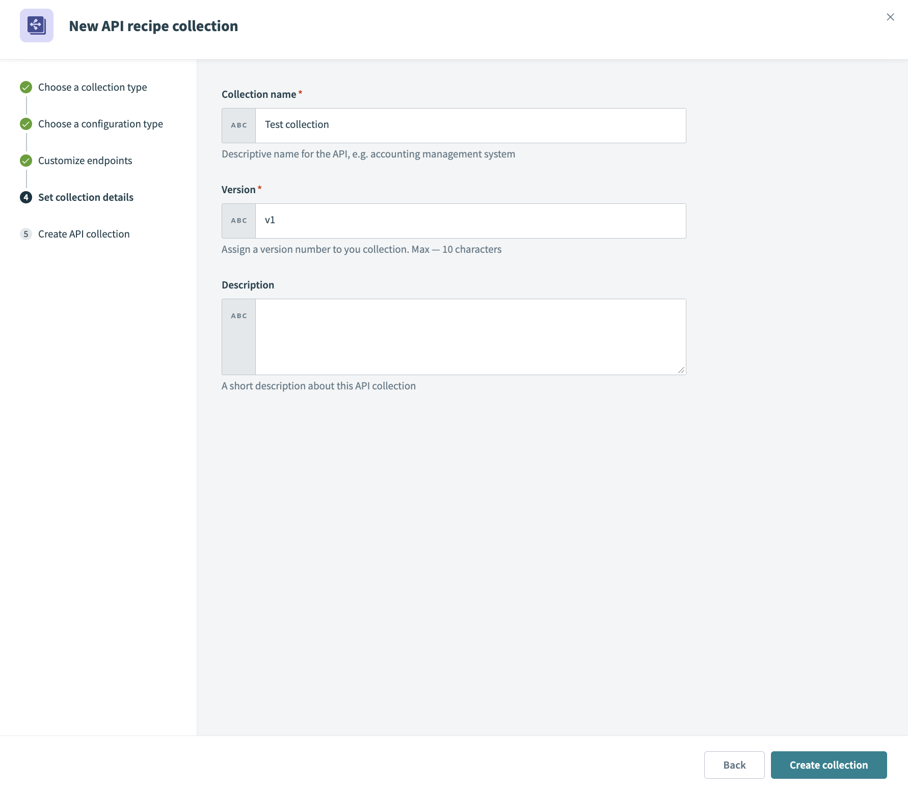

Create an API collection.
Create an API collection ​
This step creates a new API collection where you can store endpoints that you plan to use as MCP tools.
Go to Platform > API platform.
Click the API collections tab.
Click + Create new collection.
Ensure that API recipe collection is selected and then click Next.
Ensure that Use existing recipes is selected.
Use the Recipe folder drop-down menu to select the folder where you plan to store the API collection.
Deselect all endpoints.
Enter a name in the Collection name field.
Enter a version number for your collection. For example: v1.
Optional. Provide a description for the collection in the Description field.
Click Create collection.
Set collection detailsClick Create collection

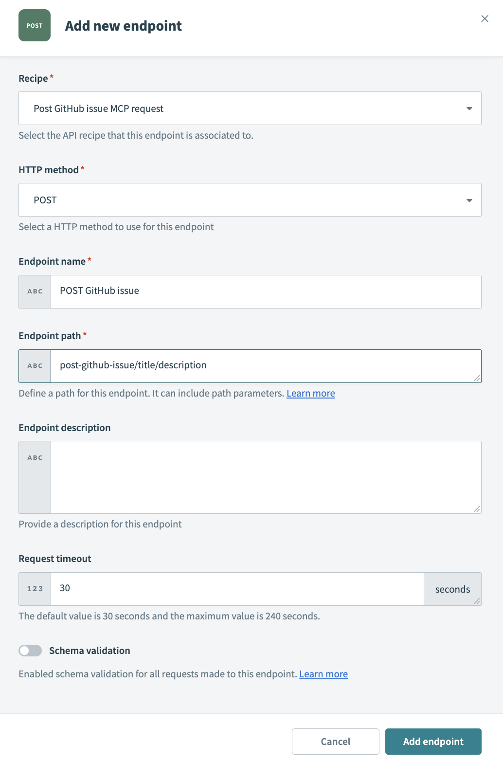

Create a new endpoint.
Create an endpoint ​
This step creates a new endpoint based on your API request recipe and stores it in your API collection.
Select the API collection you created in the preceding steps.
Click Create new endpoint.
Use the Recipe drop-down menu to select the API request recipe you created in the preceding steps.
Use the HTTP method drop-down menu to select POST.
Enter a name for your endpoint in the Endpoint name field.
Define a path for your endpoint in the Endpoint path field. Your endpoint path can include parameters. This use case uses the following endpoint path and parameters: post-github-issue/title/description. Don't include a \ in your endpoint path. This is automatically appended after you create the endpoint.
New endpointDefine a path for your endpoint
Optional. Provide a description in the Endpoint description field.
Optional. Set a timeout value in the Request timeout field. The default value is 30 seconds and the maximum value is 240 seconds.
Click Add endpoint.
