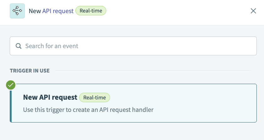

Set up your New API request trigger.
New API request trigger setup ​
This trigger defines how the MCP server calls your recipe and what parameters it expects.
Search for API platform by Workato and select it as your app.
Select the New API request trigger.
New API request triggerNew API request trigger

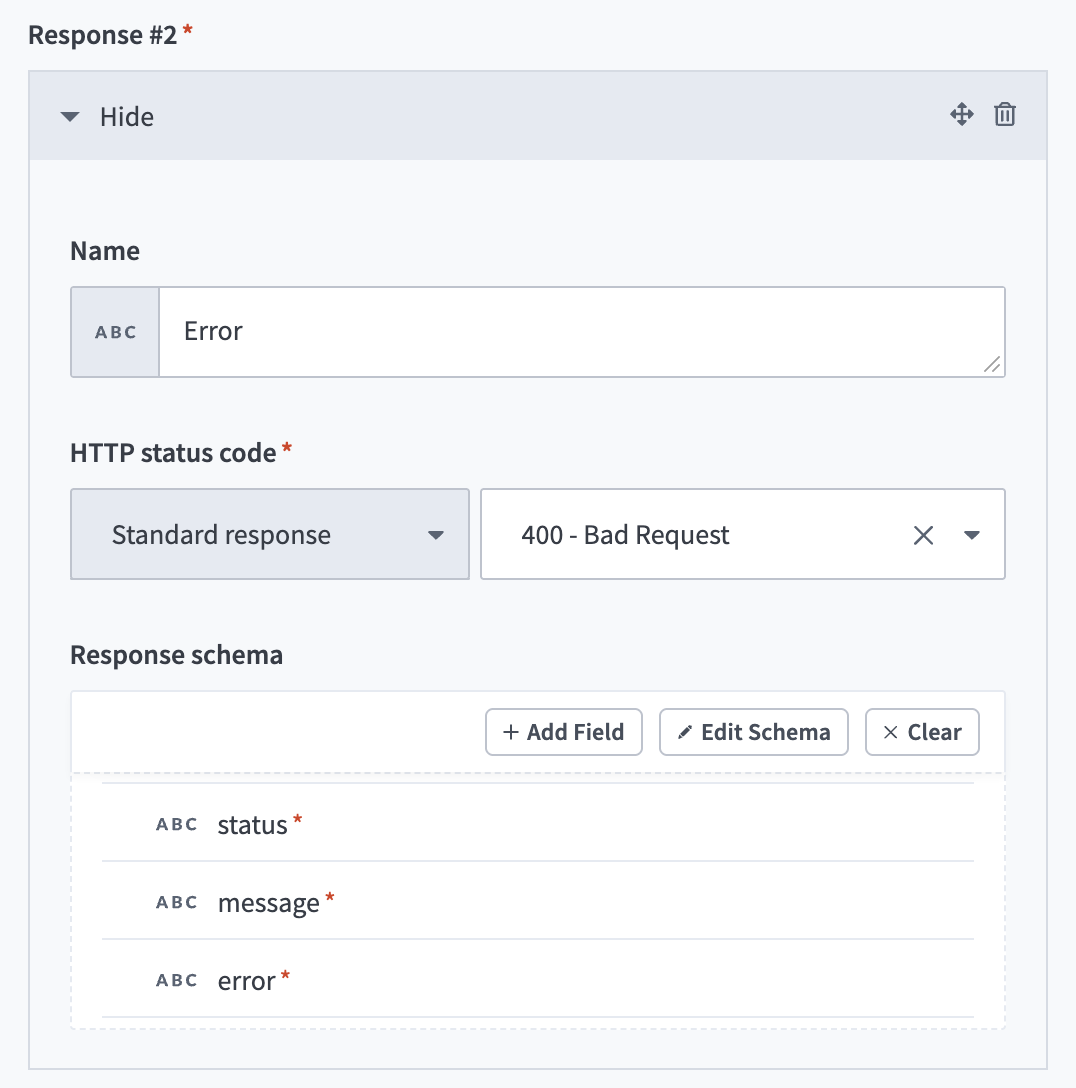

Complete the following steps to configure your error request response:
Return to the Responses section and click Add response.
Enter Error in the Name field.
Use the HTTPS status code standard response drop-down menu to select 400 - Bad request.
Go to the Response schema section and click add fields manually.
Enter status in the Name and Label fields.
Use the Data type drop-down menu to select String.
Use the Optional drop-down menu to select No.
Click Save.
Click +Add Field.
Enter message in the Name and Label fields.
12
13
Click Save.
14
Click +Add Field.
15
Enter error in the Name and Label fields.
16
17
18
Click Save.
Error request responseError request response

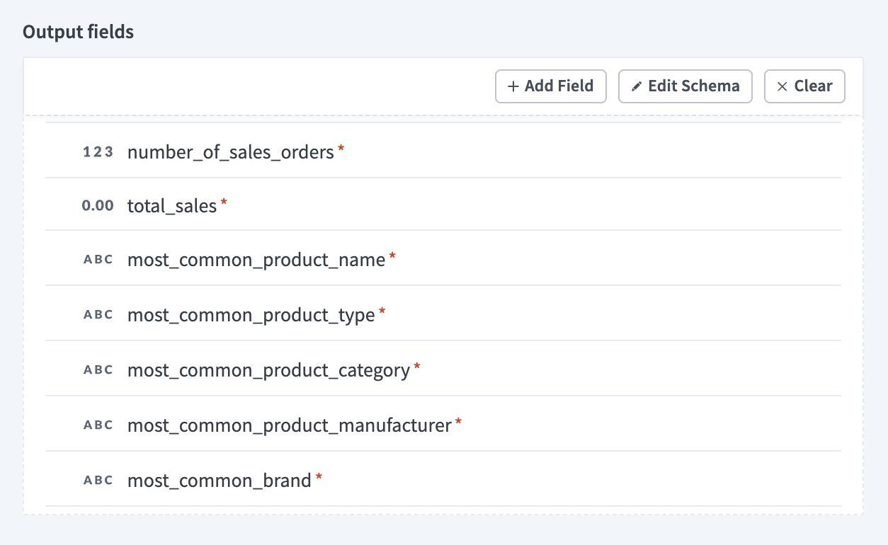

Complete the following steps to configure your output fields:
Go to the Output fields section and click + Add Field.
Enter number_of_sales_orders in the Name and Label fields.
Use the Data type drop-down menu to select Integer.
Click Save.
Click +Add Field.
Enter total_sales in the Name and Label fields.
Use the Data type drop-down menu to select Number.
Click Save.
Click +Add Field.
12
Enter most_common_product_name in the Name and Label fields.
13
14
15
Click Save.
16
Click +Add Field.
17
Enter most_common_product_type in the Name and Label fields.
18
19
20
Click Save.
21
Click +Add Field.
22
Enter most_common_product_category in the Name and Label fields.
23
24
25
Click Save.
26
Click +Add Field.
27
Enter most_common_product_manufacturer in the Name and Label fields.
28
29
30
Click Save.
31
Click +Add Field.
32
Enter most_common_brand in the Name and Label fields.
33
34
35
Click Save.
Snowflake Output fieldsSnowflake Output fields

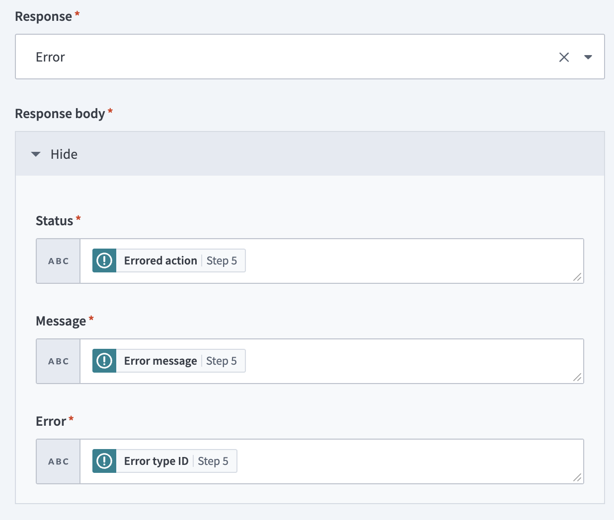

Click + Add step and select Handle errors.
Add actionClick Add step > Handle errors
Configure your ERROR FOUND? block.
Configure an ERROR FOUND? block ​
This step tells your recipe monitor the Run custom SQL action for errors. It instructs your LLM agent to respond with the 200 response or the Error response you configured in the New API request trigger response schema.
Complete the following steps to configure your ERROR FOUND? block:
Go to the Yes branch and ensure that Retry actions in Monitor block? is set to DO NOT RETRY.
Click + Add step under DO NOT RETRY.
Click Select an app and action. Search for and select API platform by Workato as your app.
Select Respond to API request as your action.
Use the Response drop-down menu to select Error.
Expand the Response body section.
Map the Errored actionStep 5 datapill to the Status field.
Map the Error messageStep 5 datapill to the Message field.
Map the Error type IDStep 5 datapill to the Error field.
Configure your ERROR FOUND? blockConfigure your ERROR FOUND? block
14
Use the Response drop-down menu to select 200.
15
16
Map the Snowflake number_of_sales_ordersStep 4 datapill to the number_of_sales_orders field.
17
Map the Snowflake total_salesStep 4 datapill to the total_sales field.
18
Map the Snowflake most_common_product_nameStep 4 datapill to the most_common_product_name field.
19
Map the Snowflake most_common_product_typeStep 4 datapill to the most_common_product_type field.
20
Map the Snowflake most_common_product_categoryStep 4 datapill to the most_common_product_category field.
200 success response body200 success response body
21
Map the Snowflake most_common_product_manufacturerStep 4 datapill to the most_common_product_manufacturer field.
22
Map the Snowflake most_common_brandStep 4 datapill to the most_common_brand field.
23
Click Save.

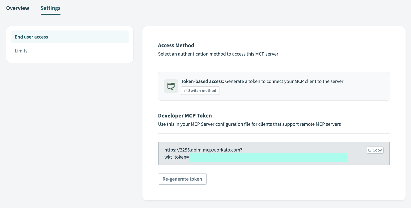

Click Settings > End user access.
Go to the Developer MCP Token section and click Copy to copy your MCP server URL and token for use in later steps.
Copy the MCP URLCopy the MCP URL

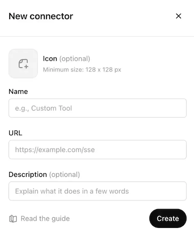

Go to Settings > Apps & Connectors.
Click Create. This button is only visible when the Developer mode toggle is enabled.
Enter a name for your MCP connector in the Name field.
ChatGPT connectorConfigure your ChatGPT MCP connector
Paste your MCP URL and token in the URL field.
Optional. Enter a description in the Description field.
Use the Authentication drop-down menu to select No Auth.
Select the checkbox to accept the risk of adding a custom MCP server.
Click Create.
Create a new chat in ChatGPT to use your MCP tools.

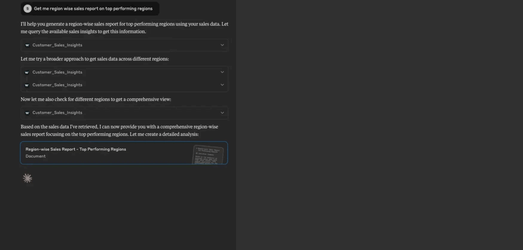

Test your MCP tool in your LLM.
Claude example chatClaude example chat
