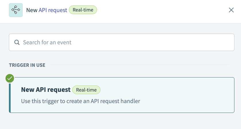

Search for API platform by Workato and select it as your app.
Select the New API request trigger.

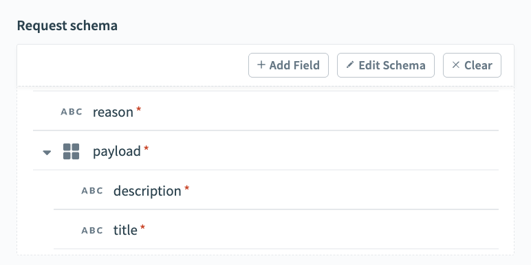

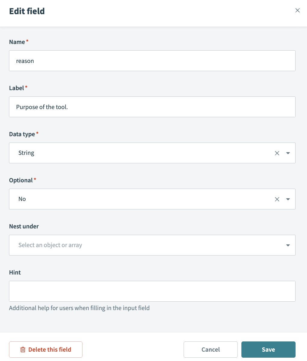

Complete the following steps to configure your request schema:
Go to the Request schema section and click + Add Field.
Enter reason in the Name and Label fields.
Use the Data type drop-down menu to select String.
Use the Optional drop-down menu to select No.
Reason field
Click Save.
Return to the Request schema section and click + Add Field.
Enter payload in the Name and Label fields.
Use the Data type drop-down menu to select Object.
Click Save.
Enter description in the Name and Label fields.
Use the Nest under drop-down menu to select payload.
Click Save.
Enter title in the Name and Label fields.
Click Save.
Request schema

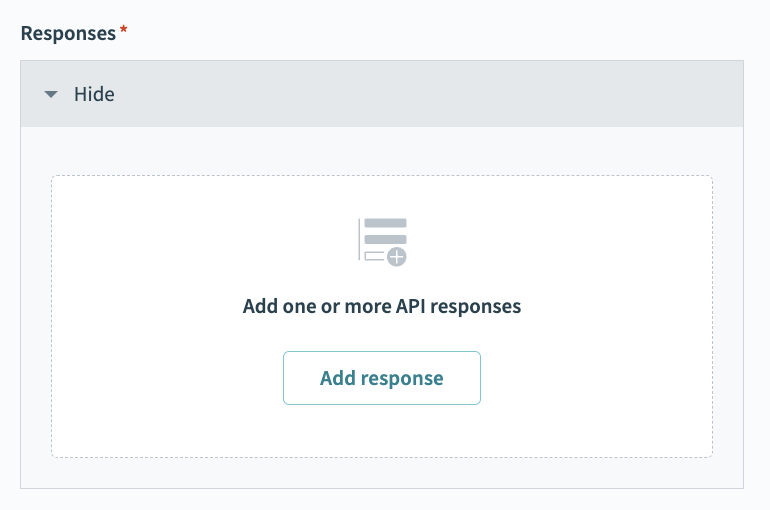

Complete the following steps to configure your request responses:
Go to the Responses section and click Add response.
Click Add response
Enter 200 in the Name field.
Use the HTTPS status code standard response drop-down menu to select 200 - OK.

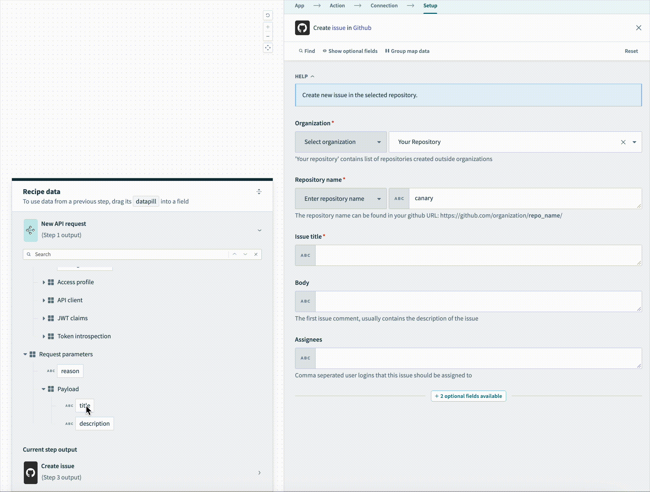

Search for GitHub and select it as your app.
Select the Create issue action.
Go to Organization and ensure that Select organization is selected.
Use the Select organization drop-down menu to select the GitHub organization you plan to use.
Go to Repository name and use the drop-down menu or manually enter the GitHub repository you plan to use.
Map the titleStep 1 datapill to the Issue title field.
Map the descriptionStep 2 datapill to the Body field.
Click Save.

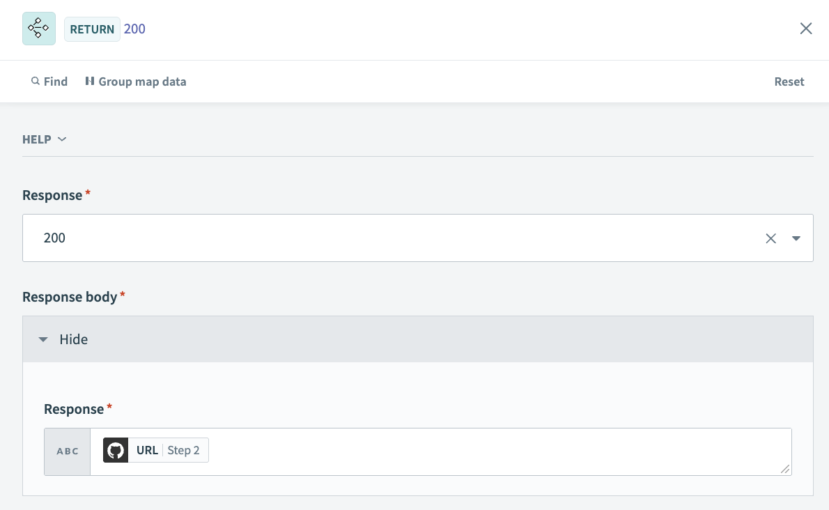

Set up your Respond to API request action.
Respond to API request action setup
This step instructs your LLM agent to respond with the 200 response you configured in the New API request trigger response schema. It also tells the LLM to include the newly created issue URL in the response.
Select the Respond to API request action.
Use the Response drop-down menu to select 200. This is the response you configured in the New API request trigger setup.
Expand the Response body section.
Map the GitHub URLStep 2 datapill to the Response field. This instructs your LLM to provide the URL link to the new issue in your chat.
Click Save.

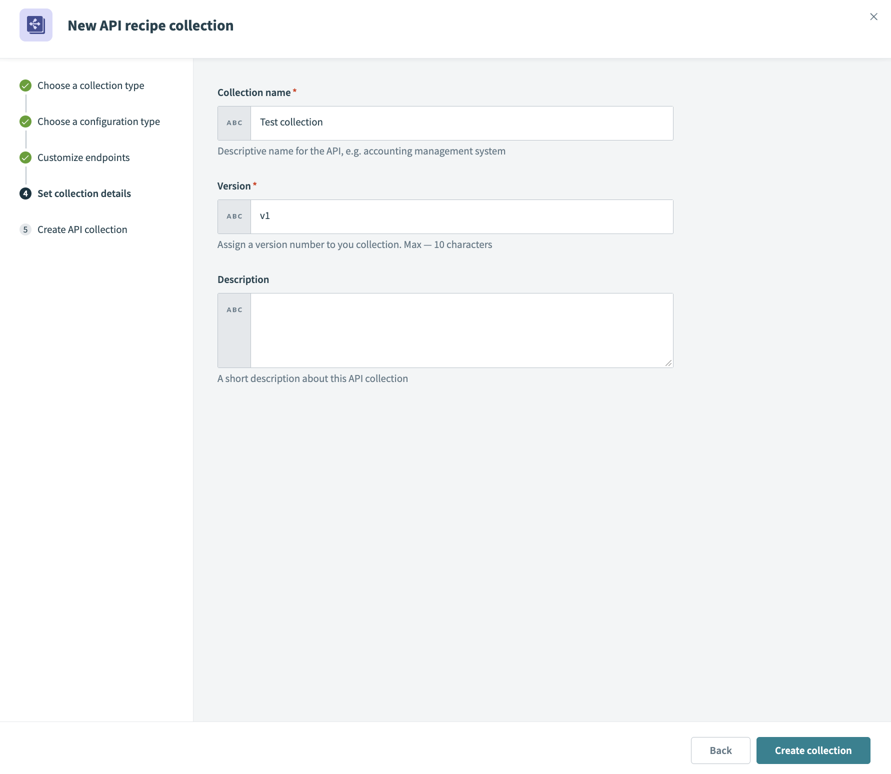

Click + Create new collection.
Ensure that API recipe collection is selected and then click Next.
Ensure that Use existing recipes is selected.
Use the Recipe folder drop-down menu to select the folder where you plan to store the API collection.
Deselect all endpoints.
Enter a name in the Collection name field.
Enter a version number for your collection. For example: v1.
Optional. Provide a description for the collection in the Description field.
Click Create collection.

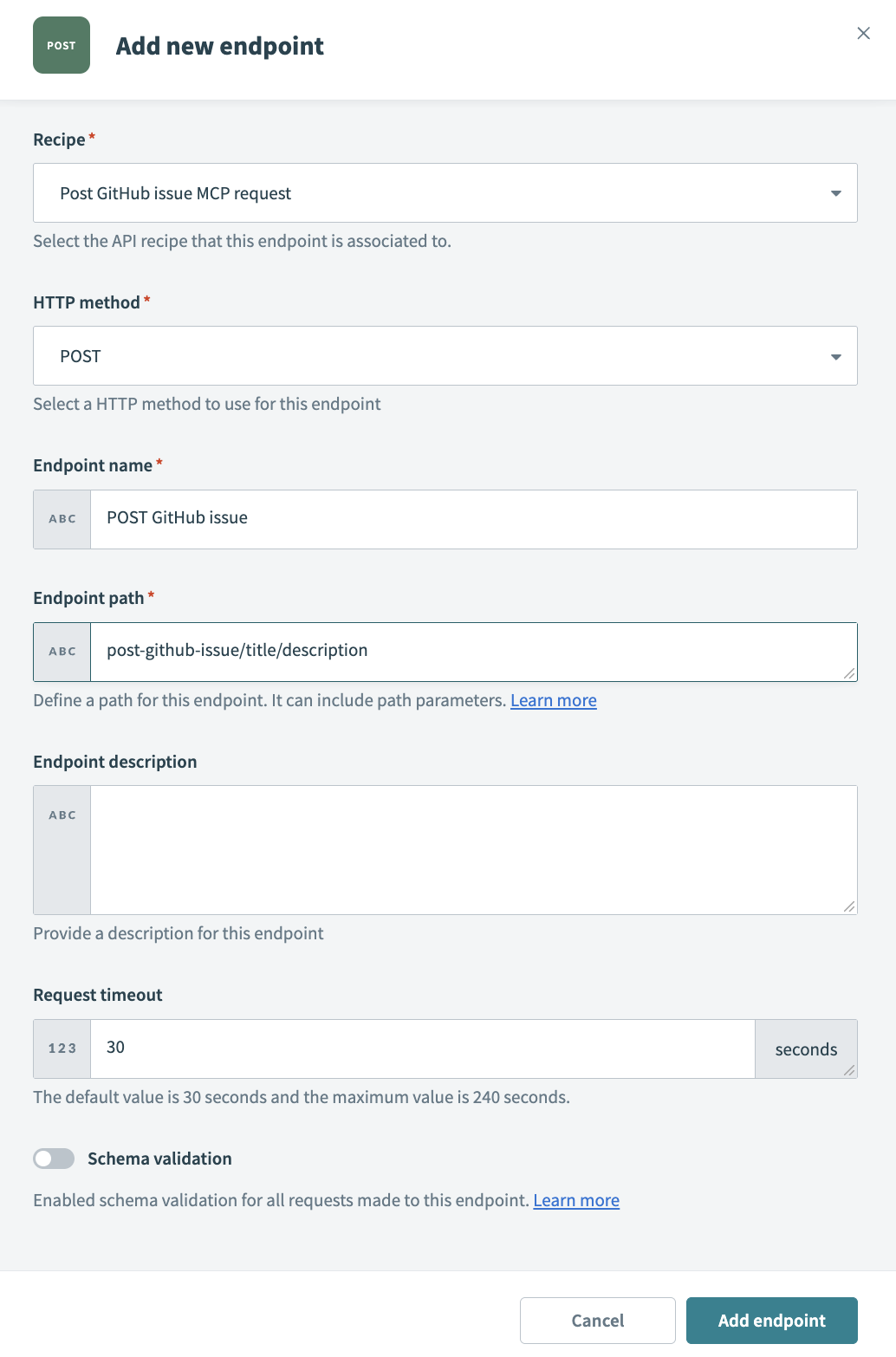

Click Create new endpoint.
Use the Recipe drop-down menu to select the API request recipe you created in the preceding steps.
Use the HTTP method drop-down menu to select POST.
Enter a name for your endpoint in the Endpoint name field.
Define a path for your endpoint in the Endpoint path field. Your endpoint path can include parameters. This use case uses the following endpoint path and parameters: post-github-issue/title/description. Don't include a \ in your endpoint path. This is automatically appended after you create the endpoint.
Optional. Provide a description in the Endpoint description field.
Optional. Set a timeout value in the Request timeout field. The default value is 30 seconds and the maximum value is 240 seconds.
Click Add endpoint.

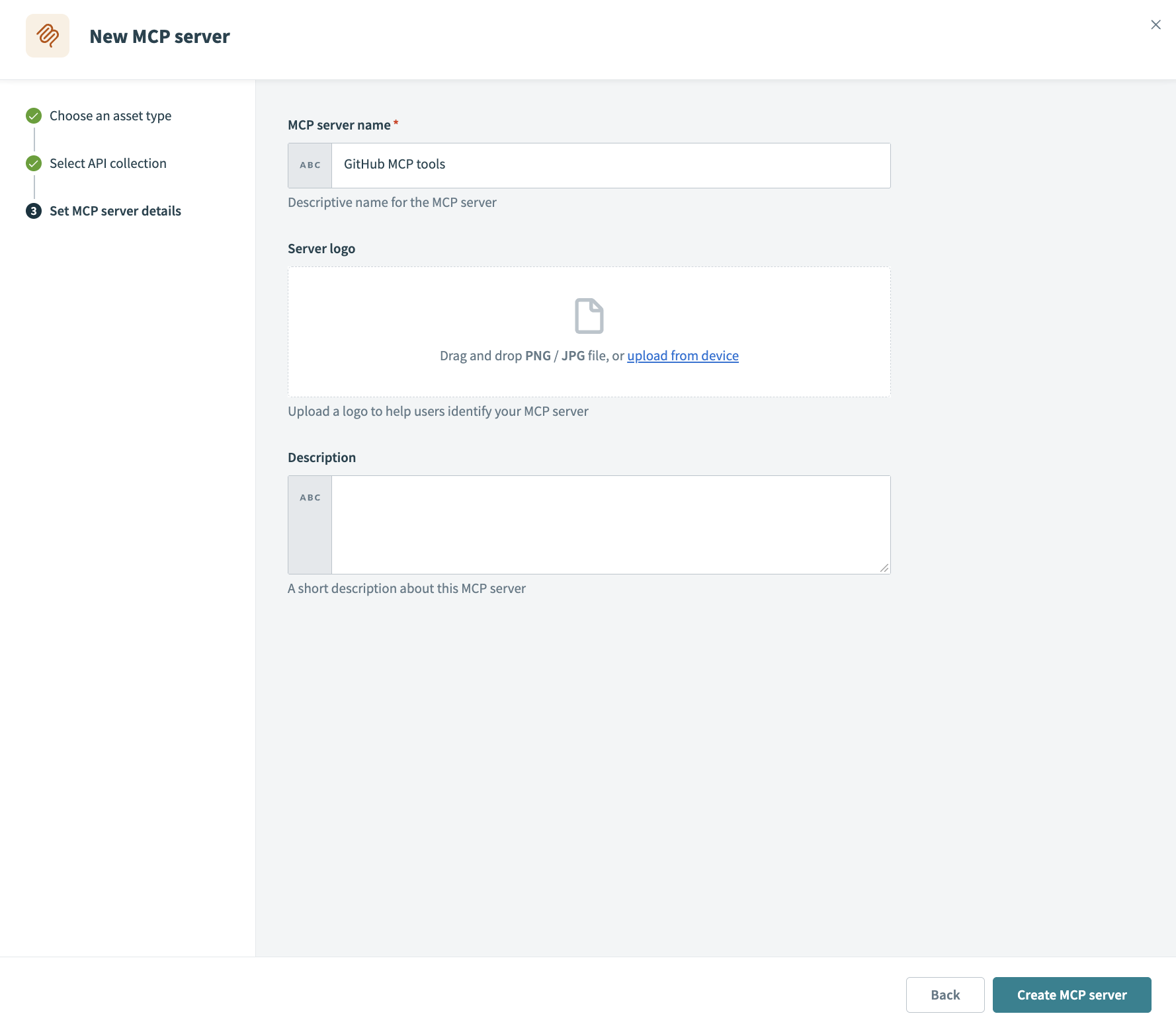

Go to AI Hub > Enterprise MCP > Custom servers and click + Create an MCP server. Alternatively, you can create an MCP server from the Projects page by clicking Create > MCP server or pressing C+M.
Select New MCP server.
Enter a name for your MCP server in the Server name field. For example: GitHub MCP tool.
Optional. Provide a description of the MCP server in the Describe how this MCP server will be used field.
Use the Location drop-down menu to select the project that contains the API recipe.
Select API collection as your asset type.
Select the API collection you created in the preceding steps.
Click Start building. Your MCP server information displays in the Details tab.

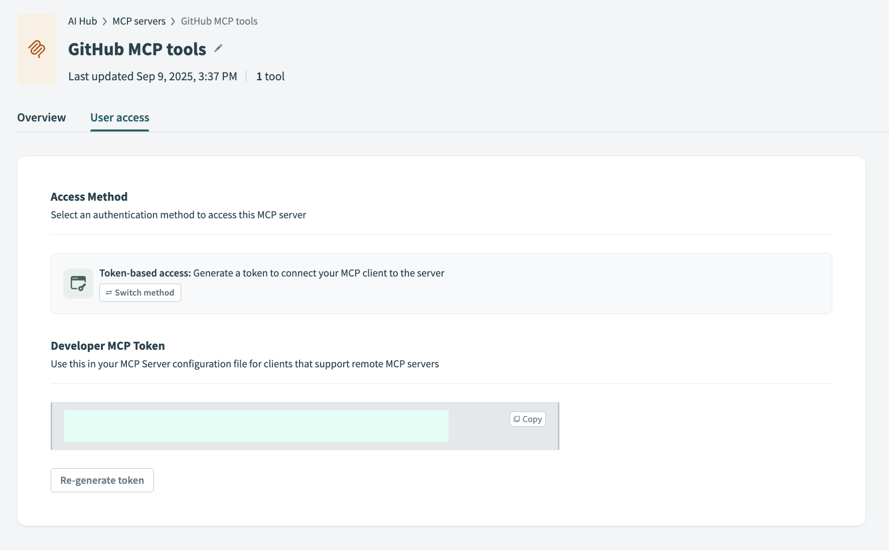

Click Settings > End user access.
Go to the Developer MCP Token section and click the Copy button to copy your MCP server URL and token for use in later steps.
Copy the MCP URL

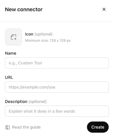

Enter a name for your MCP connector in the Name field.
Configure your ChatGPT MCP connector
Paste your MCP URL and token in the URL field.
Optional. Enter a description in the Description field.
Use the Authentication drop-down menu to select No Auth.
Select the checkbox to accept the risk of adding a custom MCP server.
Click Create.

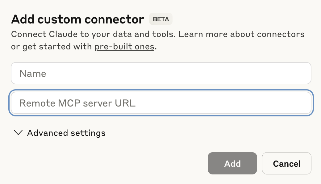

Go to Settings > Connectors.
Click + Add new connector.
Configure your Claude MCP connector
Paste your MCP URL and token into the Remote MCP server URL field.
Click Add. The newly created MCP connector appears in the list of connectors.

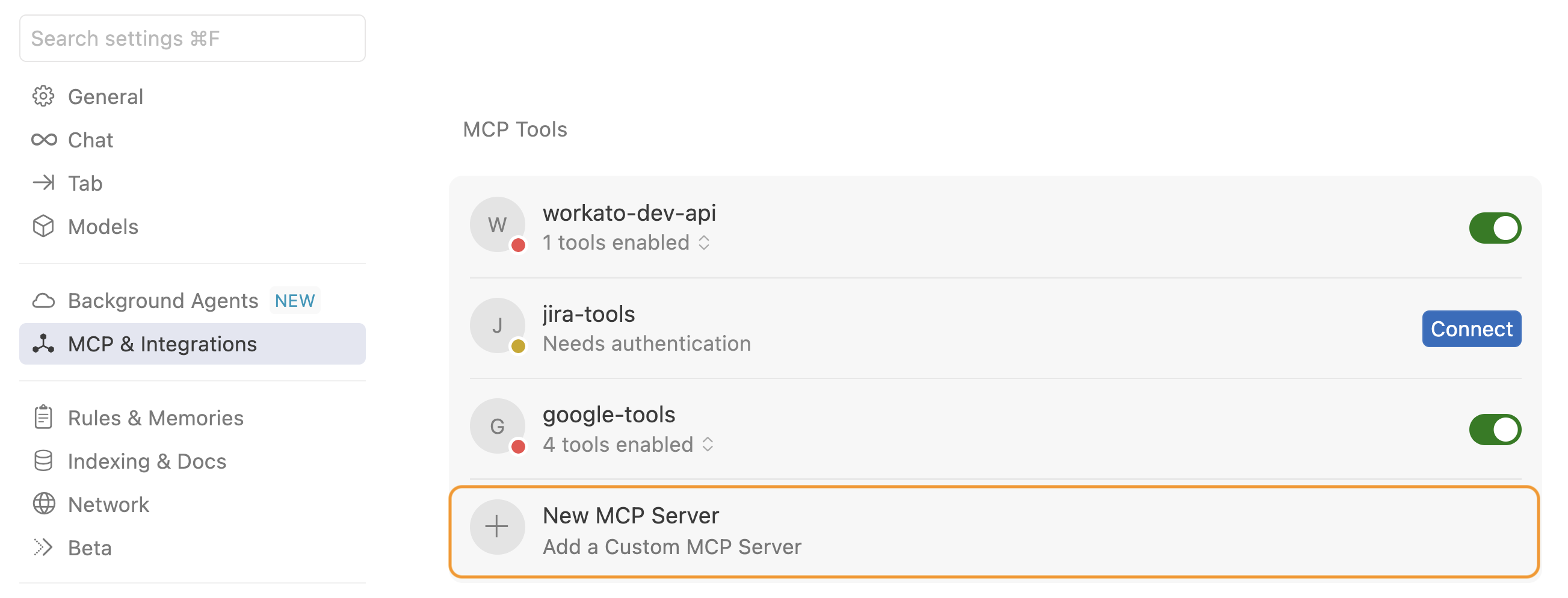

Go to Settings > Cursor settings.
Click MCP & Integrations in the sidebar.
Click + New MCP Server to open the mcp.json file.
