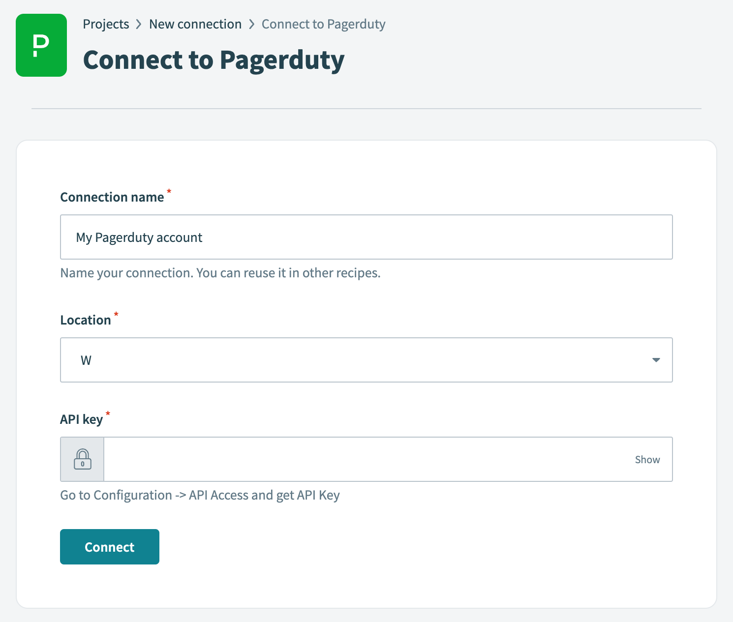

Create a PagerDuty connection
This step creates a connection between Workato and your PagerDuty account.
Search for and select PagerDuty on the New connection page.
PagerDuty connection setupPagerDuty connection setup
Enter your API key in the API key field.
To create a new API key in PagerDuty, go to Integrations > API Access Keys and click + Create New API Key. Don't select the Read-only API Key checkbox because this connector requires both read and write permissions.
Alternatively, to create an API user token that provides the same permissions as your user account, go to My Profile > User Settings and click Create API User Token.

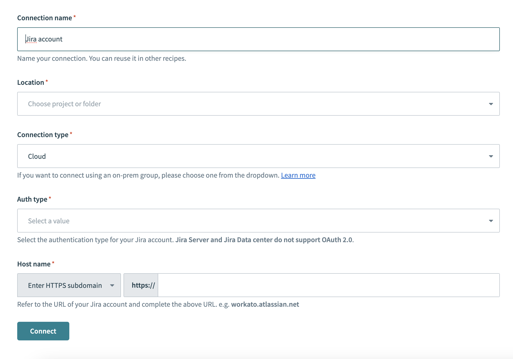

Create a Jira connection
This step creates a connection between Workato and your Jira account.
Search for and select Jira on the New connection page.
Enter a name for your Jira connection in the Connection name field.
Jira connection setupJira connection setup
Select your Connection type.
Use the Auth type drop-down menu to select your authentication method. Supported options include Basic, API token, OAuth 2.0, and Personal access token.
Provide your Host name. For example, if your Jira URL is https://acme.atlassian.net, your host name is acme.atlassian.net.
Click Start building.

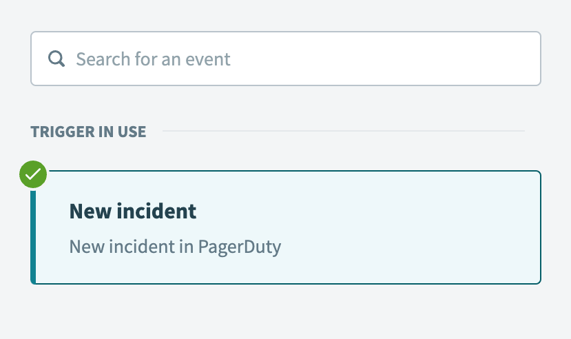

Set up your PagerDuty New incident trigger.
Set up PagerDuty New incident trigger
This trigger monitors PagerDuty for new incidents. The trigger checks for new incidents at a set interval and retrieves incidents created since the recipe started or from a specified time.
Search for PagerDuty and select it as your app.
Choose PagerDutyChoose PagerDuty
Select the New incident trigger.
Select the New incident triggerSelect the New incident trigger

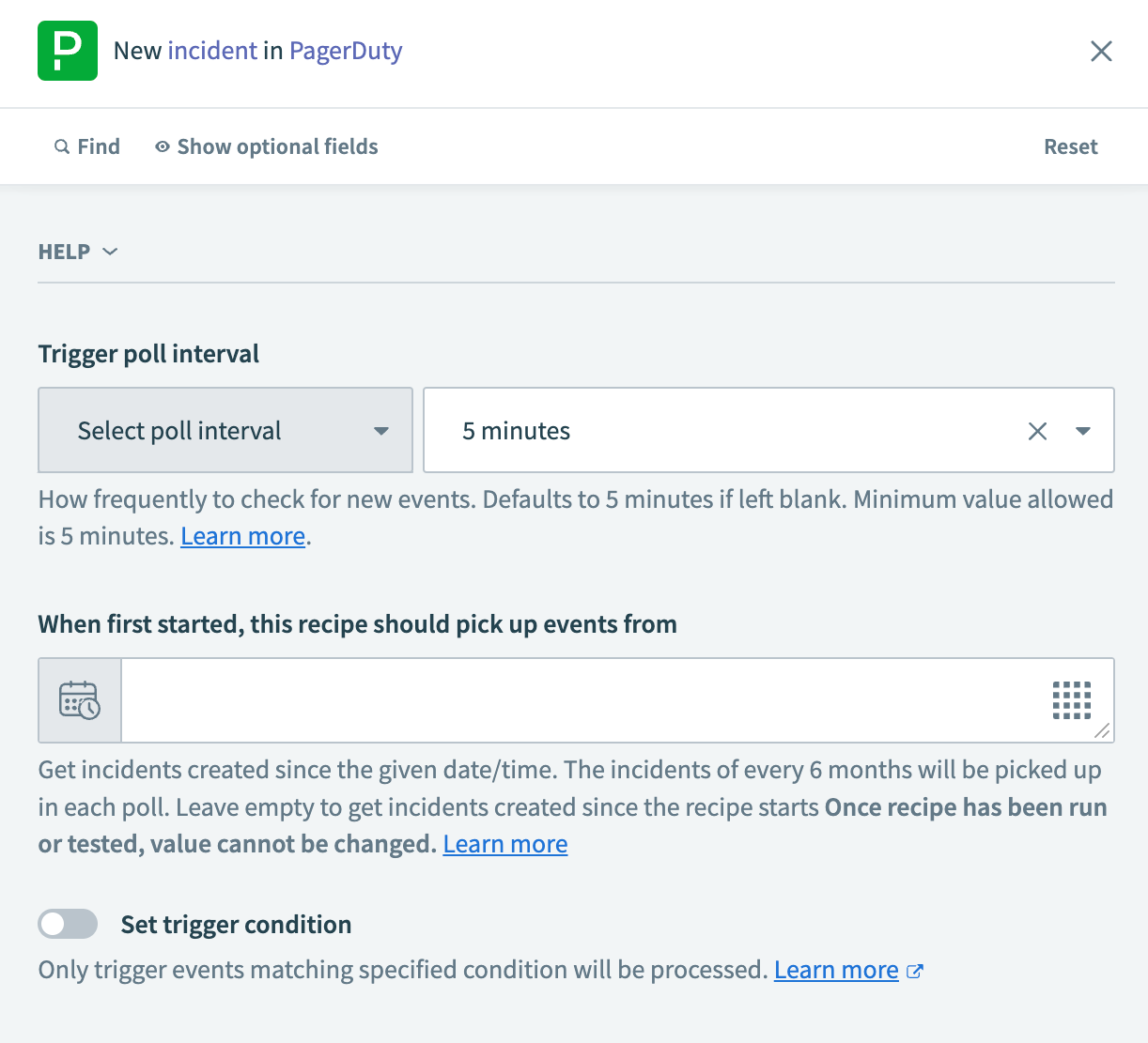

Select the PagerDuty connection you created in the preceding steps.
Optional. Specify how frequently the recipe should check for new events in the Trigger poll interval field. This field defaults to five minutes if left blank.
Optional. Use the When first started, this recipe should pick up events from field to specify the date and time from which the recipe should retrieve incidents. Leave this field blank to retrieve incidents created after the recipe starts. After you run or test this recipe, you can't change this value. Refer to Triggers to learn more about this input field.
Configure the New incident triggerConfigure the New incident trigger
Click Save.

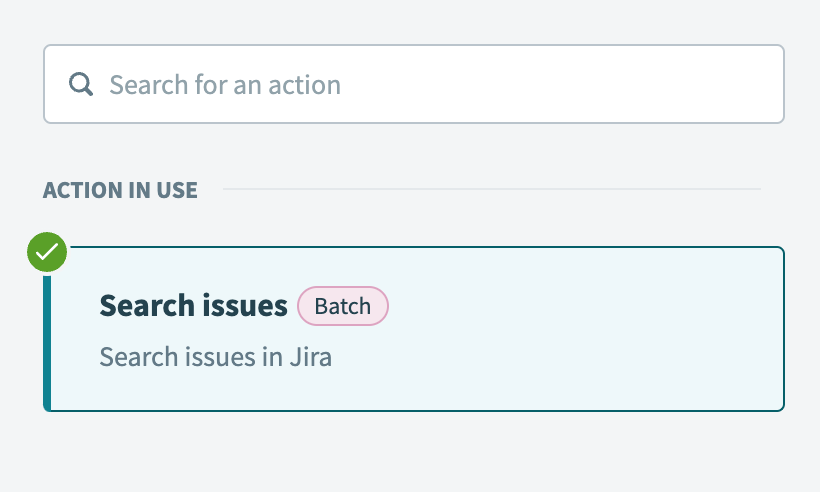

Set up your Jira Search issues batch action.

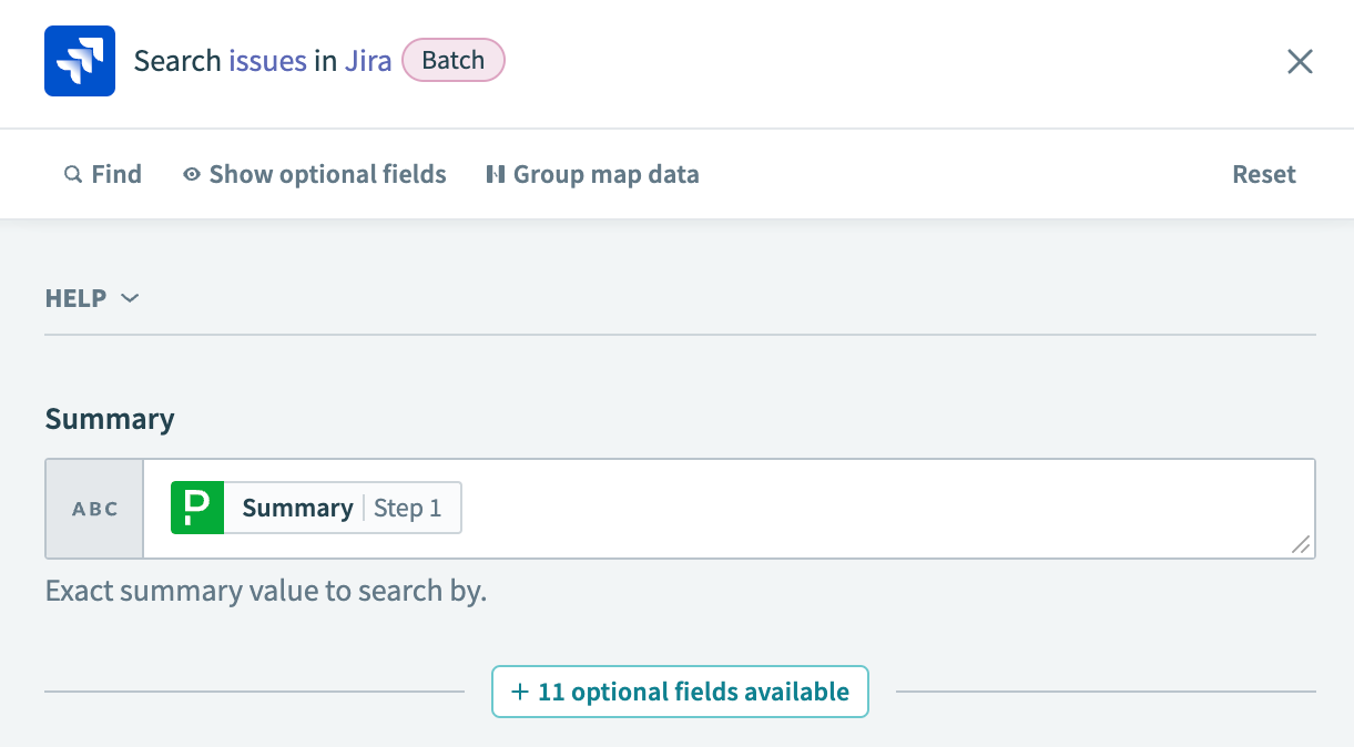

Set up Jira Search issues batch action
This step searches for a Jira issue with a summary that matches the PagerDuty incident's summary.
Search for Jira and select it as your app.
Choose JiraChoose Jira
Select the Search issues action.
Select the Search issues batch actionSelect the Search issues batch action
Map the PagerDuty SummaryStep 1 datapill to the Summary field.
Map the Summary datapillMap the SummaryStep 1 datapill
Click Save.

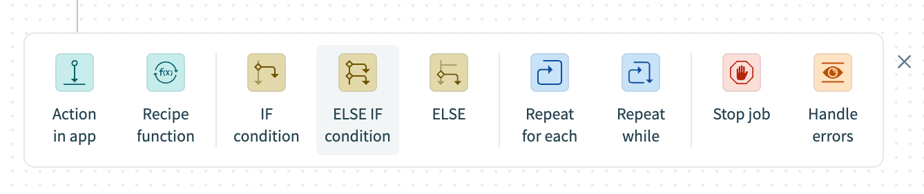

Click + Add step and select IF condition.
Add IF conditionClick Add step > IF condition

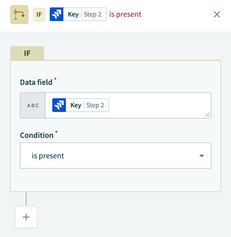

Set up your Jira and PagerDuty IF condition.
Set up a Jira and PagerDuty IF condition
This step checks whether the Search issues action found a Jira issue with a summary matching the new PagerDuty incident.
Map the Jira KeyStep 2 datapill to Data field.
Select is present in the Condition field.
Configure your IF conditionConfigure your IF condition
Click Save.

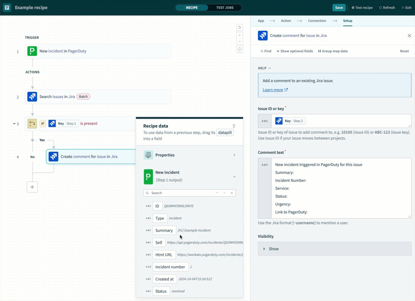

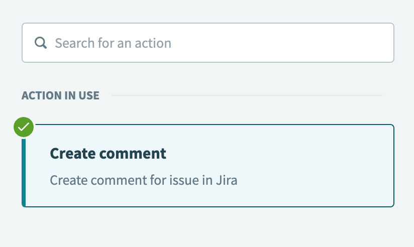

Set up your Jira Create comment action.
Set up Jira Create comment action
This step adds a comment to the matched Jira issue with the relevant details from PagerDuty.
Select the Create comment action.
Select the Create comment actionSelect the Create comment action
Map the Jira KeyStep 2 datapill to the Issue ID or key field.
Map the Key datapillMap the KeyStep 2 datapill
Add the following text to the Comment text field:
plaintext
New incident triggered in PagerDuty for this issue
Summary:
Incident number:
Service:
Status:
Urgency:
Link to PagerDuty:
Map the relevant PagerDuty datapills to each line in the Comment text field:
  • SummaryStep 1
  • Incident numberStep 1
  • SummaryStep 1 (nested under the Service object)
  • StatusStep 1
  • UrgencyStep 1
  • Html URLStep 1
Map datapills to the Comment text fieldMap datapills to the Comment text field
Click Save.

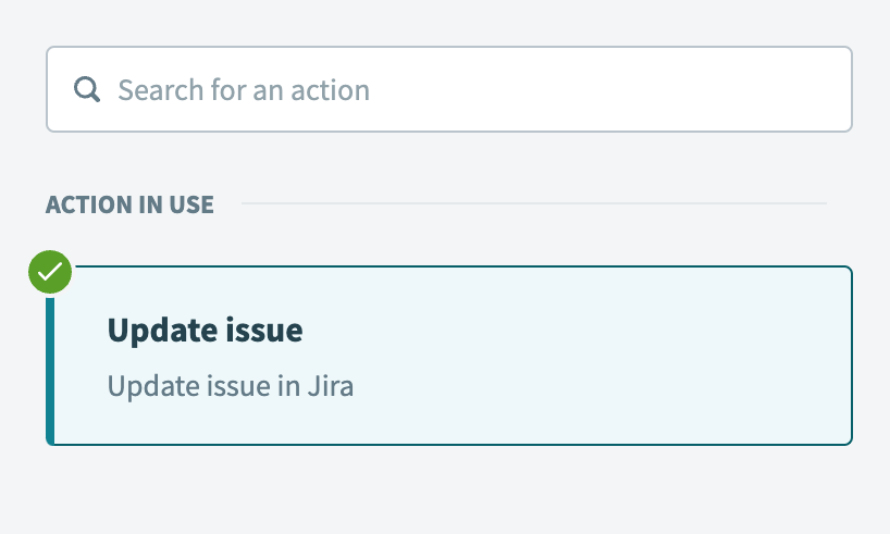

Set up your Jira Update issue action.
Set up Jira Update issue action
This final step in the IF condition updates the Jira issue's priority to match the PagerDuty incident. You can configure additional fields in this action to further update the issue.
Select the Update issue action.
Select the Update issue actionSelect the Update issue action

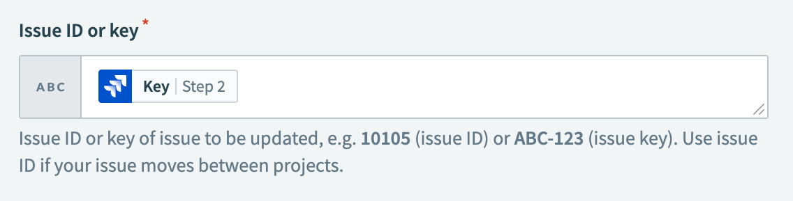

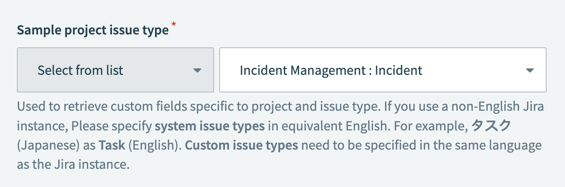

Use the Sample project issue type drop-down menu to select the issue type in your Jira project that you plan to update. This field retrieves custom fields specific to your project and issue type.
For example, in a Jira project named Incident Management, select the Incident issue type.
Select a sample project issue typeSelect a sample project issue type

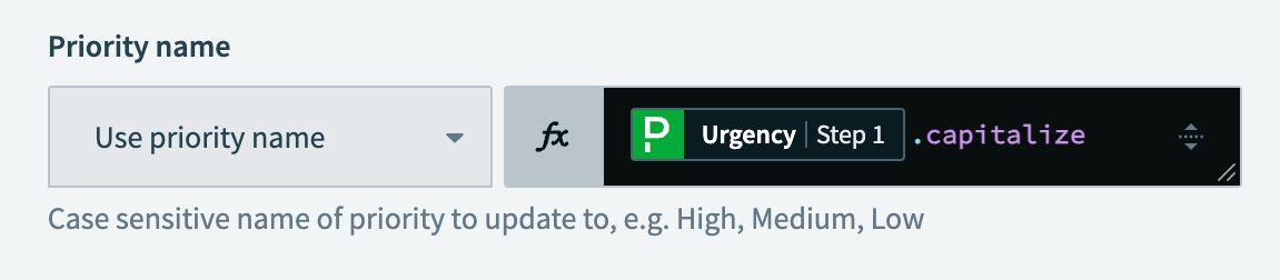

Switch the Priority name field to formula mode and perform the following actions:
Map the PagerDuty UrgencyStep 1 datapill.
Configure the Priority name fieldConfigure the Priority name field

Click + Add step and select ELSE IF condition.
Add ELSE IF conditionClick Add step > ELSE IF condition

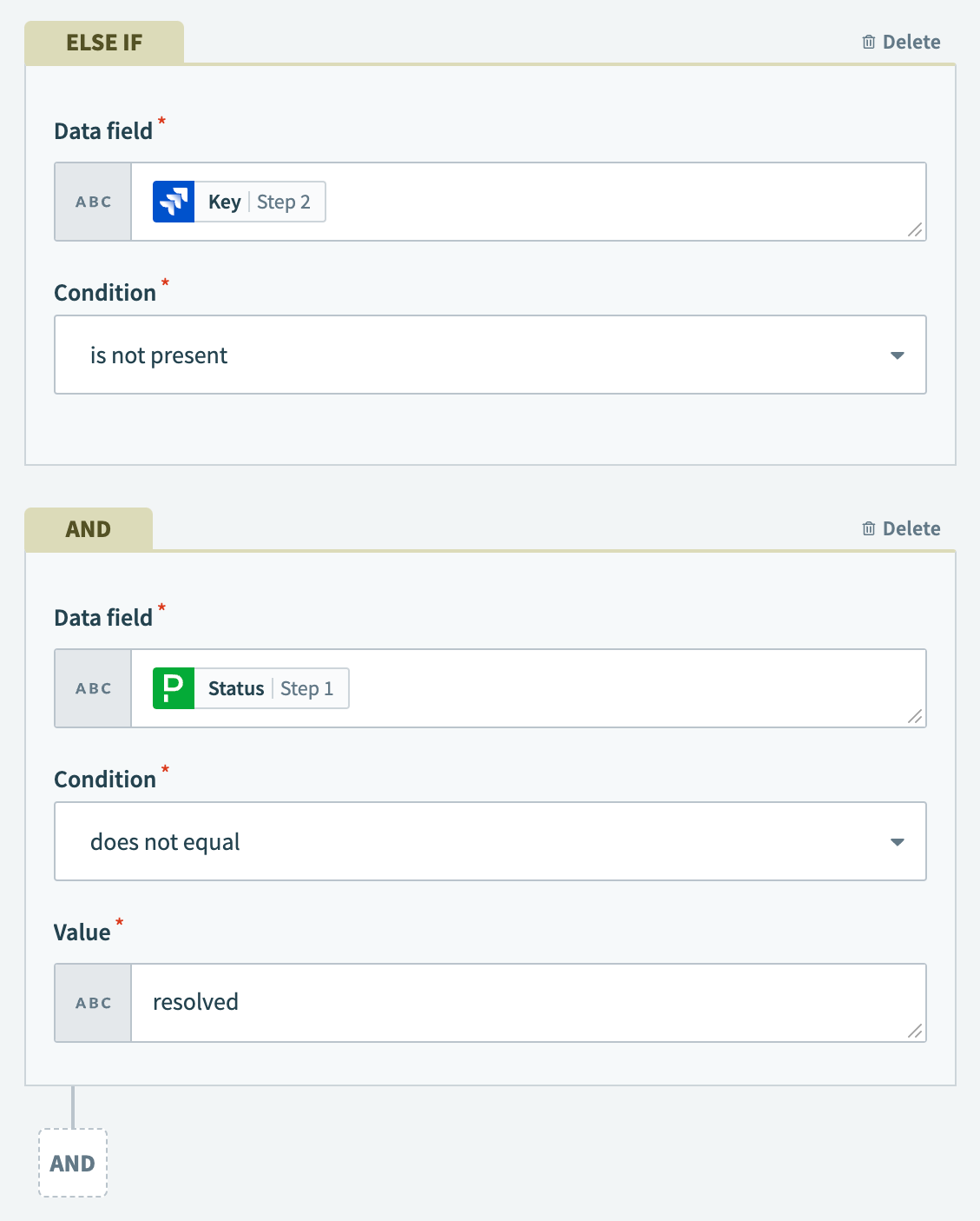

Set up your Jira and PagerDuty ELSE IF condition.
Set up a Jira and PagerDuty ELSE IF condition
This step sets up an ELSE IF condition to check if there is no matching Jira issue for the PagerDuty incident and if the incident isn't resolved. The AND condition ensures that the recipe doesn't sync resolved PagerDuty incidents to Jira as new active issues.
Select is not present in the Condition field.
Click + (plus) and select AND to add a second condition.
Map the PagerDuty StatusStep 1 datapill to Data field.
Select does not equal in the Condition field.
Type resolved in the Value field.
Configure your ELSE IF conditionConfigure your ELSE IF condition
Click Save.

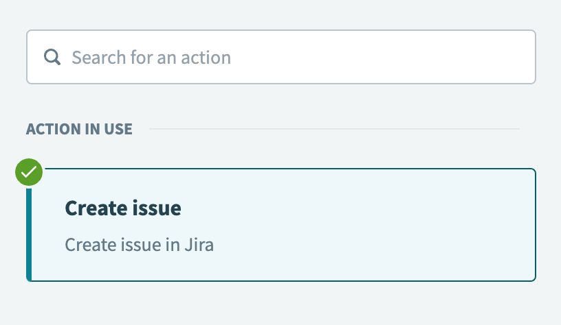

Select the Create issue action.
Select the Create issue actionSelect the Create issue action
This final step in the recipe adds a comment to the new Jira issue with the relevant details from PagerDuty.

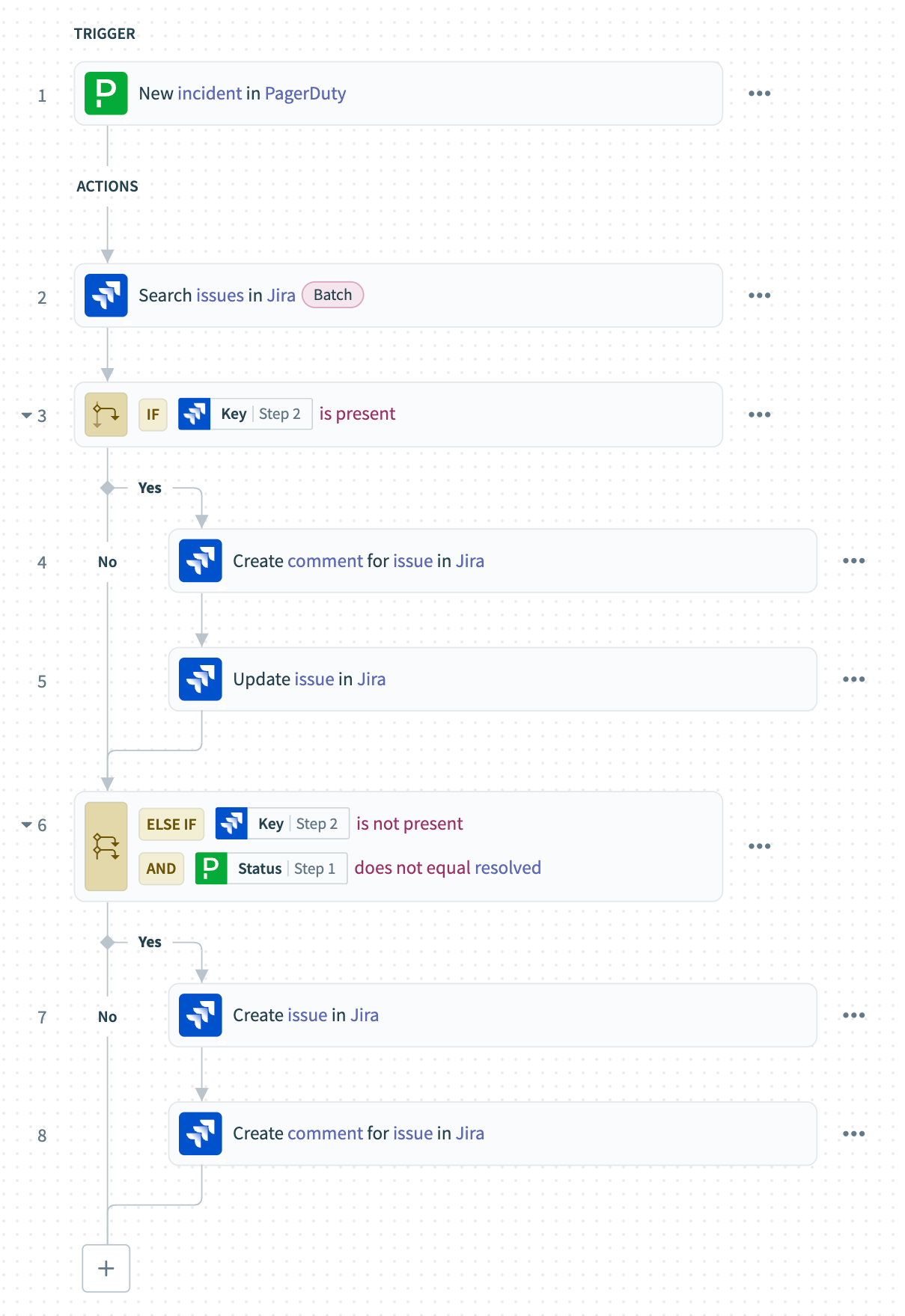

Your Create or update Jira issues from new PagerDuty incidents recipe is ready to test and implement.
Example recipe configuration.
PagerDuty and Jira recipeCreate or update Jira issues from new PagerDuty incidents recipe
