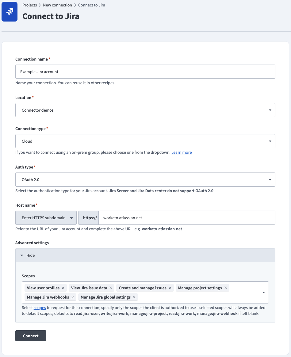

You must generate an Atlassian client ID and client secret if you plan to connect to Jira Data Center using OAuth 2.0. Refer to the Atlassian Configure an incoming link guide to generate these values using https://www.workato.com/oauth/callback as the redirect URI.
Connect to Jira using OAuth 2.0
Complete the following steps to connect to Jira in Workato using OAuth 2.0:
Search for and select Jira as your connection on the New connection page.
OAuth 2.0 auth
Use the Connection type drop-down menu to select your connection type.
Use the Auth type drop-down menu to select OAuth 2.0 (Cloud - Atlassian-hosted Jira), or select OAuth 2.0 (Data Center) to connect to an on-prem Jira instance.
Enter the URL subdomain for your Jira instance in the Host name field. For example: workato.atlassian.net
Go to the Advanced settings section and enter your Atlassian Client ID and Client secret if you're connecting to an on-prem Jira instance. Refer to the Prerequisites section to generate these values.
Optional. Use the Scopes drop-down menu to select the authorization scopes to request. Workato requests the following scopes by default:
Cloud-hosted Jira defaults:
read:jira-userwrite:jira-workmanage:jira-projectread:jira-workmanage:jira-webhook
Jira Data Center defaults:
READWRITE
Click Connect and sign in to your Jira instance.
Authorize Workato's request to access your Jira instance.

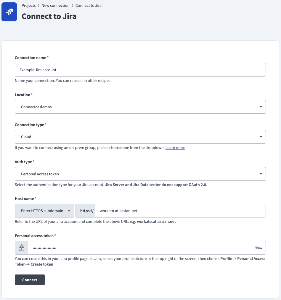

Personal access tokens (PATs) authenticate your Atlassian account without using a username and password. PAT authentication supports on-premise Jira connections.
Prerequisites
You must generate an Atlassian personal access token for this authentication method. Refer to the Atlassian Using Personal Access Tokens guide for more information.
Connect to Jira using a personal access token
Complete the following steps to connect to Jira in Workato using a personal access token:
Personal access token auth
Use the Auth type drop-down menu to select Personal access token.
Enter the Personal access token of the Jira account to link to Workato. Refer to the Atlassian Using Personal Access Tokens guide to generate this value.
