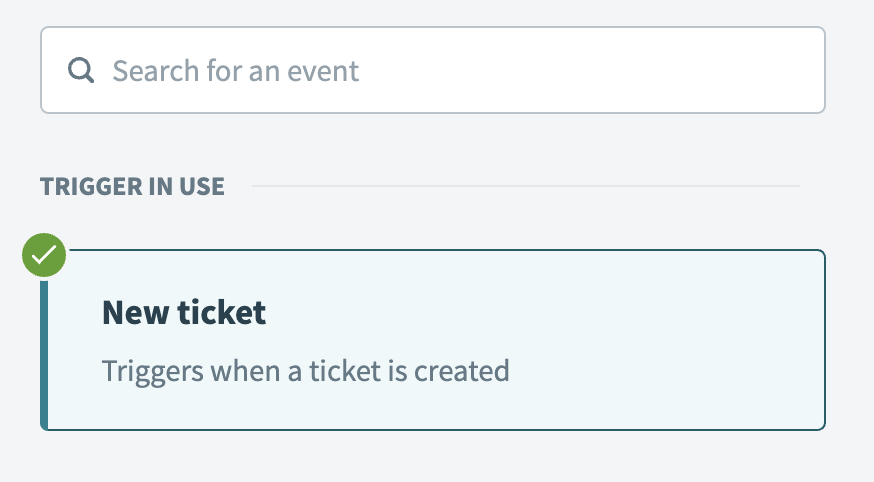

Select the New ticket trigger.
Select the New ticket triggerSelect the New ticket trigger

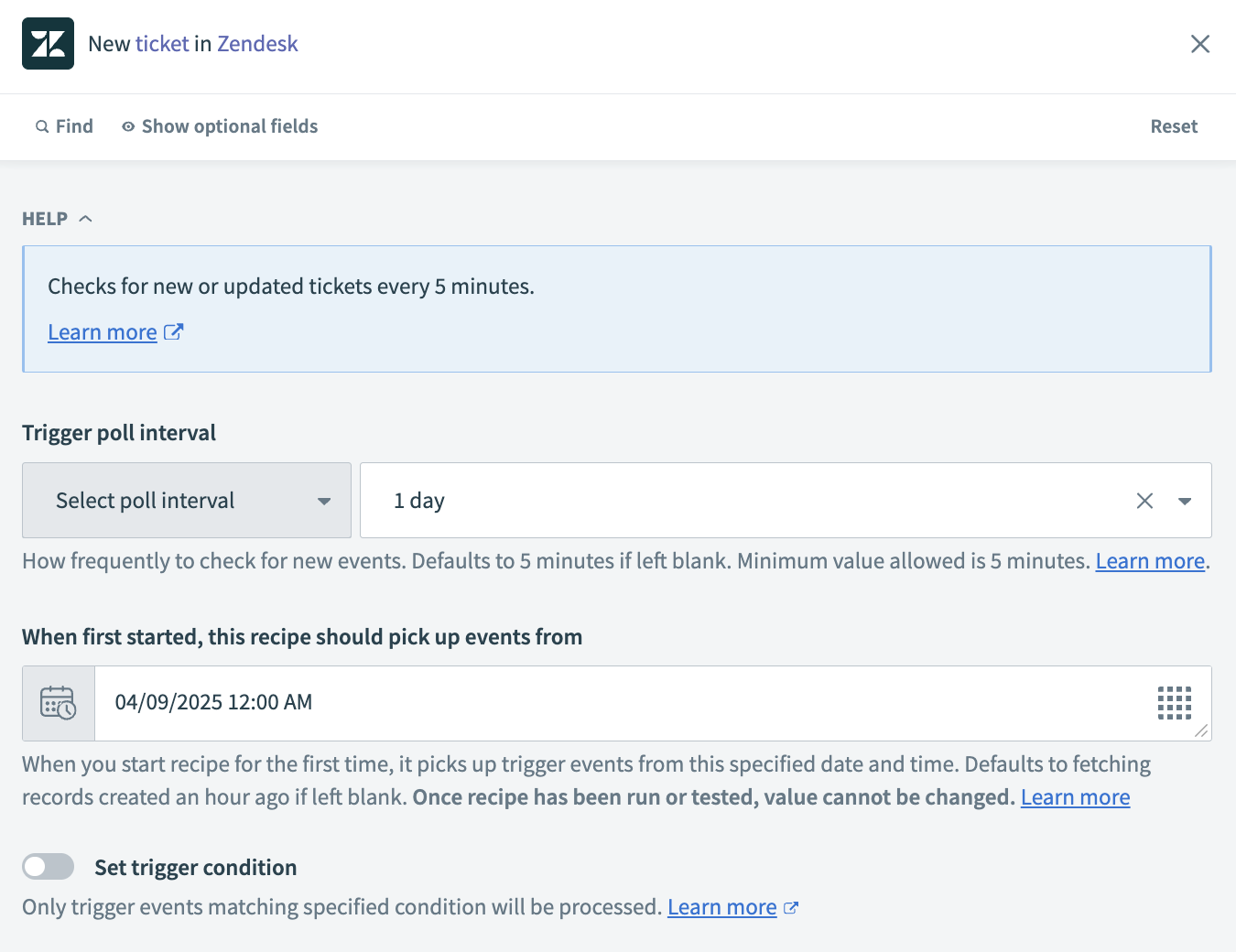

Optional. Specify how frequently the trigger checks for new events in the Trigger poll interval field. This field defaults to five minutes if left blank.
Configure the Trigger poll intervalConfigure the Trigger poll interval
Optional. Set the date and time to start picking up trigger events from in the When first started, this recipe should pick up events from field. This enables your recipe to capture past events. Leave this field empty to fetch events from the last hour. You can't change this value after you run or test the recipe. Refer to Triggers to learn more about this input field.

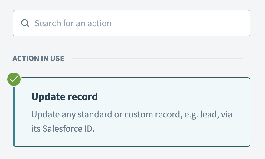

Select the Update record action.
Select the Update record actionSelect the Update record action

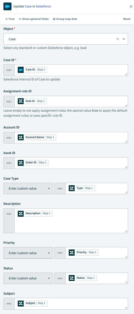

Go to the Object field and search for Case.
Map the Case IDStep 2 datapill to the Case ID field.
Map the Rule IDStep 1 datapill to the Assignment rule ID field.
Map the Account NameStep 1 datapill to the Account ID field.
Map the Order IDStep 1 datapill to the Asset ID field.
Map the TypeStep 1 datapill to the Case Type field.
Map the DescriptionStep 1 datapill to the Description field.
Map the PriorityStep 1 datapill to the Priority field.
Map the StatusStep 1 datapill to the Status field.
12
Map the SubjectStep 1 datapill to the Subject field.
13
Click Save.

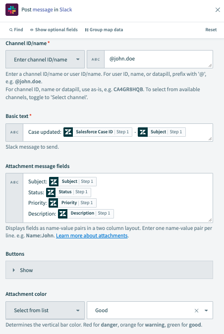

Select the Post message action.
Select the Post message actionSelect the Post message action
Go to the Channel field and select the channel where you plan to post the message. Alternatively, you can switch the field to Enter channel ID/name and specify a channel to post in with the # prefix or a user to direct message with the @ prefix, for example: #support-ticket-101 or @johndoe.
Go to the Basic text field and enter the body text of the message, for example: Case updated: Salesforce Case IDStep 1-SubjectStep 1.
Go to the Attachment message fields field and enter additional details you plan to share as name-value pairs, for example:
Subject: SubjectStep 1
Status: StatusStep 1
Priority: PriorityStep 1
Description: DescriptionStep 1
Go to the Attachment color field and select Good.
Map the Content URLStep 2 datapill to the Thumb URL field.
Map the Content URLStep 2 datapill to the Image URL field.
Click Save.

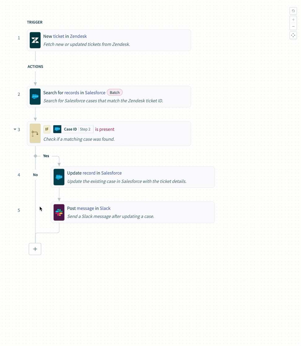

Your Sync Zendesk tickets to Salesforce and notify your team in Slack recipe is ready to test and implement.
Example recipe configuration.
Zendesk, Salesforce, and Slack recipeSync Zendesk tickets to Salesforce and notify your team in Slack recipe
