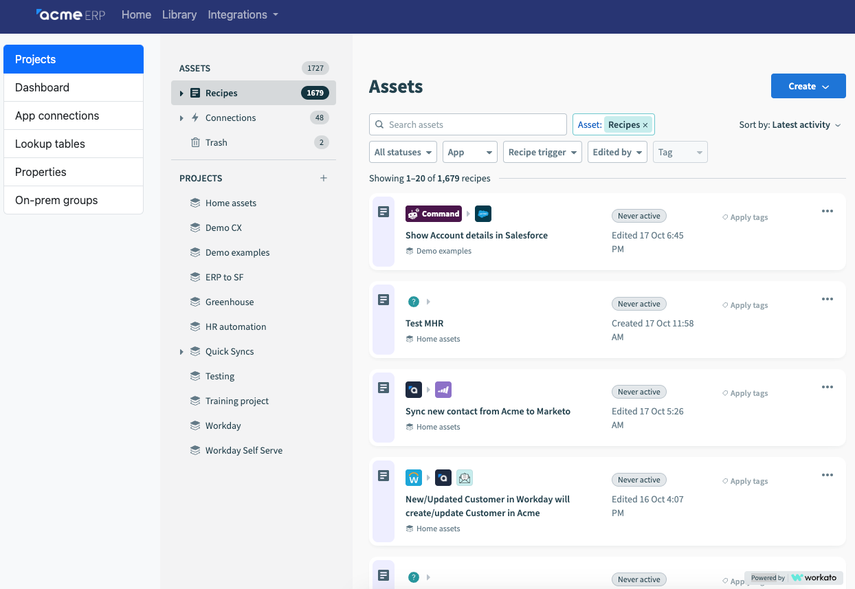

Full page iframes
Full page iframes enable you to embed any Workato page by specifying a direct URL path to the desired page within the iframe. This method enables you to display the page's content without the Workato navigation bar.
Full page iframe of Workato’s Projects page within Acme ERPFull page iframe of Workato’s Projects page within Acme ERP

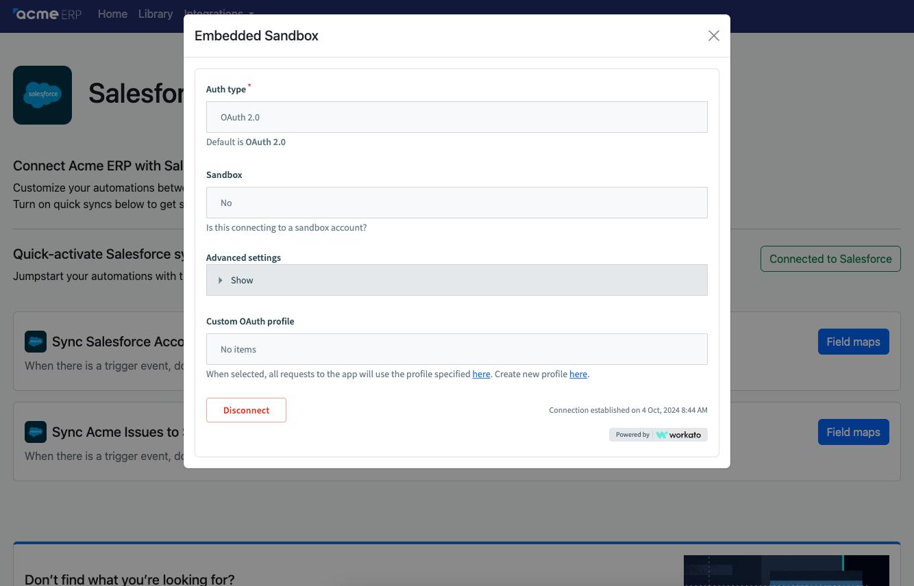

Connection widget
The connection widget allows you to securely collect credentials from your customers for any Workato connector directly within your product. Use this widget as part of a Managed Services offering or within a larger integration setup journey on your platform.
Connection widget of Salesforce connector within Acme ERPConnection widget of Salesforce connector within Acme ERP

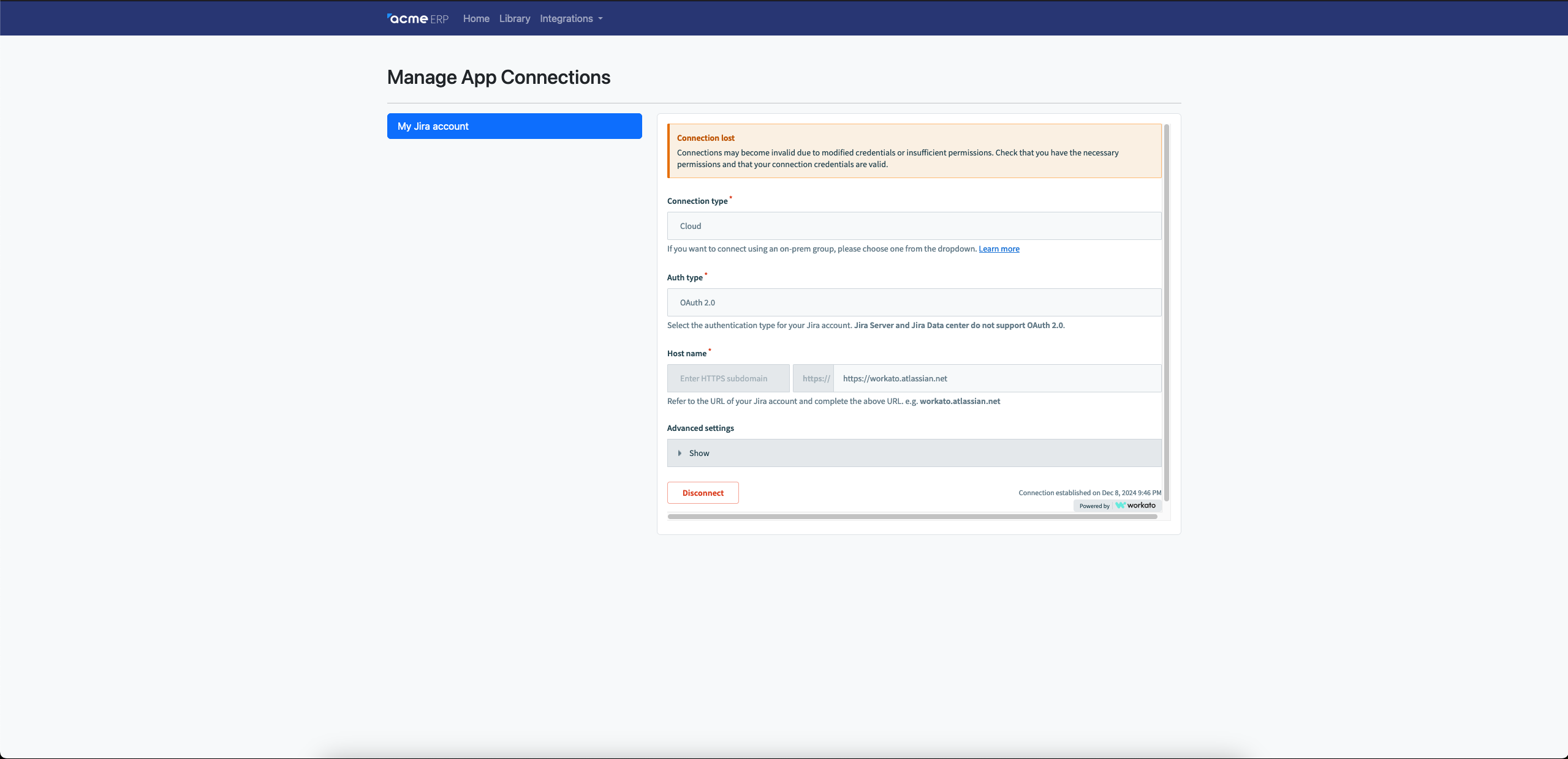

Error notifications in the connection widget
The connection widget displays the following notifications when specific issues occur:
  • Connection lost
  • Appears when the connection becomes invalid due to modified credentials or insufficient permissions. Ensure that you have the necessary permissions and verify your connection credentials.
    Connection lostConnection lost

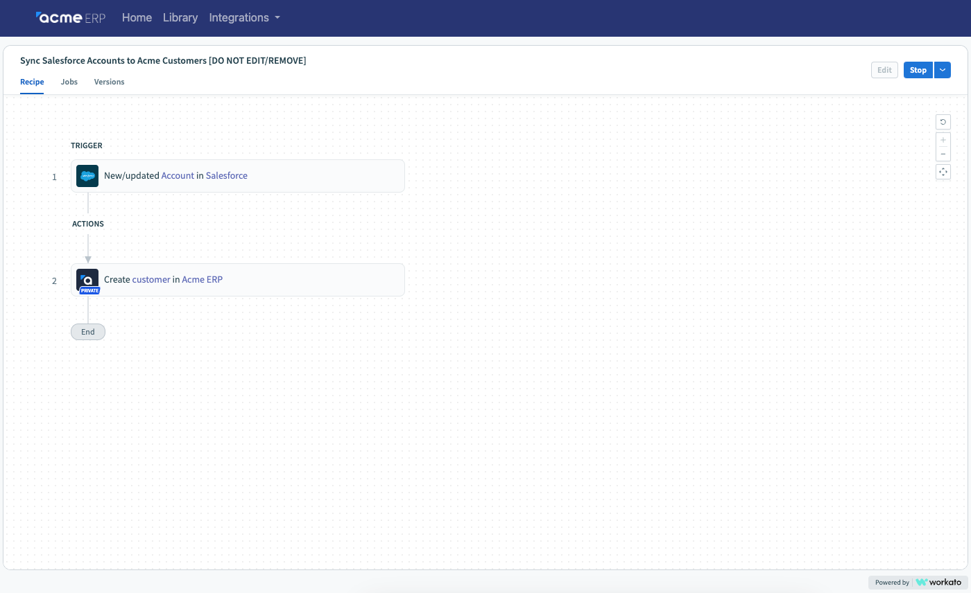

Recipe widget
The recipe widget enables you to embed a focused, streamlined view of an individual recipe page. This widget removes non-essential elements such as top navigation and side panels while preserving the core tabs for recipes, jobs, and versions, delivering a seamless build experience within your application.
Recipe widget of individual recipe within Acme ERPRecipe widget of individual recipe within Acme ERP

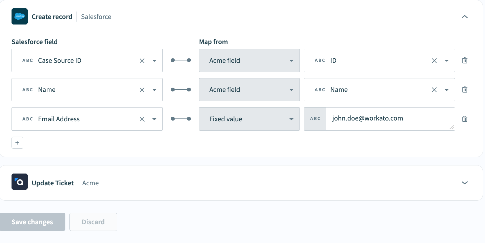

Dynamic field mapping widget
The dynamic field mapping feature lets you map fields from source systems to a destination step in a recipe without modifications to the core recipe logic. This widget provides a structured interface to manage field relationships inside embedded integrations.
Dynamic field mapping widget in Acme ERPDynamic field mapping widget in Acme ERP
