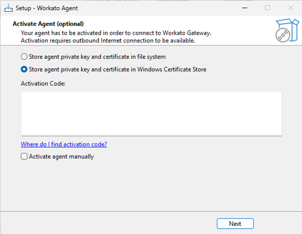

Select whether to store the agent private key and certificate in the default Windows Certificate Store location or in C:\Program Files\Workato Agent\conf. You must protect the conf folder from unauthorized access if you select this option as your storage location.
This option is only available in OPA versions 30.0 and later. Refer to the Security section for more information.
Choose where to store OPA key and certificateChoose where to store OPA key and certificate
